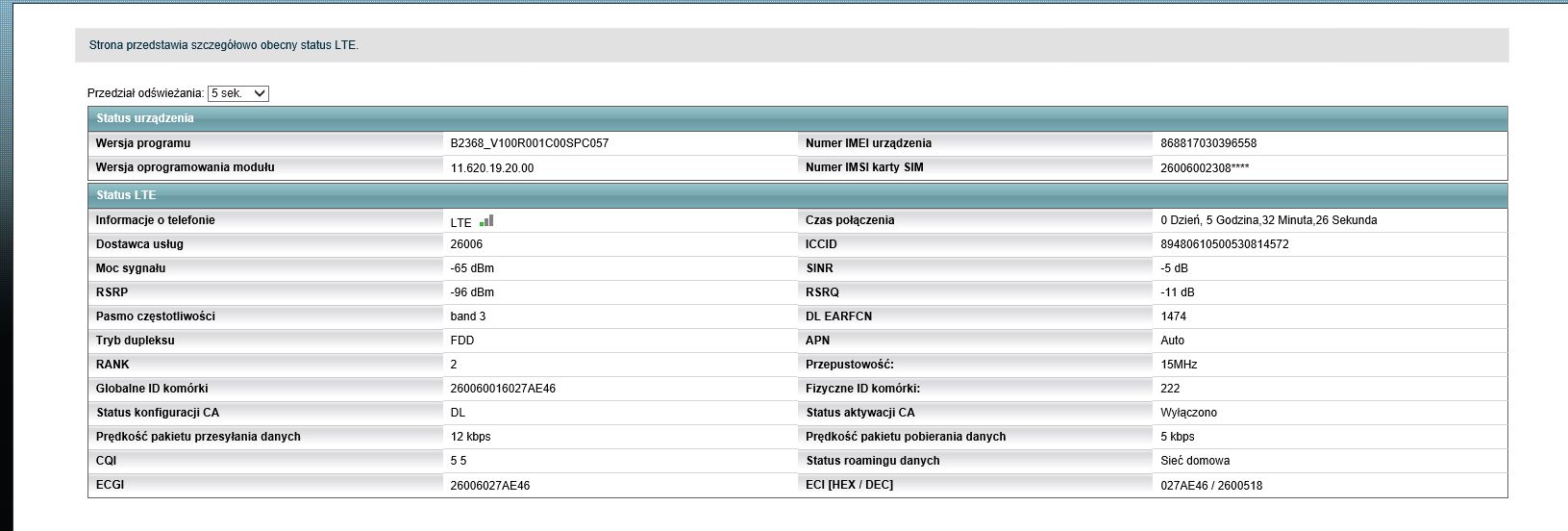

    hello, screen from the B2368-66 interface. extended in the annex, location Kleszczów voivodeship Lesser Poland

    Very strange CID, it's LTE1100, band aggregation doesn't work. Signal satisfactory. BTS probably Leśna 69 in Zabierzów if it works or Rudawa but this CID is strange.

    why strange How to find out which BTS? need to translate sim to phone? I have this program network cell info but it only shows me the bts t-mobile that I have in my phone. I am closer to BTS in Aleksandrowice, do you think that if I would set up a directional antenna for it, it would be better?

    Strange because B2368 does not provide eNBID or CID in some simple decoded form and it is difficult to determine which mast we are connecting to, especially since it has an omnidirectional antenna and can connect to "anything". I take it this way that I make a round around the surrounding masts and check what PCIs are on them (number of sectors) and based on the PCI indications (Physical Cell ID - PCI) from the LTE Status panel on B2368 I define the BTS with -em link.
    If I were you, I would have listened to my mothers friend and took a ZTE WF830. B2368 is good in the city (and not like Play suggests in the countryside where directional antennas are the basis). I own B2368 and I convert it into directional antennas, but if you don't own it, you won't do it.
