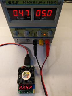

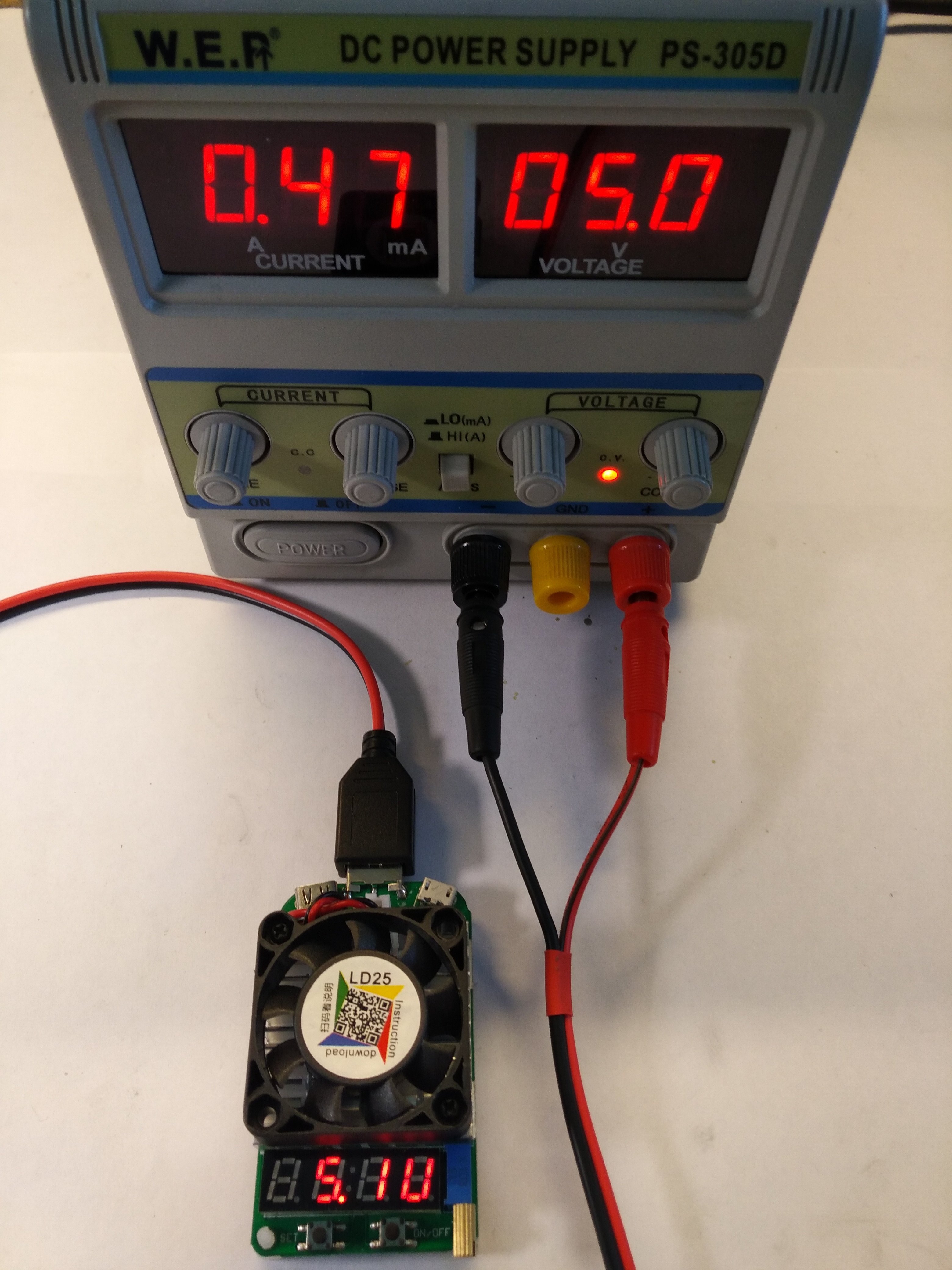

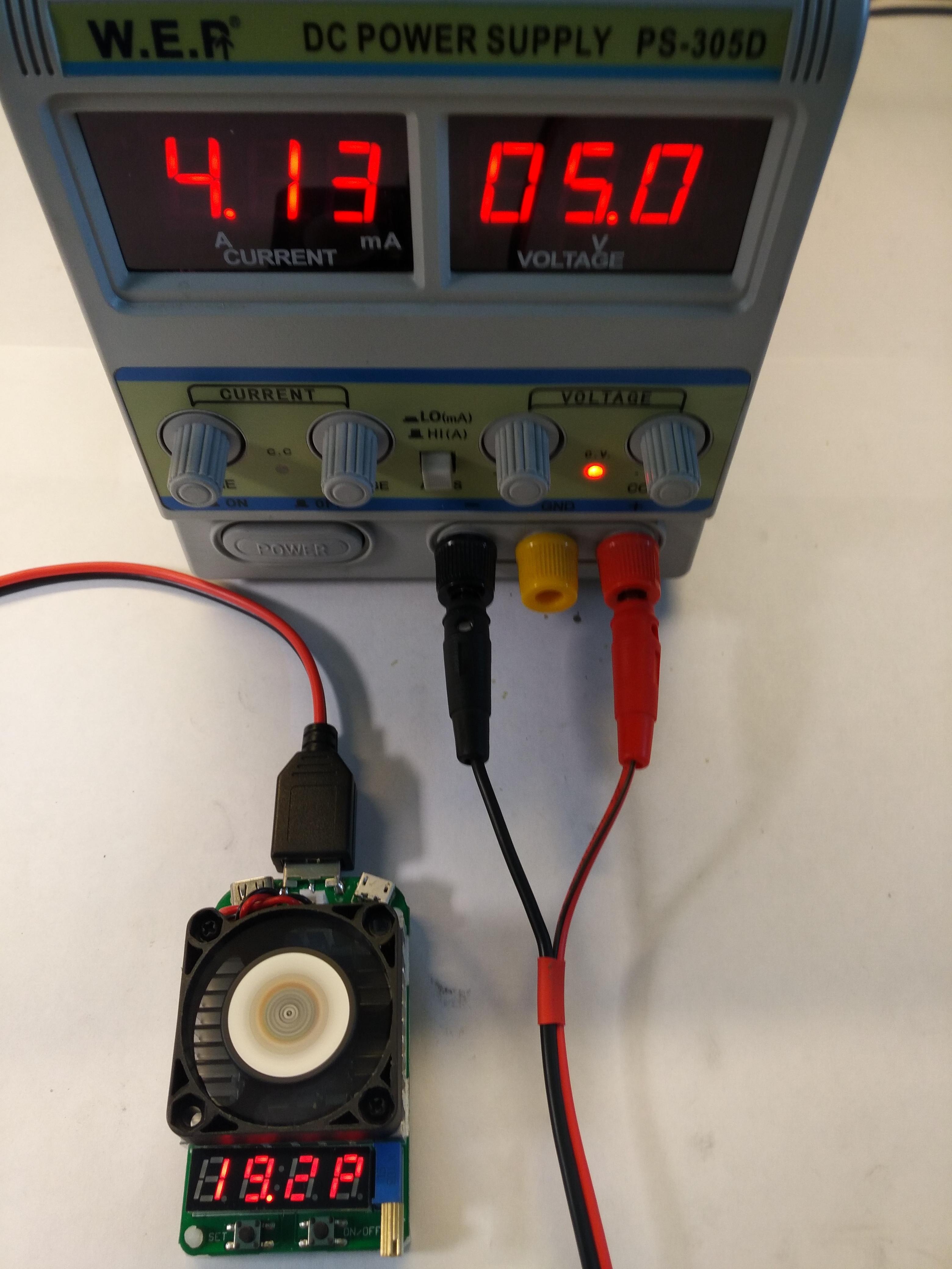

    The load is set to 0.2A, the rest can be seen in the pictures. "A" is of course amps. "U" is the actual voltage. "P" is the currently consumed power.
    Small, simple, artificial load LD25; 4V-25V - made in china - Test / Review Small, simple, artificial load LD25; 4V-25V - made in china - Test / Review Small, simple, artificial load LD25; 4V-25V - made in china - Test / Review
    Here we already have half an Ampere.

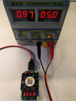

    We turn the knob and we have one Amper.
    We roll on and come to two amps.

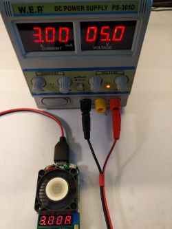

    And then further potentiometer, keep turning ... We've already dialed three amps. It's already "a piece of electricity"

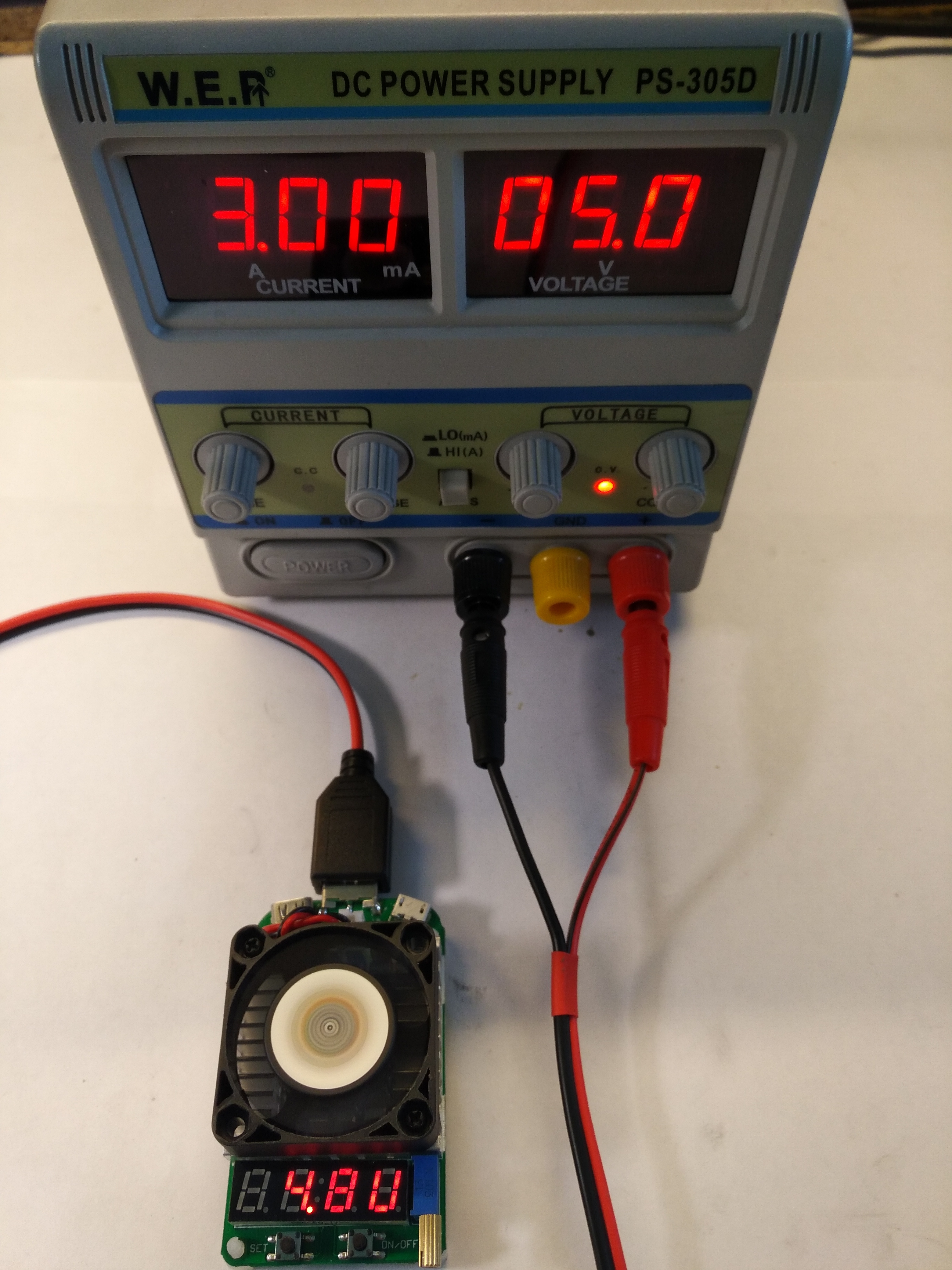

    Like me, I hate multi-turn precision potentiometers. Managed to tighten to four Amps. And the device still works, it burns a little, but it doesn't smoke :)
    I've come to the end of the scale :( . So actually more than four amps, this will not "jerk", but what more to expect from one TIP122 transistor.
    I didn't test for voltages higher than 5V because as I mentioned I ended up reading the manual instead of starting there. I also don't have any charger with a "real" USB 3.1 ( @gulson maybe you will think something about it, after all, I already have something to check :D ) so the only tests I can run are the ones with the power supply I used today.

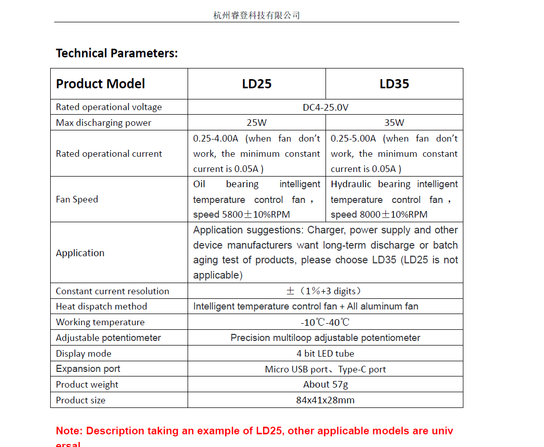

    It is true that the instructions are attached, but in order not to waste your precious points, Here I will quote the most important technical parameters:
    It turns out that PDF has some security. So I am throwing you screenshots:

    Interesting device, do I conclude correctly that it works only in the power supply testing mode?
    One of the previous artificial loads that a colleague presented (60W, I think) had two operating modes: testing power supplies and batteries.
    And it is the latter mode that would be perfect for testing the capacity of, for example, Powerbanks.
    You reason well.

    I don't have a gadget with me, and tomorrow at work I have a lot of work to do and I don't know if I will have time to check it out.
    As for the amplifiers, the photos show two LM358s, just open the full size. I always try to take photos so that the key elements are visible in the original size.
