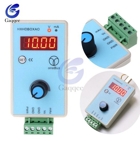

    Let's move on to the presentation of the described gadget. At the beginning, a standard photo from the auction:
    Current source, 4-20mA Signal Generator - Test / Review / Opis
    As you can see, it costs a lot, about twenty three zlotys, but you should add seven zlotys for shipping.
    If they all have repeatable parameters and hold them like my copy, I can already say that if this gadget goes to the store, it will come off like hot cakes.

    I must admit that I was very positively surprised by the results of the measurements. The test was performed with a Sanwa multimeter, which you have already seen while reviewing the reference voltage. So you know that there is a fairly accurate device, with a slightly higher than average shelf.
    Okay, I won't keep you in suspense anymore, you finally have the photographic material you want, because one image will convey more than a thousand words :)
    Current source, 4-20mA Signal Generator - Test / Review / Opis Current source, 4-20mA Signal Generator - Test / Review / Opis
    This is how this gadget looks like. The panel casing begs to be mounted as an accessory, for example in a laboratory power supply.

    Only now did I understand that this system acts as an active load, forcing a current of a given intensity.
    At first I was confused by the first part of its name: "4-20mA Signal Generator ..." and I thought it was a kind of current source.

    Nice equipment, although serial power has its drawbacks. After disconnecting from the target tested element (e.g. diode), the power is turned off and everything resets.
    What does "reaching" the set current look like? Are there any overshoots?

    mkpl wrote:
    power goes out and everything resets
    If you remember the setting by pressing the pulse generator knob, then after a power failure, the value will be the same as before.
