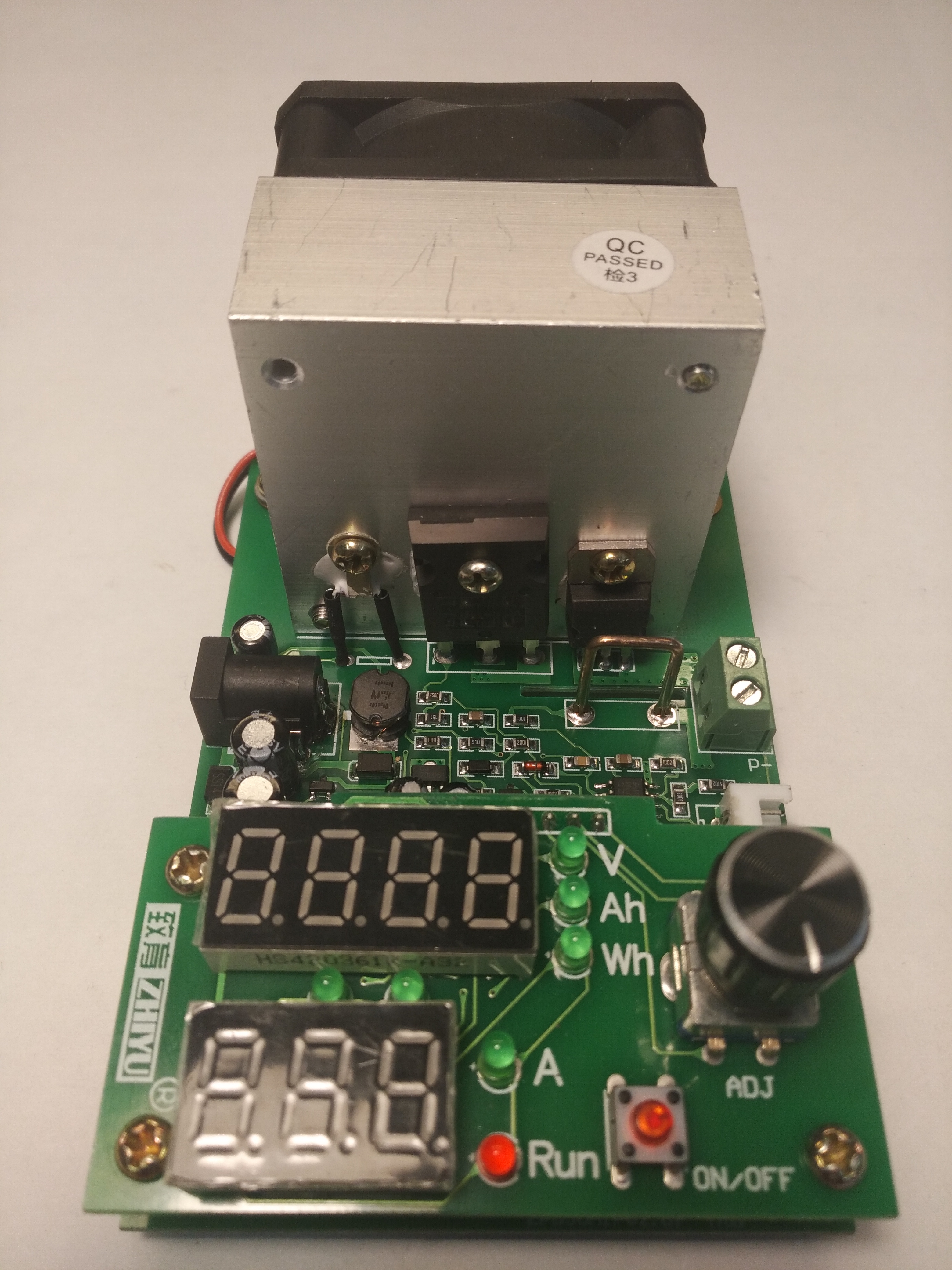

    We get something like this from a Chinese:
    Artificial load 1.0V - 30V 0.01A - 9.99A. Max. 60W R06 - China - review Artificial load 1.0V - 30V 0.01A - 9.99A. Max. 60W R06 - China - review

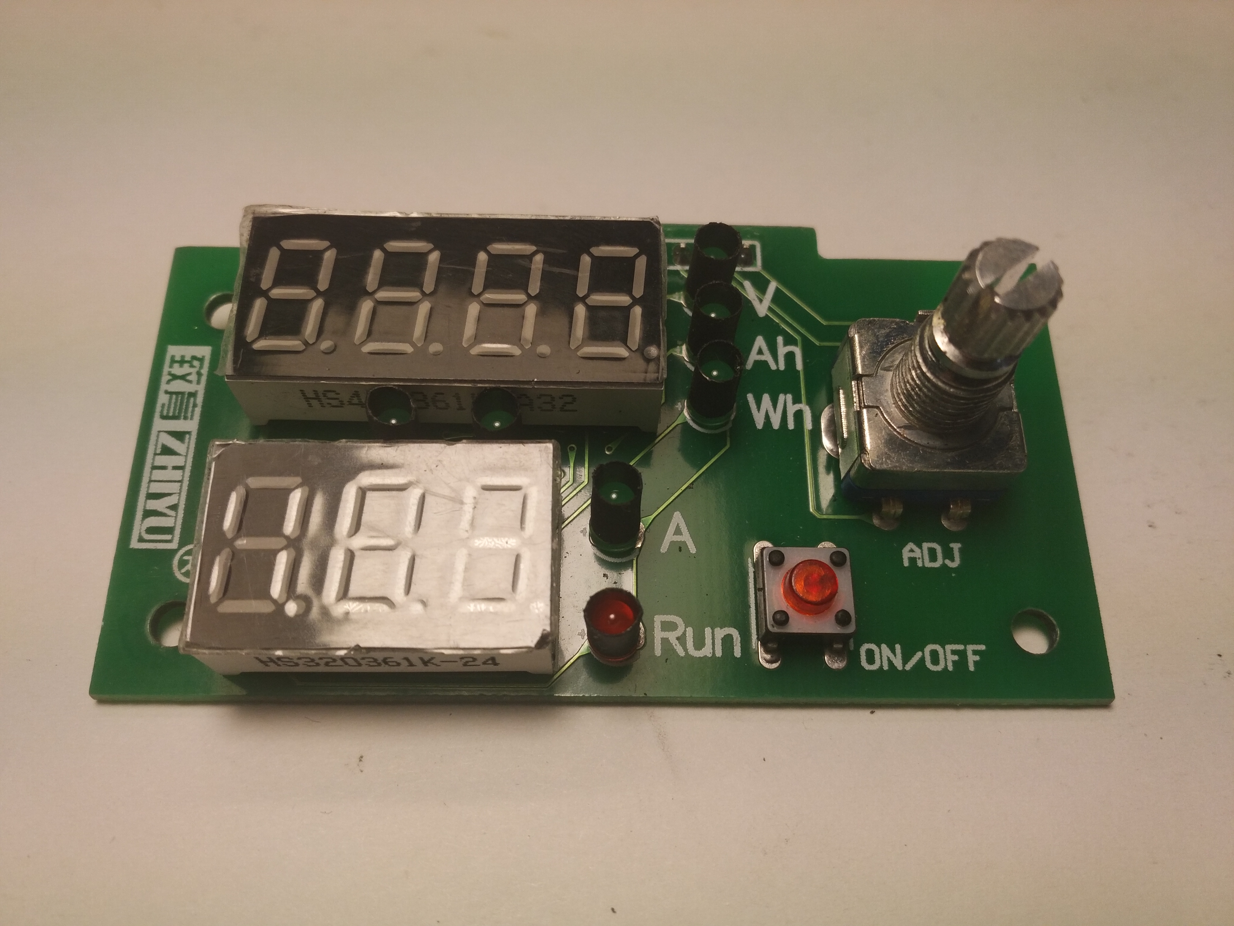

    We can break it down into two modules:

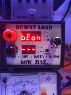

    I will say something else about these modes. Well, if we connect the power while holding the On / Off button, something like this will appear on the display:
    Now we can choose the pulser between 1 and 2.
    Then confirm with the On / Off button (not by clicking the pulser).
    Now an option will appear:
    which can be set to
    and confirm again with the On / Off button.
    The second option is translated into our BeOn / BeOF> Beeper On / Beeper Off, i.e. turning the annoying buzzer / beeper on and off, or whatever you call it. However, in some situations such a beep may be helpful.

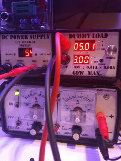

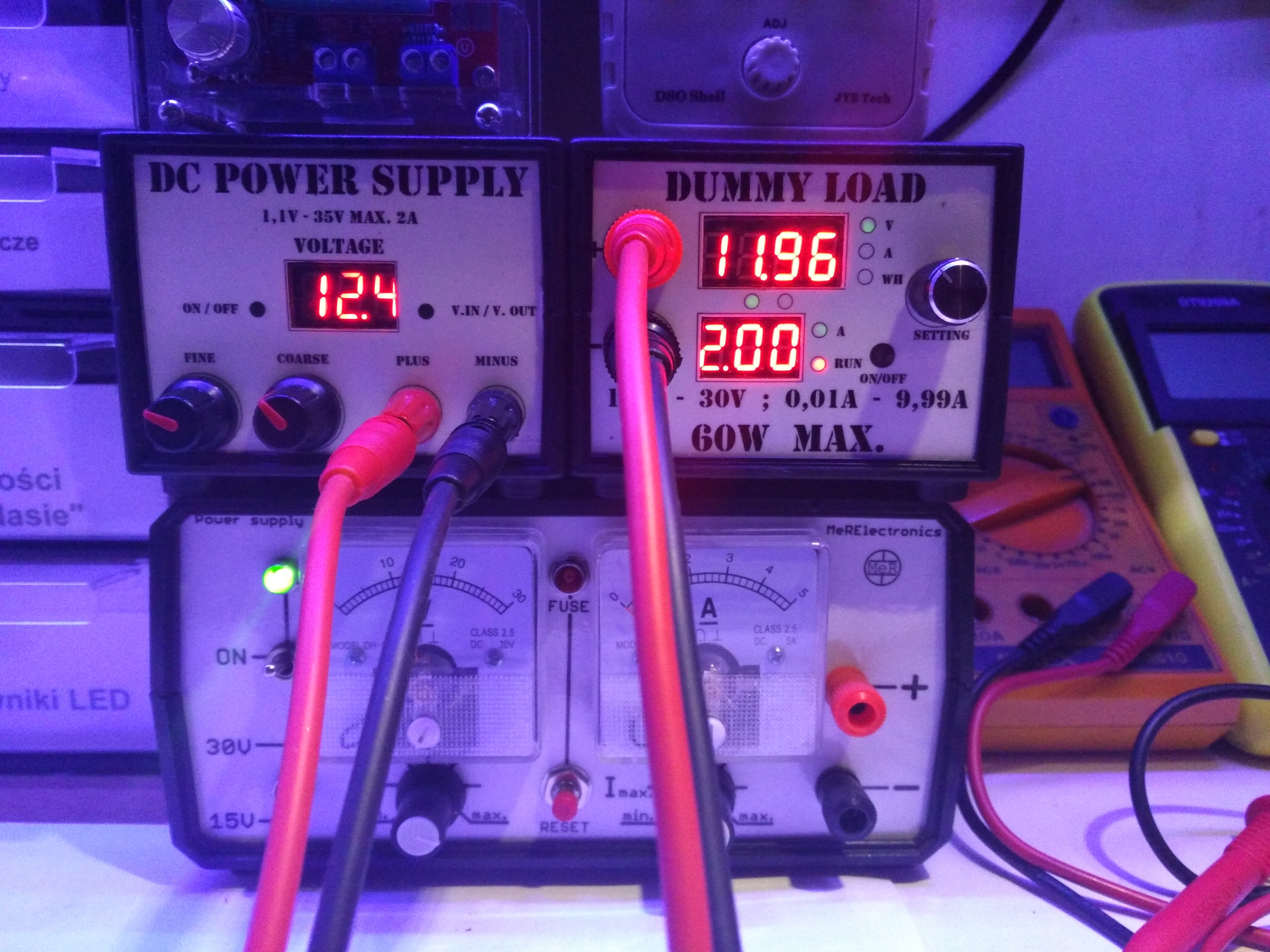

    In the pictures we can see the power supply as a battery, but I have already tested over 60 pieces of 18650 with this equipment and a dozen or so other batteries and I must honestly say that it is a great device. And everyone should have one in their workshop.

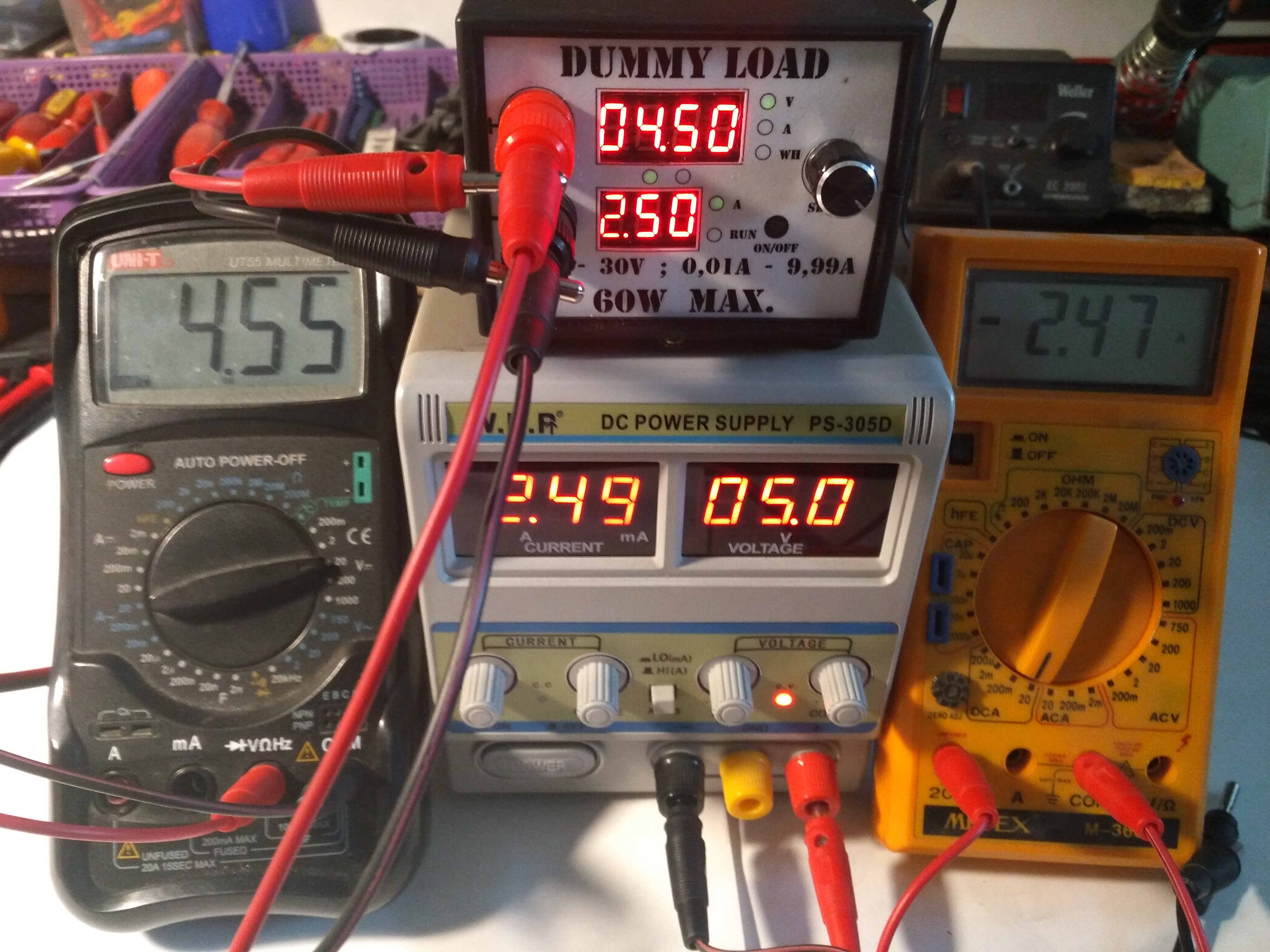

    One of the users pointed out to me that some tests would be needed to compare the voltmeter and ammeter readings with external measuring devices. So I took a few more photos.
    This time, the well-known and popular PS-305D, branded by the WEP company, played the role of the power supply.

    I also bought such a load once.
    In my case, the Chinese installed a bad thermistor on the heat sink (10k instead of 50k) and the fan control did not work as it should.
    I replaced the thermistor with a 47k (that's what I had) and replaced the heat sink with a larger one. Now it works very quietly.
    Schematic found on the network:

    How about the accuracy of the current and voltage measurement?

    I added some photos to the first post. You can see how the current and voltage measurements behave.

    Measurements look ok, one could work on eliminating the voltage drop on the connections but generally acceptable. Thanks for the measurements.

    Do you know what the small, white connector on the board is for?
  • #20 17022390
    CMS
    Posts: 8468
    Help: 258
    Rate: 2601
    I have no idea. I was wondering about that too, but I don't care so much about this information as to pursue the topic.

    viaxa wrote:
    Quotation:
    For connecting a voltmeter.
    I think it was intended as a voltage input for a four-wire measurement. In the lower left corner of the diagram, you can see that it is connected to a differential amplifier with a gain less than 1.
    Four-lead measurement is a useful function when, for example, the capacity of a battery loaded with high current is measured. In this way, error in measuring the source voltage is avoided, because voltage drops on the conductors need not be taken into account.
    The question is, does this feature work? Because I read somewhere that no ...
