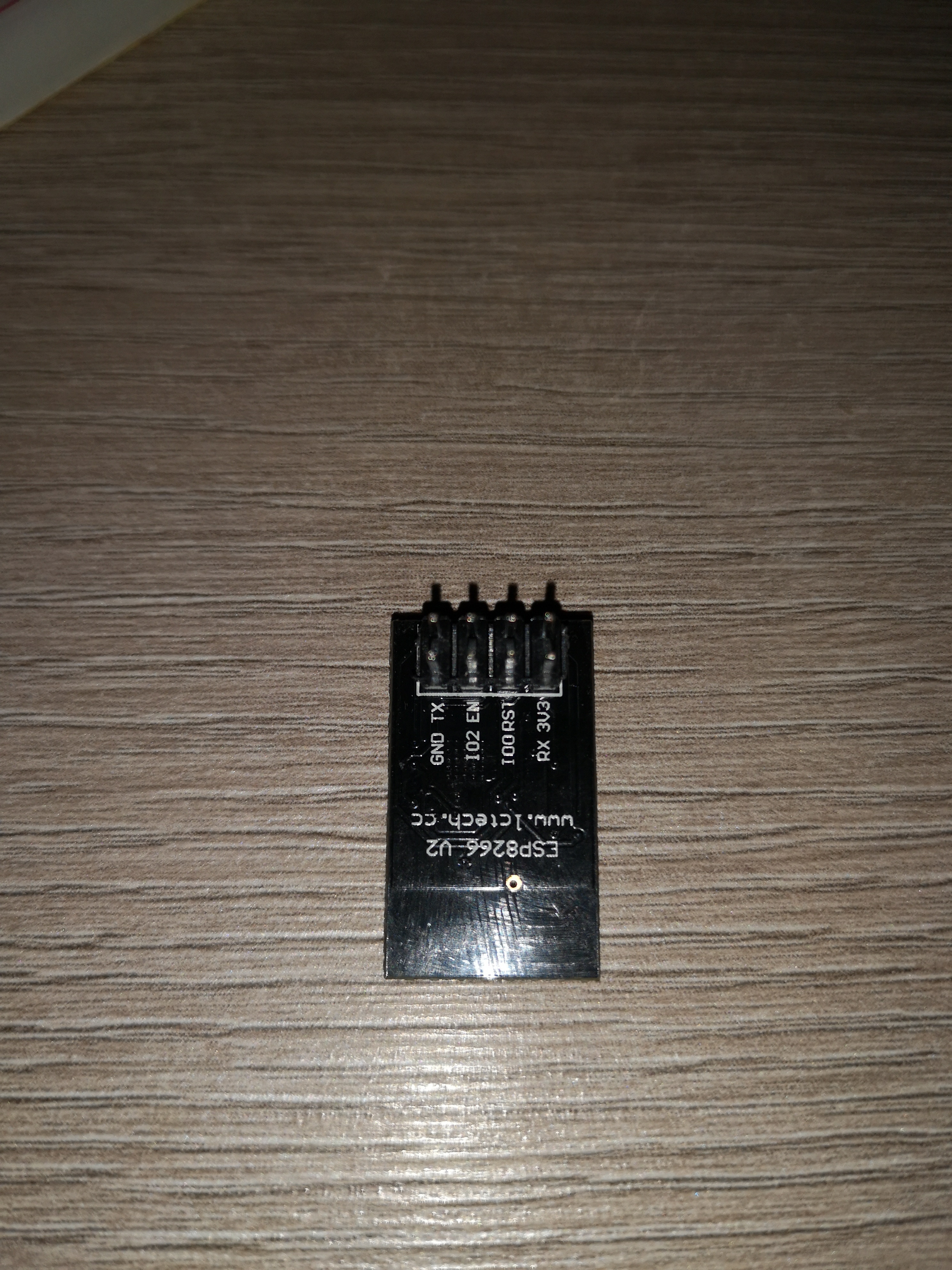

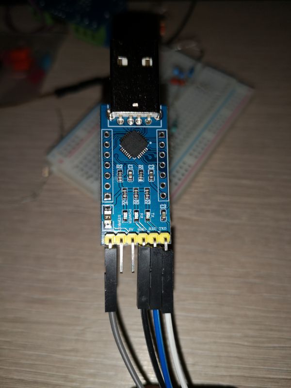

    Tx to Tx rx to rx 3.3v and GND.

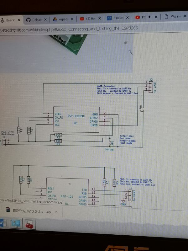

    I found something like this How do I change the IP in Domoticz on Windows 7 for access from other devices? .
    Maybe I can give resistors like here?

    I don't know what's going on still the same thing....
    Added after 1 [hour] 46 [minutes]:
    Successful. Had to make 2 valves between the pins. I will also describe this in the tutorial because I buried it on a Russian forum.

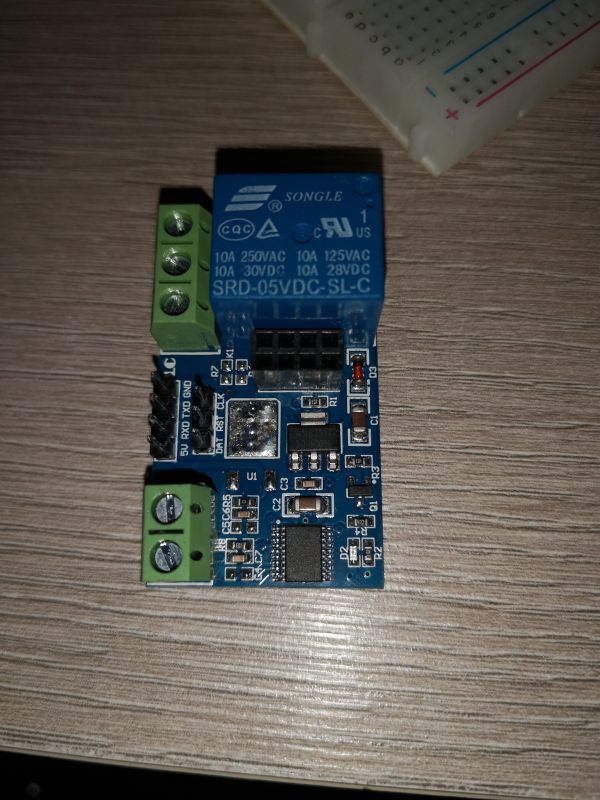

    I plugged in and zFlashed the ESP. I put in the relay and it does not switch it on. I checked with a meter and when I pressed the switch in Domoticz, 3v of voltage appears on the GND and Gpio 0 pins. But the relay does not respond.
    Have you ever had this problem?

    Esp has 3.3V logic, everything is ok. I hope you didn't connect the relay directly to the pin.
    Here you have e.g. a wiring diagram for the relay http://nettemp.pl/forum/viewtopic.php?p=2670#p2670 , admittedly the diagram shows a raspberry, but you connect to the esp identically.
    Best regards
  • #36 17651415
    mateusz196
    Posts: 30
    Not under pin. I have as above in the picture you can see a relay with a place for ESP but it doesn't work I programmed 2 pins of Gpio and still the same. I'm going to buy a Wemos and some relays because I'm already getting nervous.

    It depends on the logic of the relay, you can go either way. In the example as above, the relay is switched on with the high state, which does not mean that the output circuit will be closed because relays usually have the possibility of NO and NC operation, it all depends on the connection. With an NPN transistor (as above) and connecting the circuit to the NO contacts, it will be switched on with the HIGH state.

    Is it possible to do something with my relay? I only feel sorry for the money, because it was bought on one of the Polish auction sites and did not cost 3.6 PLN but 36 PLN....
    It was supposed to be a learning tool, but it turned out like this.
    I use the esp meter to check and it shows 3v when switched on. I supply the relay with 5v to the contacts.,I put the esp in the gold pin connector where it belongs,,but the relay does not respond. Can I somehow unsolder it to bypass these circuits what are with the relay on the board? As for the transistor I can't buy it anywhere right now.... Any ideas why it won't move?
    If I touch to the relay from underneath the 5v turns on and the diode also.
