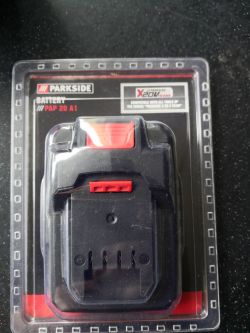

    RAI3
    Hello, I bought this equipment some time ago, so far we will see what's next ... But we have a question about the battery, will the one in the photo fit? Has anyone tried? Parkside Performance PABSP 20-Li A1 Drill Driver: Assessing 60 NM Torque, 13mm Handle & Value

    bikerds
    Posts: 26
    Rate: 39
    It will not fit.
