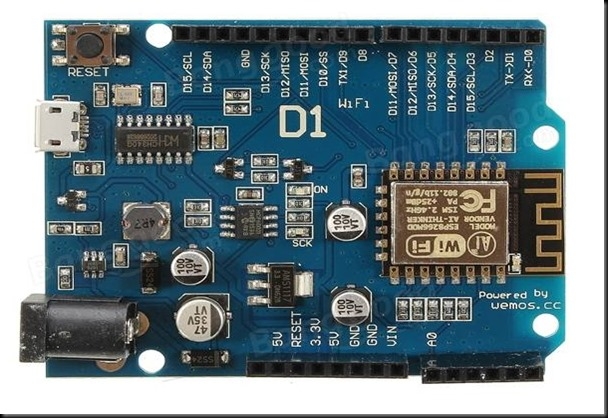

    I have a Wemos D1 board in this version:
    ESP8266+Eclipse+MinGW+SDK Mikhail Grigoriev''a = LED blink not working .
    I installed the environment according to this guide: http://www.bot4u.pl/arm/kilka-slow-o-esp8266-w-jezyku-c/
    From the examples installed from the SDK, I chose the basic Blink:

    I check the status of pin D2 - unfortunately a continuous high state.
    Have I missed something?

    Pin D2 (according to the Arduino description) is GPIO4. By defining the pin number, you define the ESP8266 pin. The best way is to print yourself a table: https://wiki.wemos.cc/products:d1:d1 and see which Arduino pin (the one with the letter D) corresponds to the ESP pin. The way you wrote it down you should have a user LED flashing.

    I have the D1 R1 version:
    I have tried on GPIO2 (D9), GPIO4 (D14). No result - I even check with an oscilloscope.
    When I tried to set the GPIO16 (D2) pin:
    Code: C / C++
    this gave an error of no definition of these labels.
    So I checked what the definitions were in the eagle_soc.h header:
    Code: C / C++
    So I looked into the ESP8266 documentation:
    And here's the conundrum - the register addresses are different.
    In the eagle_soc.h header:
    Code: C / C++
    The start of the addresses is different 0x60000800 vs 0x60000300
    additionally for GPIO2 the offset is 0x38 accordingly and in the documentation 0x30.
    As a result, the GPIO2 register address is:
    - 0x60000838 (according to eagle_soc.h header)
    - 0x60000330 (according to the documentation)
    and hence there is a problem. But why? Maybe I installed something wrong or somewhere I should select/enable an option?
