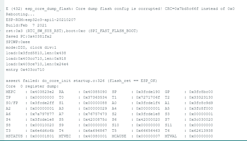

    I have a module bought on Allegro which has an ESP32-C3 chip, 4MB (32Mb) flash memory, USB C socket with USB - UART converter, two LEDs and two RST and BOOT buttons built in. Here is the Chinese website for this module with information about it: https://wiki.luatos.com/chips/esp32c3/board.html
    I have Arduino 2.0 installed, in the board manager I installed the ESP32 package. I selected "ESP32C3 Dev Module" from the list of available boards. I wanted to upload a simple program that flashes the D4 diode (GPIO12). I have the settings in Arduino as follows:
    LUATOS ESP32C3 Board - Issues Flashing D4 LED with Arduino 2.0
    I compile and upload the code, I have no errors. It's just that I don't flash the D4 diode, and in the terminal I get something like this:
    As if something else was uploaded? What is it about? Apparently my program uploaded via UART.

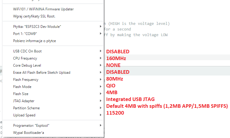

    Arduino settings correct.
    The only thing to question is the JTAG Adapter.
    Show what program you uploaded (or where you downloaded it from).

    What is displayed in the terminal is a kind of ESP32 business card , this is how I have at least on the boards I have , this happens after every reset .
    The LED does not flash because if I remember correctly it is connected to GPIO2 (pin 2).

    It is not clear if the author has this one in mind. In addition, the processor detects the error: "flash config is corrupted".

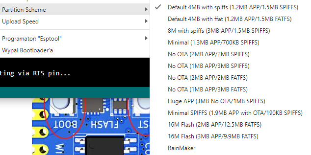

    I managed to upload the program correctly. I found on some Chinese forum that for a similar board in Arduino settings Flash Mode -> DIO must be selected. I had QIO changed to DIO and after uploading the program the LED flashes :)
    By the way. Someone is able to explain to me what this setting is all about? With this Partition Scheme
    What is being set here?

    Ok, only from what I understand, it comes out that I can't use the whole 4MB for program code? At least I don't see a setting that would allow this, they all have APP and SPIFFS shared.

    The entire 4MB will not be given to you because there is still software such as wifi, tcp, etc. sitting around.

    Well ok, but if I were to swap the Flash memory for a larger one e.g. 16MB (128Mb) then as far as I can see I only have a choice of two settings for that memory and the largest one only gives me 3MB for APP memory (i.e. I understand my code?) and 9.9MB for FATFS. And seriously more can't be allocated for program memory?
