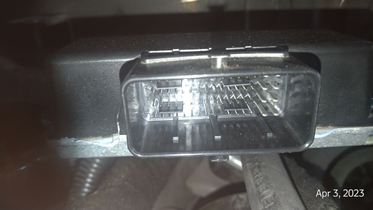

    BRC SEQUENT 32 Calibration Tool - Seeking Program for Controller Settings Adjustment
    Gentlemen, what program will this driver run? Sequential Fast?
  • #33 20524640
    claypton
    Posts: 58
    Rate: 17
    Try plug & drive
  • #34 20524653
    mirekshadow
    Posts: 37
    Rate: 18
    BRC SEQUENT 32 Calibration Tool - Seeking Program for Controller Settings Adjustment The calibrating tool will not start
    P&D won't start
    Sequent Fast will not start
    All of them, of course, will show the ECU data and, if necessary, will allow you to reset the LPG engine start counter
    This is the FLY SF control panel in a "newer" package, a different socket

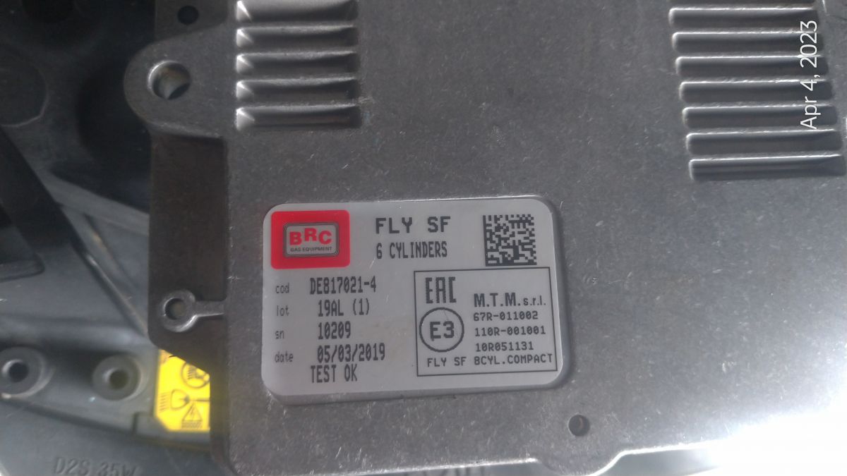

  • #36 20524753
    mirekshadow
    Posts: 37
    Rate: 18
    >>20516501
    Software version S64AA103021D04 is needed. Unfortunately, none of the programs available on the web has this file and this is the problem, not the software. You need to get the file with this S64AA103021D04. Only asking from where?
    Added after 1 [minute]:
    This is the Sequent 64 control panel and you need the S64AA103021D04 software file to be able to program
  • #37 20534845
    mirekshadow
    Posts: 37
    Rate: 18
    >>20516258
    Ok, I updated the Calibration Tool software and everything is fine. Thanks
