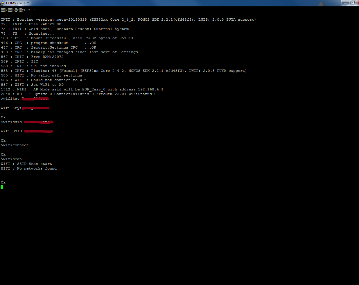

    Since you have connected via UART then you can try connecting to your wifi network via Putty.
    wifikey twojssid
    wifissid twojssid
    wificonnect
  • #8 17944639

    Mate you were right it went. hmmmm.... only what next popped up 3xstatus OK, but on the router there is no new device connected
    I typed in
    wifiscan
    but the module cannot find the network
    and I made the hotspot available on my phone, put it next to me and it won't find the network either

    And what was displayed on the terminal?
    It should display, among other things, information about the success of the connection and the IP received.

    Maybe there is a problem with the signal, that it didn't connect to the router. Also strange that I shared the net from the phone I put next to the module and the ESP didn't find any net
    ESP8266 from different batches - one works, the other does not detect the network .

    Well strange unless that network you shared is a 5GHz network.
    Looks like there is a problem with the wifi on your modules

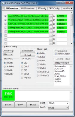

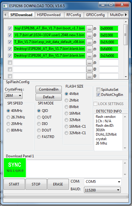

    khoam wrote:
    There are 4 files and they have the following offsets:
    Code: HTML, XML
    something like this?

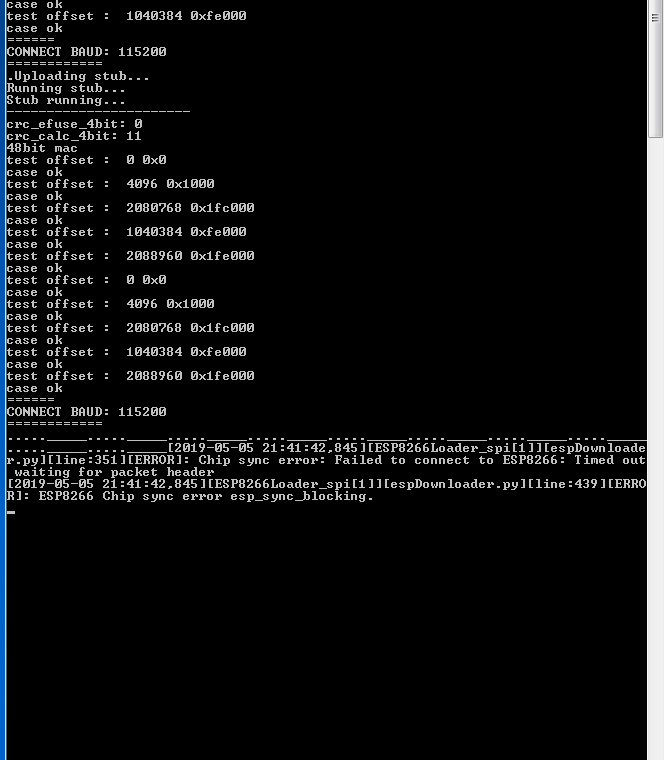

    unfortunately error

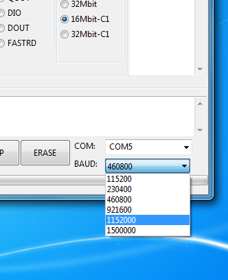

    Switch to 9600.
    uploaded
