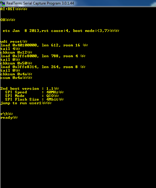

    khoam wrote:
    demsy wrote:

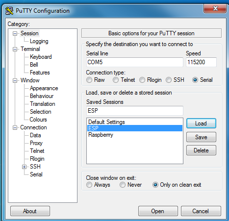

    It's just that now it doesn't want to "talk" to me with putty.
    Do you have the speed set to 9600 in putty?
    115200. but I won't be acting further until tomorrow

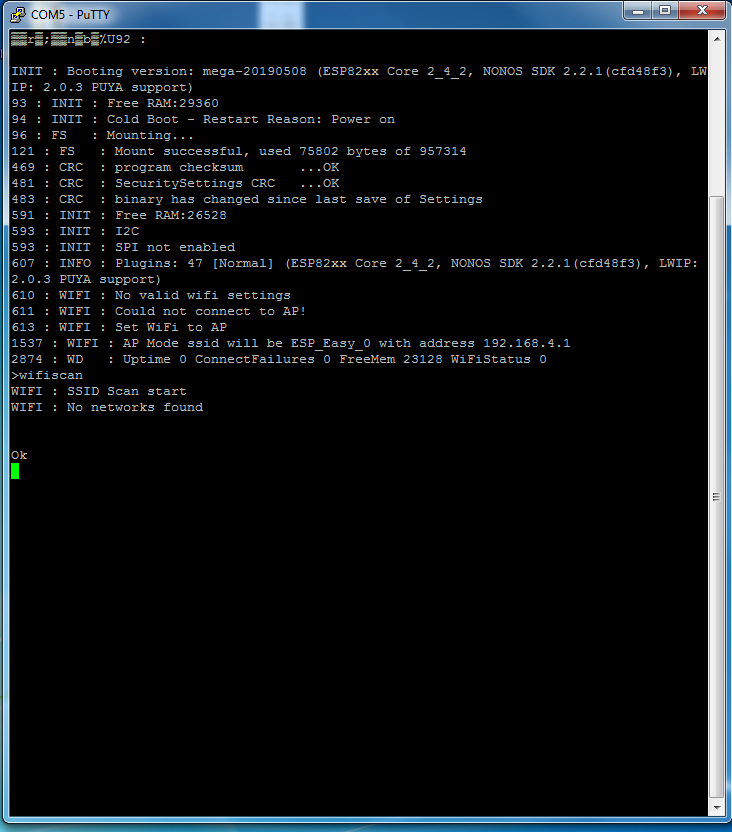

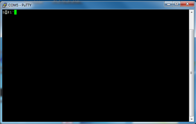

    uploaded again
    Code: HTML, XML
    ESP8266 from different batches - one works, the other does not detect the network .
    with speed 115200
    to test pytty to see if it works i shorted RX and TX for a test so it works, in other words i suspect i have uploaded something wrong to esp
    I have also connected a fresh ESP.... and there is the same effect

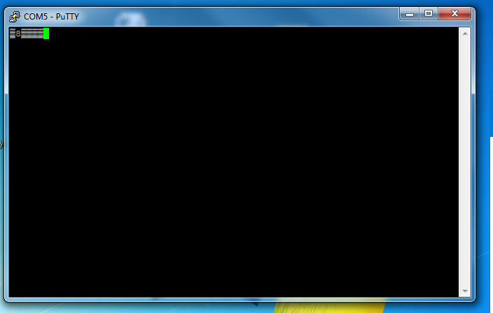

  • #34 17946878
  • #35 17946884
    demsy
    Level 22  
    Posts: 887
    Help: 17
    Rate: 178
    same effect

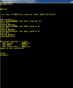

    I was able to upload a soft that works with AT commands

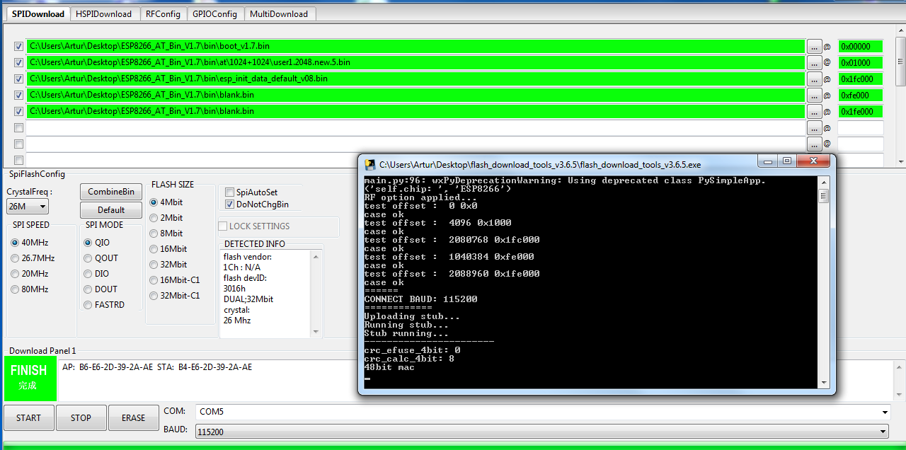

    demsy
    Level 22  
    Posts: 887
    Help: 17
    Rate: 178
    khoam wrote:

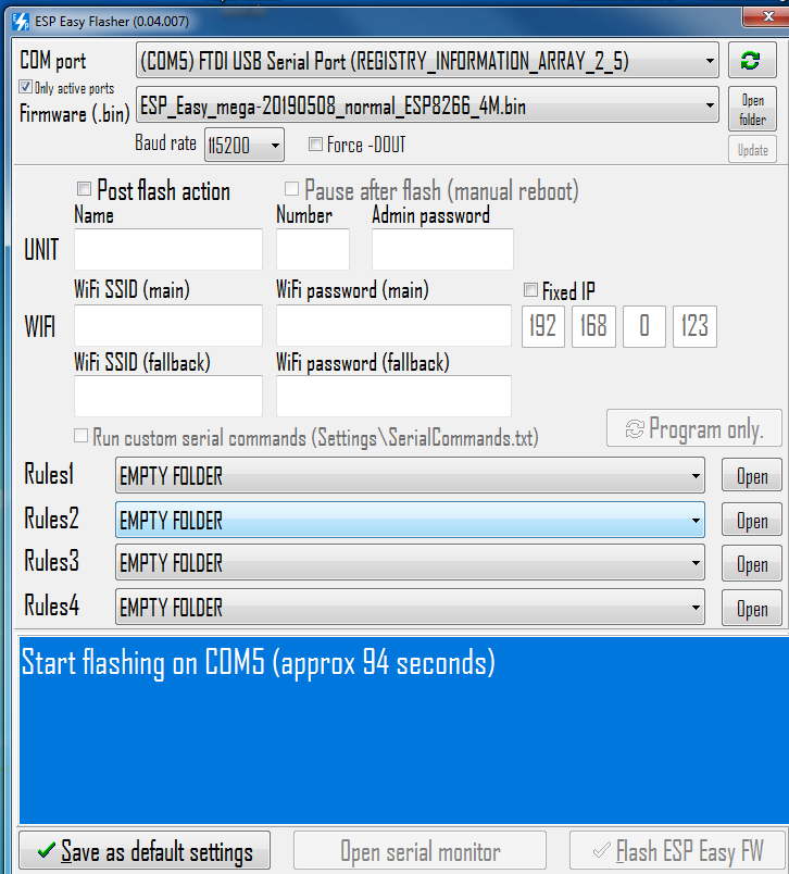

    I uploaded the soft of 25.04.2019 such as you wrote about in the first post.
    Specifically it is the file ESP_Easy_mega-20190425_normal_ESP8266_4M.bin .
    Appears to be OK :) .
    Code: Dos
    I then repeated the test with the file ESP_Easy_mega-20190425_normal_ESP8266_1M.bin , which is exactly what you wrote about in the first post. The result is also positive:
    Code: Dos
    ...and with which program do you upload?
    The same as before on this second sofet

    uploading version 4M

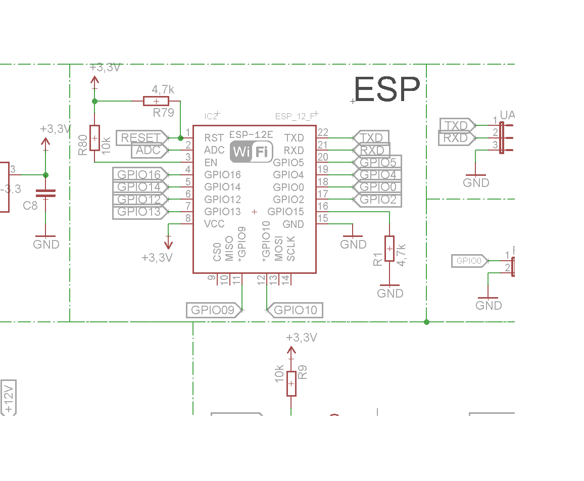

    One other thing I can think of is that maybe I have something wrongly connected
    Code: Lua
    Added after 4 [minutes]:
    My diagram

    -first I clear the memory before each program upload
    -then upload the program
    -enable putty
    -enter wifiscan
    -and I get no network

    khoam wrote:
    demsy wrote:
    One other thing I can think of is that maybe I have something wired wrong
    GPIO0 and GPIO2 should be connected via 10k resistors to the power supply.
    demsy wrote:
    -and I am popping up no network
    Specifically that it doesn't find the network, but the rest of the messages are OK, so it might as well be that those networks could be unreachable at that location.
    Can you see the ESP_Easy_0 network on a smartphone for example?
    They put resistors under GPIO0 and GPIO2 the chip does not want to program.
    From another supplier on this socket I have ESPs working

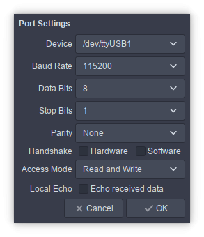

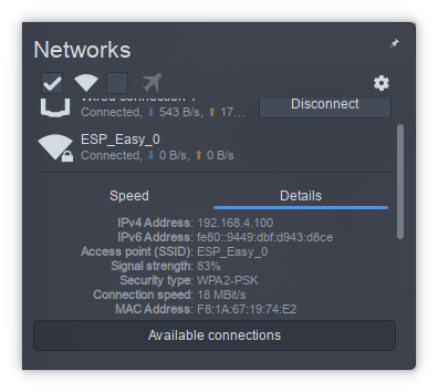

    I have just connected to one of your boards, with the distance between the computer and ESP being less than one metre:
    I have connected GPIO0 and GPIO2 in 3 different ways , together, separately and individually

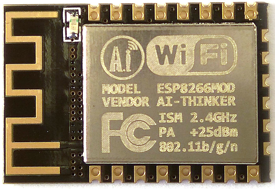

    khoam wrote:
    I have tested the three boards you provided me with.
    One of them, where there is no AI-THINKER logo but there is an Espressif logo works 100% correctly. It has the firmware ESP_Easy_mega-20190511_normal_ESP8266_4M.bin uploaded to it.
    In the other two with the AI-THINKER logo, I have not been able to get the WiFi interface to work so that the module scans WiFi networks or is visible, as an AP. In addition to the ESPEasy firmware (several different versions, including archived versions from 2015/16), I also tested with the ESPurna and Tasmota firmware. Without success. I then uploaded sample programs with Arduino HAL and ESP-IDF itself - also WiFi is not visible.
    Generally the modules behave as if they have no antenna hooked up. They don't report any errors with the WiFi stack, they just don't detect anything on the WiFi network and remain invisible themselves too.
    AI-THINKER stopped producing these modules over 3 years ago, so I don't know if these are clones or some stock "sweeps". I have found traces on several mailing lists of fake ESP-12 modules with the AI-THINKER logo and problems with SPIFFS support in these modules. Perhaps this is the case.
    In the picture below, the "hero" of the tests:
    So I thought there was something wrong with these modules,so I consider the topic closed,many thanks for your help on the topic especially to colleague "khoam".The modules you have you can keep them and I am the proverbial beer for you anyway. Once again many thanks. Greetings
