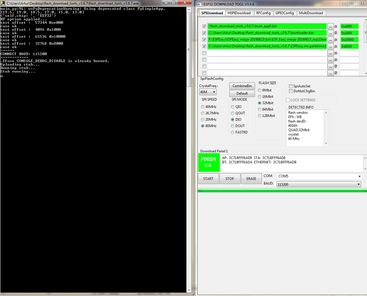

    I am trying to run ESPEasy_mega on ESP-WROOM-32
    The picture below shows the bin files and offset addresses( I may have messed something up)
    No new access point after uploading ESPEasy_mega to ESP-WROOM-32 .
    After uploading everything e.g. on the phone a new access point should appear but unfortunately I don't have anything, previously I was working on esp_12 and there was no problem

    demsy
    Level 22  
    Posts: 887
    Help: 17
    Rate: 178
    khoam wrote:
    I have uploaded ESPEasy32_R20100 to ESP-WROOM-32 and it is OK, with first cleaning all the flash . As I tried with the "uncleaned" flash, after uploading the code the ESP restarted over and over again due to SPIFFS read/write error.
    Code: Bash
    There is a visible network ESP_Easy0 .
    I uploaded the code with the command under Linux:
    Code: Bash
    It is the equivalent of the script flashSerial.cmd , which is in the ZIP package.
    Flash cleans up in the same way as esp8622?
    Added after 10 [minutes]:
    Code: Bash
    on me on win 7 does not work this script, it shuts down when it pops up to press any key, I press and the window closes

    khoam wrote:
    Eventually click ERASE in Download Tool ;)
    after cleaning I get the following every 500ms or so
    in the putty program it is the same
  • #8 18146575
  • #9 18146604

    khoam wrote:
    If these messages appear immediately after cleaning, it is OK. Now upload the ESPEasy firmware.
    ok, after uploading via flash dowloader I have something like this
    maybe I have the offsets set wrong

    demsy
    Level 22  
    Posts: 887
    Help: 17
    Rate: 178
    From the beginning
    I open the application flash download tools .
    I click ERASE(I'm surprised one more thing that this cleanup is over so quickly)
    After cleaning the readout with Putty with the flesh download disabled....
    close putty and reopen flash.....
    set as shown in the photo- click START
    after uploading I open pytty
