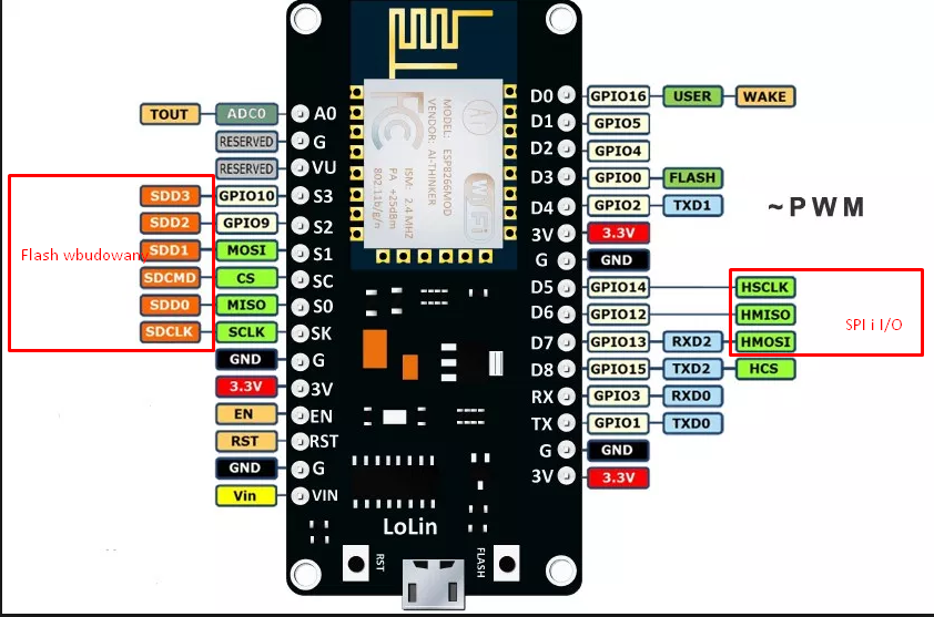

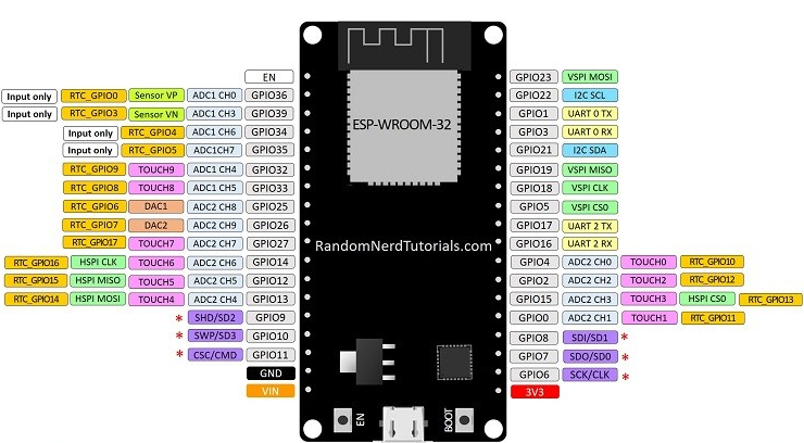

    If you want to use ESP as a standalone uC with a self-written program there is an article here: https://www.elektroda.pl/rtvforum/topic3338096.html.
    After installing the core for the ESP8266, you have a new board with ESP to choose from in Arduino. You choose Wemos and in Arduino fashion start by tapping the digitalWrite, delay, digitalWrite blob. The same with messages on the UART Serial.begin and then Serial.println. You start the Arduino IDE a second time (not the second sketch window), open a new project, this time selecting UNO and tapping the same thing. In one instance of the program you operate on port e.g. COM1 of the UNO, in the other on port e.g. COM2 of the ESP. In this way, you can write to both uCs at the same time. The procedure is the same as for the UNO. Some libraries work in both uCs, some are dedicated, some are reworked for ESP, some work differently and you have to get used to it.
    The Node MCU V3 has 9 pins (and sometimes less - if you want to put it to sleep) to use with the Arduino + 2 for UART and one ADC.

    In my opinion you should purchase a NodeMCU v3 board or something similar. You will be able to realise the whole project on one board. Ultimately also with the possibility of multitasking, which is important in the case of handling many sensors. Sticking to artefacts such as the Pro Mini really doesn't make sense.
    And will I be able to use the pins from the SPI i.e. S0,S1,S2,S3,SC,SK in the NodeMCU v3 as a normal GPIO e.g. for a ds18b20 sensor or RGB diode?

    In my opinion you won't use these pins in Arduino, they are for embedded flash. The first test is to pick a NodeMCU target board and use those pins, compile. They're not defined at all in core Arduino, so probably nothing will come out at this stage. You can dig up in the documentation which IO pins these are and by the numbers use them. I haven't tried it on ESP8266, but on ESP32 it compiles, but after uploading it causes an immediate chip reset - I bought myself a Polish board a la UNO for ESP32 and my colleague brought out the SPI shared with flash on pins 11-13.

    This is obviously not true. Even if these pins were not defined by appropriate constants, direct GPIO numbering could be used.
    This doesn't even compile for the NODE MCU with the ESP8266.
    Pins 12-15 are within the 11 available on the ESP8266. This is the same number of available pins for Node MCU and WeMos.
    Code: C / C++
    Using SPI used for flash ends up with a hang (pins 6-11).
    So that still leaves a total of 11 pins I've written about, including 2 for the UART, + 1 extra ADC, well and keeping an eye on those necessary for pull up/down operation/start up and wake up.

    OK, so we are getting closer to a common understanding that there are 11 available I/O pins though, both in Wemos and in Node MCU. I agree that in some flash usage modes, on some boards, two more pins can be added, but these are not the pins described on the NODE MCU board S0,S1,S2*,S3*,SC,SK. * - for good reason admittedly two of these are described as GPIO9 and GPIO10, but their use http://smarpl.com/content/esp8266-esp-201-module-freeing-gpio9-and-gpio10 is unlikely to happen on a NODE MCU with ESP12E, at least without the use of specialised equipment.
    MOSI MISO AND SCK are the pins on the other side of the NodceMCU board.

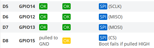

    Why did you insist on the 9 pins of the ESP8266 NodeMCU. Even if he took this module apart and made it safe to use IO9 and IO10 there wouldn't be enough pins:
    2 to the UART of the BT module
    2 for DS18B20 and DHT
    9 to the RGB LED
    2 for the LCD on I2C (possibly more for another type of screen).
    To me, that comes out to somehow 15 IOs here.
    And for that you admit that IO9 and IO10 should not be used (which you yourself posted in the link of post #38)

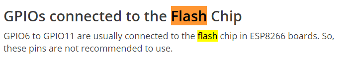

    After all, Sebek was just asking about those pins:
    sebekk95 wrote:
    And are the pins from SPI i.e. S0,S1,S2,S3,SC,SK...
    - these are the derived pins connected to flash GPIO6-11
    and you wrote back that

    You can use these pins with a caveat about the CS pin (GPIO15), which should be connected via a 10k resistor to ground. This is all explained in the link I provided to post #38.

    What does the above prove since these are not the S0,S1,S2,S3,SC,SK (GPIO6-11) pins?
