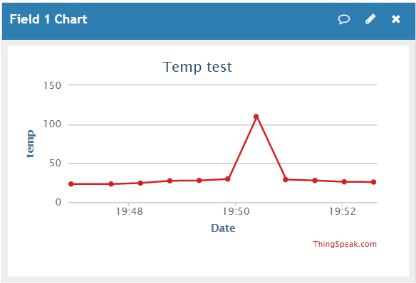

    Sending data to thingspeak.
    Thingspeak is one of the exemplary services that allows you to receive data from IoT devices. After creating an account, we read our API Key, create a new channel and read its ID. We add the ThingSpeak library to the Arduino environment.
    D1 mini module - ESP8266 WIFI launch, start from IoT, Blynk, Thingspeak
    Below is an example code that allows you to send to the created channel temperature data from a sensor with analog output TMP36 .
    Code: C / C++
    The sensor is powered from 3.3V (pin 1 of the sensor), pin 3 is connected to GND, and the signal from pin 2 is sent to the analog input of the A0 module. The use of sensors with digital output (eg DS18B20) will allow for easy operation of more sensors by one D1 mini module.
    After a while, we can see the history of transmitted data on thingspeak. The device consumes several milliamperes in the breaks between transmissions:
