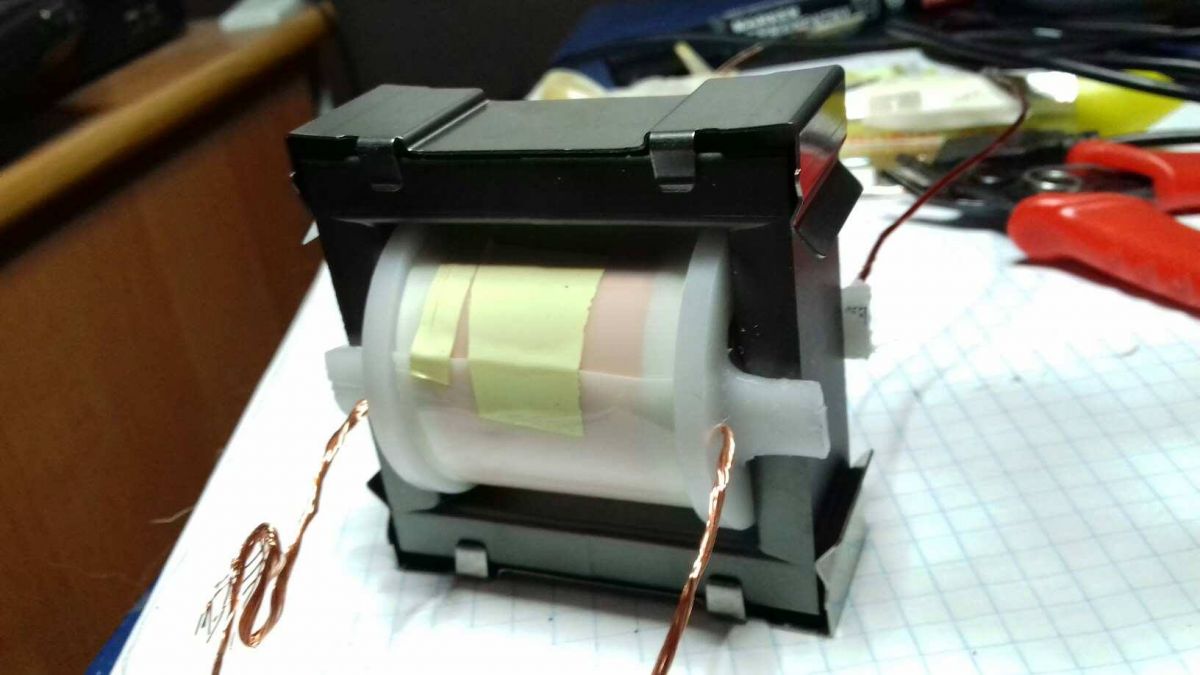

    How to design a pulse transformer
    Winding by hand is something extremely unpleasant, especially when you plan to wind more than a thousand turns of wire 0.1mm ... That's why I decided to make a mini winding station with a tensioner :D
    Next year there will be some topics with practical high voltage transformers, but based on the above calculations. We will see to what extent the practice and theory will agree ;)

    _lazor_ wrote:
    I decided to make a mini winding position with a tensioner
    Beautiful. The only thing missing is automatic wire guidance with feed control :) This is not necessary in amateur use.

    I used the above calculations to design a high voltage transformer:
    Using the driver written on stm32f334 I was able to fire it in series resonance using the nightmare of high voltage transformers - capacity between turns of the secondary winding.
    It works as a current source, i.e. when there is no load it works in short circuit.
