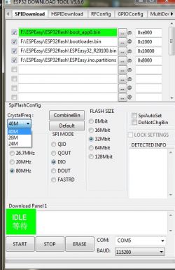

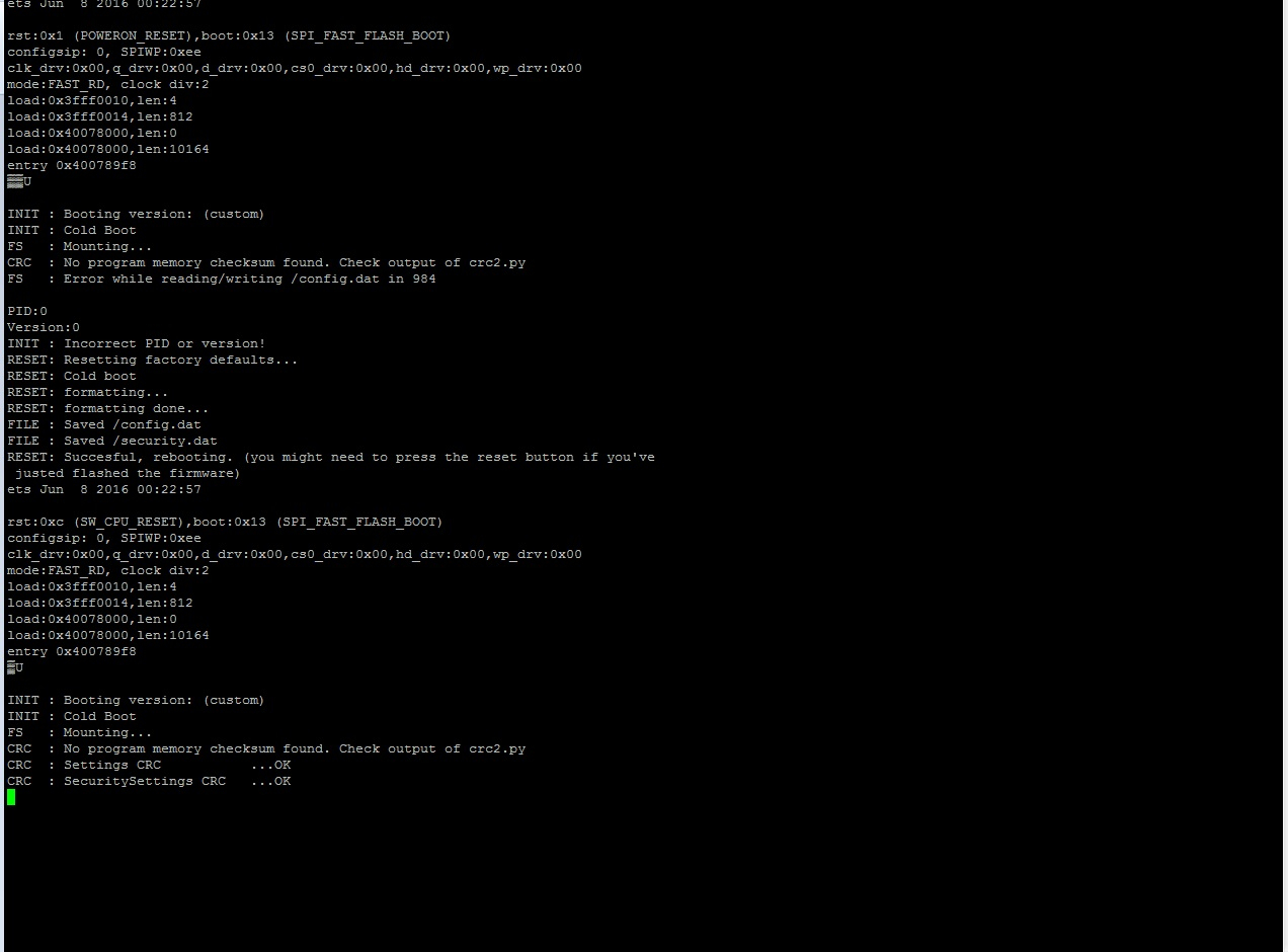

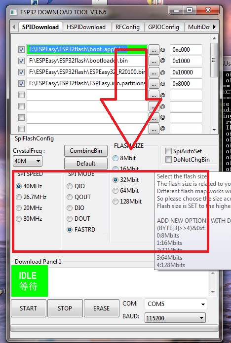

    but I can't change to 80MHz
    No new access point after uploading ESPEasy_mega to ESP-WROOM-32
    Added after 19 [minutes]:
    with these settings
    No new access point after uploading ESPEasy_mega to ESP-WROOM-32 .

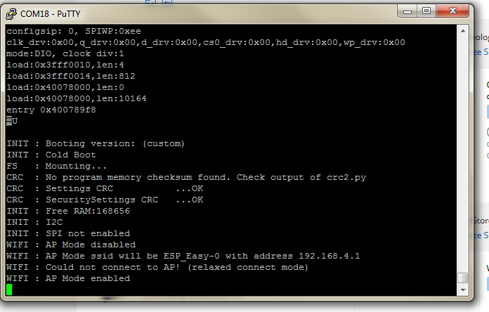

    with putty I got
    link to my esp32
    Link

    khoam wrote:
    khoam wrote:
    The CrystalFreq option should be set to 80 MHz.
    And it is not.
    This is not possible in the tool. At 80MHz you can set SPI, but you don't need to, at 40MHz it works too. Rip everything into a short directory so you can see what you are uploading where.
    Set yourself up like this:
    Note if the green progress bar when uploading flies to the end, you can of course upload with baud 921kb, it is faster, but the cable must be good and short.
    After the first reset when you have the serial connected the monitor will spit it out:
    Spoiler:
    ets Jun 8 2016 00:22:57
    rst:0x1 (POWERON_RESET),boot:0x13 (SPI_FAST_FLASH_BOOT)
    configsip: 0, SPIWP:0xee
    clk_drv:0x00,q_drv:0x00,d_drv:0x00,cs0_drv:0x00,hd_drv:0x00,wp_drv:0x00
    mode:D IO, clock div:2
    load:0x3fff0010,len:4
    load:0x3fff0014,len:812
    load:0x40078000,len:0
    load:0x40078000,len:10164
    entry 0x400789f8
    ŞU
    INIT : Booting version: (custom)
    INIT : Cold Boot
    FS : Mounting...
    E (61) SPIFFS: mount failed, -10025
    FS : Mount failed
    FS : Mount failed
    RESET: Resetting factory defaults...
    RESET: Cold boot
    RESET: formatting...
    RESET: formatting done...
    FILE : Saved /config.dat
    FILE : Saved /security.dat
    RESET: Successful, rebooting. (you might need to press the reset button if you've just flashed the firmware)
    rst:0xc (SW_CPU_RESET),boot:0x13 (SPI_FAST_FLASH_BOOT)
    entry 0x400789f8
    ŞU
    INIT : Cold Boot
    FS : Mounting...
    CRC : No program memory checksum found. Check output of crc2.py
    CRC : Settings CRC ...OK
    CRC : SecuritySettings CRC ...OK
    INIT : Free RAM:168788
    INIT : I2C
    INIT : SPI not enabled
    WIFI : AP Mode disabled
    WIFI : AP Mode ssid will be ESP_Easy-0 with address 192.168.4.1
    WIFI : Could not connect to AP! (relaxed connect mode)
    WIFI : AP Mode enabled
    OTA : Arduino OTA enabled on port 8266
    WD : Uptime 0 ConnectFailures 0 FreeMem 109096
    WD : Uptime 1 ConnectFailures 0 FreeMem 106360

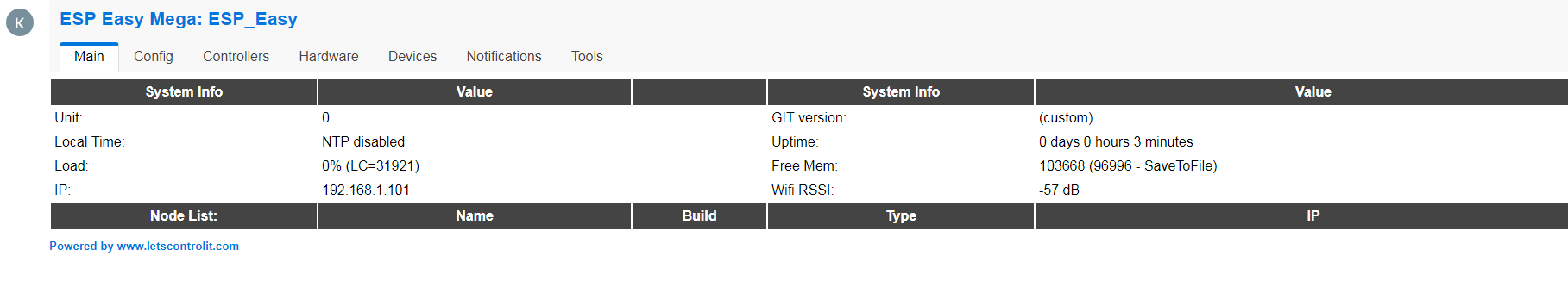

    After the reset, log in using the password "configesp" and when you join the router it shows:

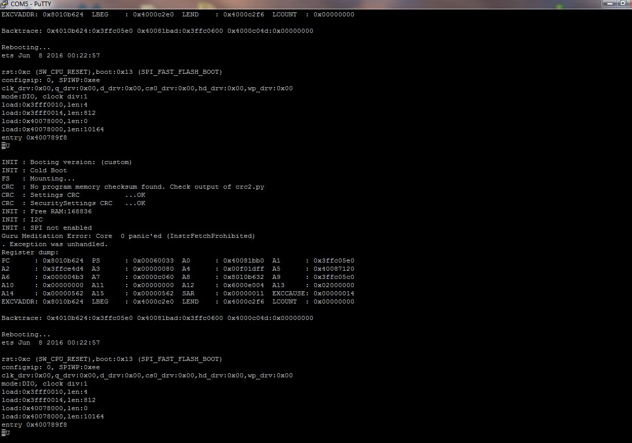

    I did as the colleague above asked
    All the time the data flies and the esp resets as it were

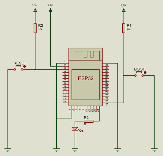

    Upload using Arduino IDE + ESP32 CORE some example with led flashing or printing something on the UART. If the chip works OK without wifi, then it probably has power supply issues.
    I would blindly start with the capacitor at the chip itself, a small ceramic 100nF to start with, and end up somewhere around 3000uF. I've had the problem a few times with modules going OK, but only when I'm not using WIFI. You can see from the log that it randomly bushes somewhere in between:

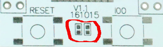

    The adapter is similar, but there is no LED.
    Added after 1 [minute]: .
    I raised the supply voltage, to 4.2V and it started up

    I soldered these resistors myself because they were not available
    Now I have set 4.4V and the module draws about 140 mA and surprisingly it works

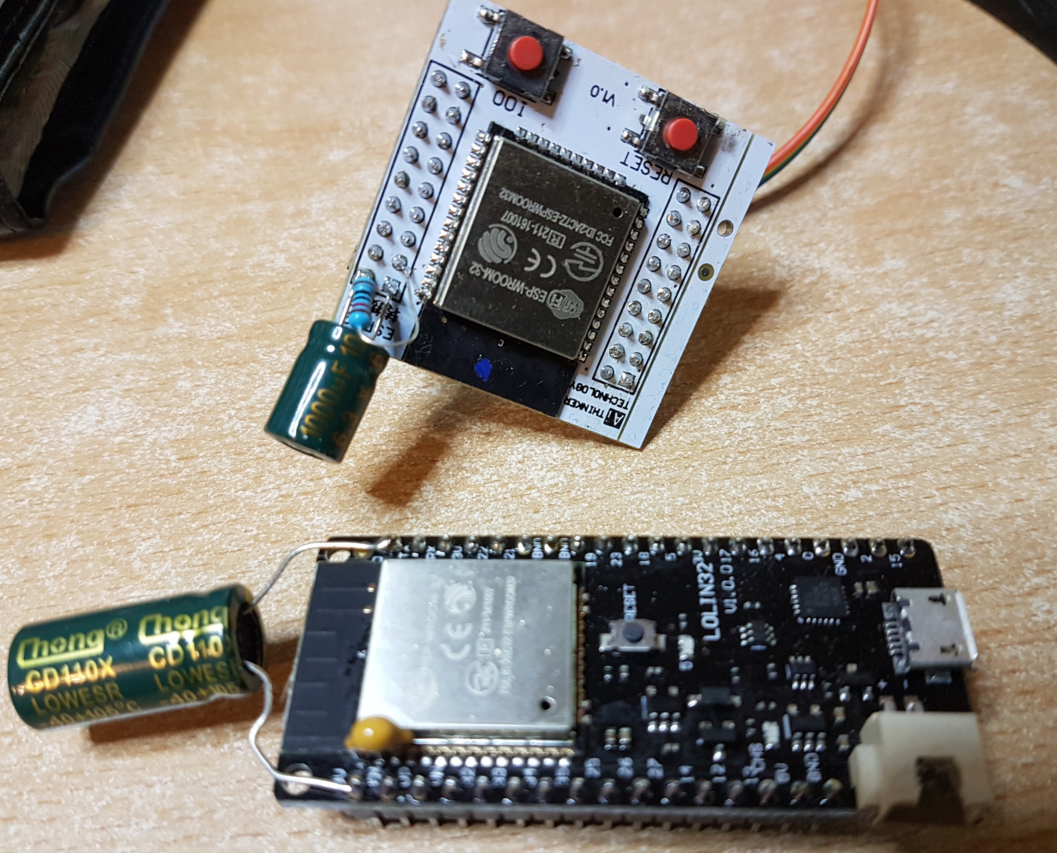

    These are my monsters:
    I added 1000uF to the pure module to get the WIFI working, and 3300uF to the Lolin32, connecting the battery did nothing. I just happened to get this one for free from a Chinese guy because he was supposed to send something else, so I'm not complaining. Both worked beautifully until I turned on the WIFI. Pre-made boards with ESP32 rarely have problems, but as you can see it happens.

    I found the cause
    I added wires to the ESP adapter.... Previously I had such small connectors for golpins and there was a big voltage drop on them (poor connection). Now I have 3.5V on the power supply and 3.48 on the meter at the adapter.
    This is the second time a colleague has helped me.Thank you

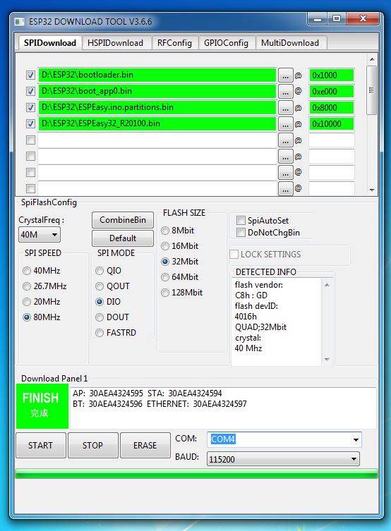

    Hello again. I would like to revisit the topic of esp32. Namely, I am trying to upload a file named "ESP_Easy_mega_20211105_normal_ESP32_4M316k" from github.com in cell 0x10000 but unfortunately after uploading, ESP does not send out AP. How to do this?
  • #54 19723939
  • #55 19723944
    demsy
    Level 22  
    Posts: 887
    Help: 17
    Rate: 178
    khoam wrote:
    demsy wrote:
    I am trying to upload a file called "ESP_Easy_mega_20211105_normal_ESP32_4M316k" from github.com in cell 0x10000
    Why from 0x10000?
    Hmmm. good question
    Because I upload the file "ESPEasy32_R20100" that works?
  • #56 19723947
  • #57 19723959
    demsy
    Level 22  
    Posts: 887
    Help: 17
    Rate: 178
    khoam wrote:
    from address 0.
    so 0x0?
    #58 19723965
  • #59 19724181
    demsy
    Level 22  
    Posts: 887
    Help: 17
    Rate: 178
    khoam wrote:
    demsy wrote:
    khoam wrote:
    from address 0.
    i.e. 0x0?
    Yes, it is the same :) .
    Link
    Many thanks, once again a colleague has helped me
