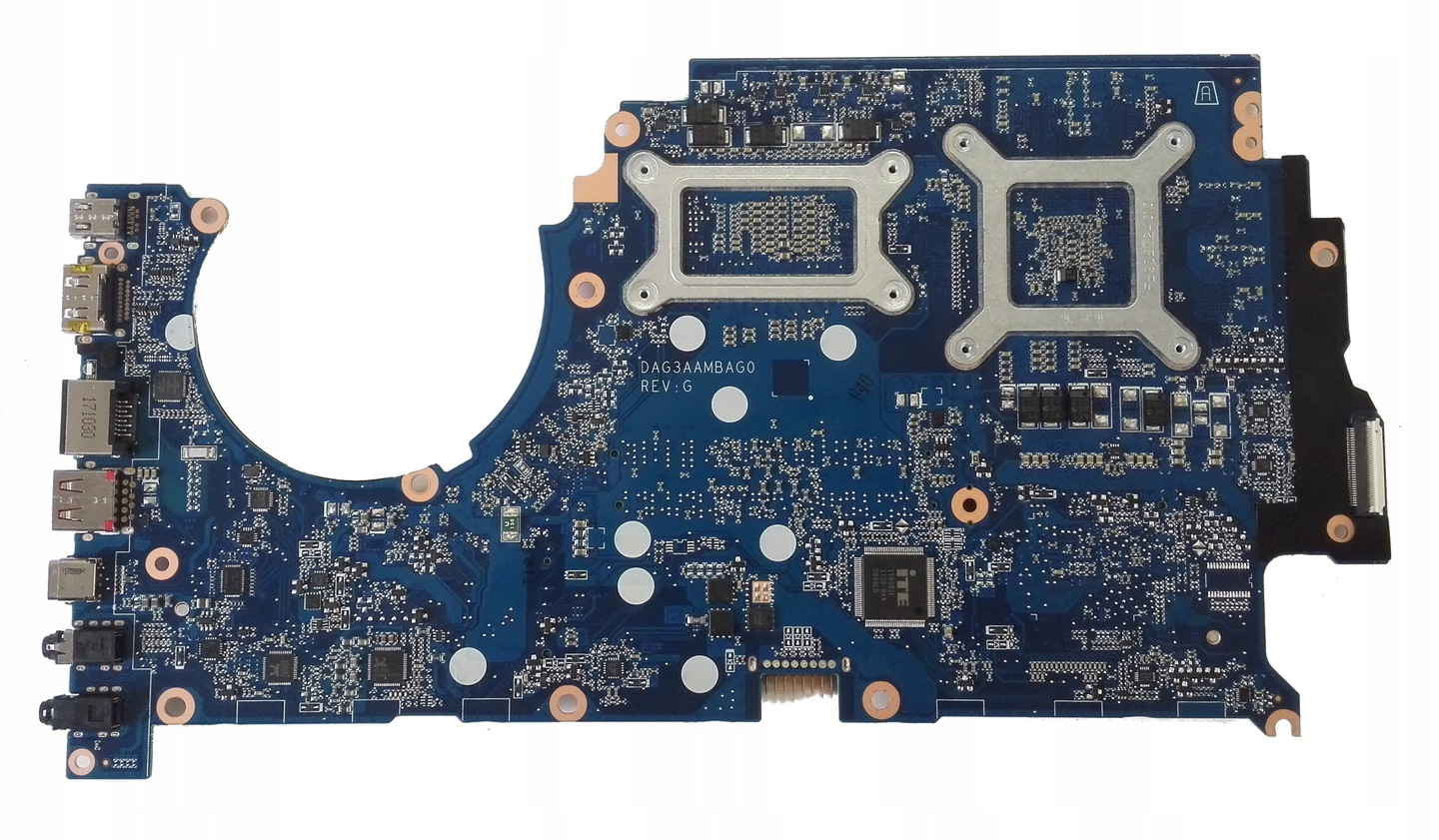

    I received an hp omen TPN-Q194 DAG3AAMBAG0 laptop that did not respond to the power button. After quick measurements, it turns out that the 3.3V converter is not working
    No short circuits on the coils, 5V present.
    I wanted to replace the system responsible for 3.3V, however, it is coded and is called AWV7YJ. I would like to know the real name of this system in order to order a new one because I do not have a diagram of this board.
    A picture of this layout is attached
    HP OMEN TPN-Q194 DAG3AAMBAG0 Laptop: Identifying AWV7YJ 3.3V Converter Component

    Type in the "search" phrase: AWV
    You have 11 correct answers
    e.g.
    Spoiler:
    AWV - SY8286BRAC / SY8286B

    I would like to know the real name of this system in order to order a new one because I do not have a schematic for this board.
    SY8286BRAC.

    Can you help me diagnose this converter? Because I'm not sure if it's the system's fault.
  • #5 18177119
    _1KOKO
    Posts: 2257
    Help: 223
    Rate: 164
    Is it getting 19v? warming up?
  • #6 18177156
    koko115
    Posts: 272
    Rate: 26
    19V is coming. He's not warming up.
    I will add that 19V from the power supply of the converters disappears after about 2 minutes after connecting the board to the power supply. Values measured immediately after connecting the power supply: No signal (EN1) on the 12th leg of SY8286BRAC. On the 11th leg (EN2) there is 4.3V
    Will these voltages be enough to start this converter?
    There is also no +3VALWP on the 9th leg of SY8286BRAC (PG) and no 3V on the 6th leg (LX signal)

    Does it have an LDO present?
  • #8 18177276
    koko115
    Posts: 272
    Rate: 26
    Yes, the LDO is 3.31V

    :!: :idea:
    _________________________________________
    There is an ITE8987e on this kbc board
    - read about it on the forum
    -you have 3V on the button and it drops when pressed
    - it comes to kbc and ... there is a translation of this signal ... on other pins
    - Kbc power supply you have
    HM175 SR30W chipset
    i7-7700HQ
    DDR4
    GTX 1050 (N17P-G0-A1) 2GB
    HP OMEN TPN-Q194 DAG3AAMBAG0 Laptop: Identifying AWV7YJ 3.3V Converter Component HP OMEN TPN-Q194 DAG3AAMBAG0 Laptop: Identifying AWV7YJ 3.3V Converter Component HP OMEN TPN-Q194 DAG3AAMBAG0 Laptop: Identifying AWV7YJ 3.3V Converter Component
    There is no SM for this Quanta platform, but use similar solutions
    In Quanta solutions (quanta G75a... is N17P-G0-A1 1050M) / Quanta ZR?/ under AMD cpu) / DAX61CMB6DO / DA0X63MB6H1
    *other
    - you do not have a short circuit on this 3.3V line, this voltage supplies e.g. RTC and CMOS battery through e.g. a diode system > see e.g.

    There is 3V on the switch.
    But for some reason the 3.3V converter does not work, I would like to explain it at the very beginning.

    Is it about these EN1 and EN2 signals?
    Exactly.

    So, due to the lack of signal on EN1, I can conclude that the ITE needs to be replaced?

    Look e.g. in SM under HP on the platform (Quanta Y31A rev:C)
    -same kbc, e.g. cpu SR1EB ( i7-4510U) and GTX 870M N15P-GT-A2
    3/5V made on SY8208, EN pins

    Suggesting this diagram, it turns out that one signal activates two 3/5V converters, this signal is S5_ON from KBC.
    But the 5V converter works.. so it can't be a faulty ITE.

    You have in attachment SM for Quanta G74A platform (DAG74AMB8D0)
    - same kbc and 3/5V chips
    - read what signals from kbc are needed to run DC-DC 3V PU10 SY8286BRAC p.39
    * dc-dc 5V is PU11 SY8288CRAC
    How can you not handle it now?

    From this it follows that the signals from the KBC needed to start are S5_ON and HWPG.
    Both are missing. For a fraction of a second moments after turning on the power supply, about 1.5V appears on S5_ON. I desoldered the SY 8286BRAC to check if the signals would appear, but they did not. In addition, the 5V converter stopped working then. After soldering again, the situation returned to the starting point.
    I also noticed that for 0.5 seconds after pressing the power button, the white LED in the power socket lights up.
    Why.?
    Please tell me what layout you have
    - in charger
    - other systems, e.g. 1.05V power supply
    Look at SM DAAX3MB16A1 how the HWPG signal is made
    - pages 24, 25, 29
    ps
    Quanta ZHKD platform (mb board: DAZKHKDMB6E0 rev: E) same kbc
    - HWPG signal shown
    -SR29E N3700 CPU
    no HWPG, the result of no MAIND on the PQ4 gate, > which is dependent on the MAINON coming from the ite8987e.
    - pin.80 EC_APWROK 2.4V
    - pin.33 33 EC_PWROK missing
    RSMRST# 3.3V
    SLP_S3# 3.3V
    SLP_S4# 3.3V
    KBRST# 3.3V
    HWPG 3.3V
    EC_PWROK 3.3V
    Datasheet_kbc IT8987e work application in Quanta platforms in attachment
    Look carefully.
    :?: Either Bios wrong or kbc backwards or kbc dunk
