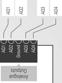

    I want to connect an EMO TM electro-thermal actuator. In the wiring diagram there are wires
    1) GND (COM) - I read this as common ground
    2) 24VAC AC supply -
    3) Y valve control 0-10VDC (direct current)
    4) not connected
    Electro-thermal actuator - common GND DC and AC - how to connect? .
    As 24VAC power supply I want to use a toroidal transformer with two wires of the same colour coming out of it
    The 0-10VDC control voltage is from the PLC where the analogue output and the second Ground output are marked
    The question is how to connect all this
    and especially where to connect GND, which is supposed to be common for both 24V AC and 0-10 DC voltage

    On the controller, you do not connect under AI (input) but under AO (output).
    The GND of the actuator must be connected to the Ground of the controller. If the controller has an isolated power supply, you still connect G0 (or 0VAC or GND or whatever it is called) of the power supply from Ground.

    Yes of course my mistake in the description - in the controller I connect under AO (output) - I corrected the schematic.
    The question remains how to connect the transformer - one wire under 24VAC. And the other?

    The controller is Loxon miniserver

    My Loxone has a 24VDC power supply.

    Well, unfortunately two power supplies. The actuator only accepts AC, the controller only DC
    +24V power supply on:
    - +24V on the power plug on the controller
    0V of DC power supply on:
    - one 24VAC trafo lead,
    - Ground at the power plug on the controller,
    - Ground on analogue outputs connector AO
    - 0V of the actuator
    Second trafo lead on:
    - 24VAC at the actuator
    AO of the controller to:
    - 0-10V input of the actuator
    Both supplies via 1A fuses. Can be glass radio either 5x20 or D01 inserts ...

    It took a while because I had other pressing matters, but I finally followed the advice and ... it works!
    Thank you for your help!
