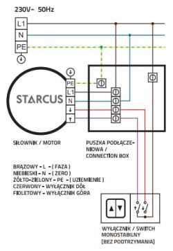

    You are right, everything sits in the box, not in the motor as such. Nevertheless, the wires are already sunk into the walls and only come out in the boxes. In starcus it looks like this:

    bercik_gsi wrote:
    In addition, there is already a COSMO control unit for these, but nothing "intermediate".
    Cosmo is a Mobilus control panel, if it works with your roller shutters then the Mobilus C-AR controller will also work.
