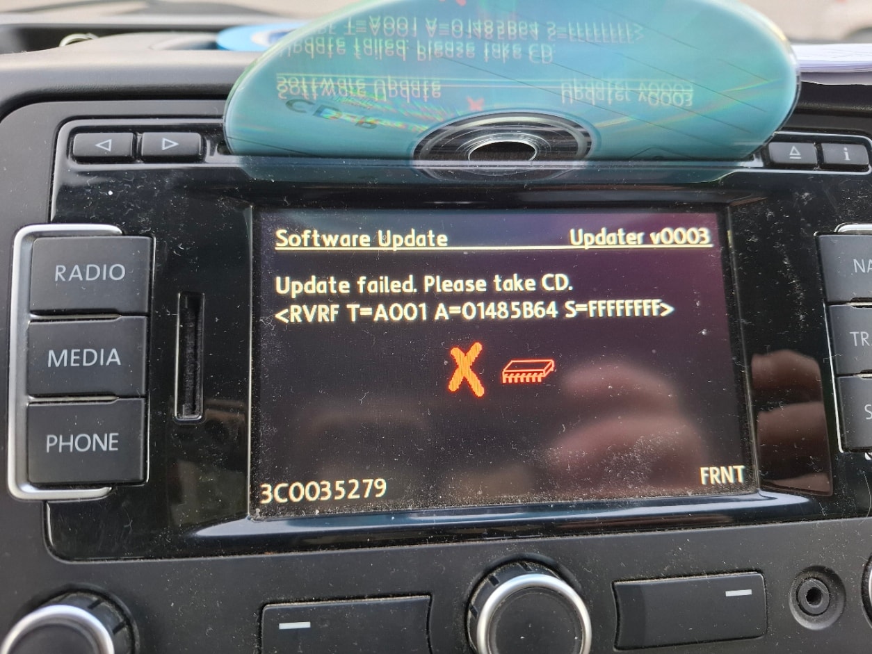

  • #121 21782747
    kanguroo
    Posts: 51
    Rate: 21
    >>21717575
    I got an error. Any ideas ?
    • VW RNS 315 - Firmware Update ISO 20251217_081108.jpg (509.58 KB) You must be logged in to download this attachment.
  • #122 21785350
    kanguroo
    Posts: 51
    Rate: 21
    I found out that this situation occurs when one of the components in the radio is faulty. In my case I am counting on it being the Bluetooth, as it stopped working before the whole operation. I have not yet confirmed this thesis. I will let you know.
