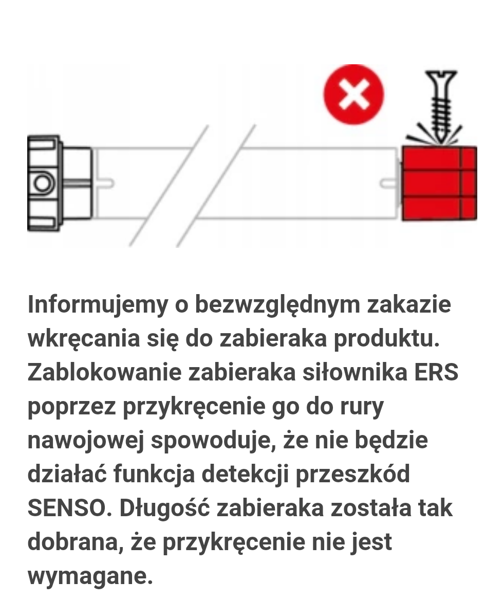

    Take a look at this drawing. It's a senso motor with detection. What do you think about it , banning screws in the driver.
    • How do I protect external roller shutters from crushing when they stop? Screenshot_2019-10-28-22-03-58-1.png (221.8 KB) You must be logged in to download this attachment.

    Ryszard49 wrote:
    I had a blind destined for loss so I could test any ideas without fear of damaging anything
    Well what ideas did you test?
    Ryszard49 wrote:
    I didn't want to put any extra wires into the cassette though.
    Then how do you imagine any safety device?
    Ryszard49 wrote:
    The additional device would have to fit into the cassette and not interfere with the operation of the roller shutter.
    The problem, however, is that the roller shutter stops outside the cassette.
    Ryszard49 wrote:
    It was not that simple. Unfortunately, a positive solution was not found.
    With such input parameters it is not surprising.

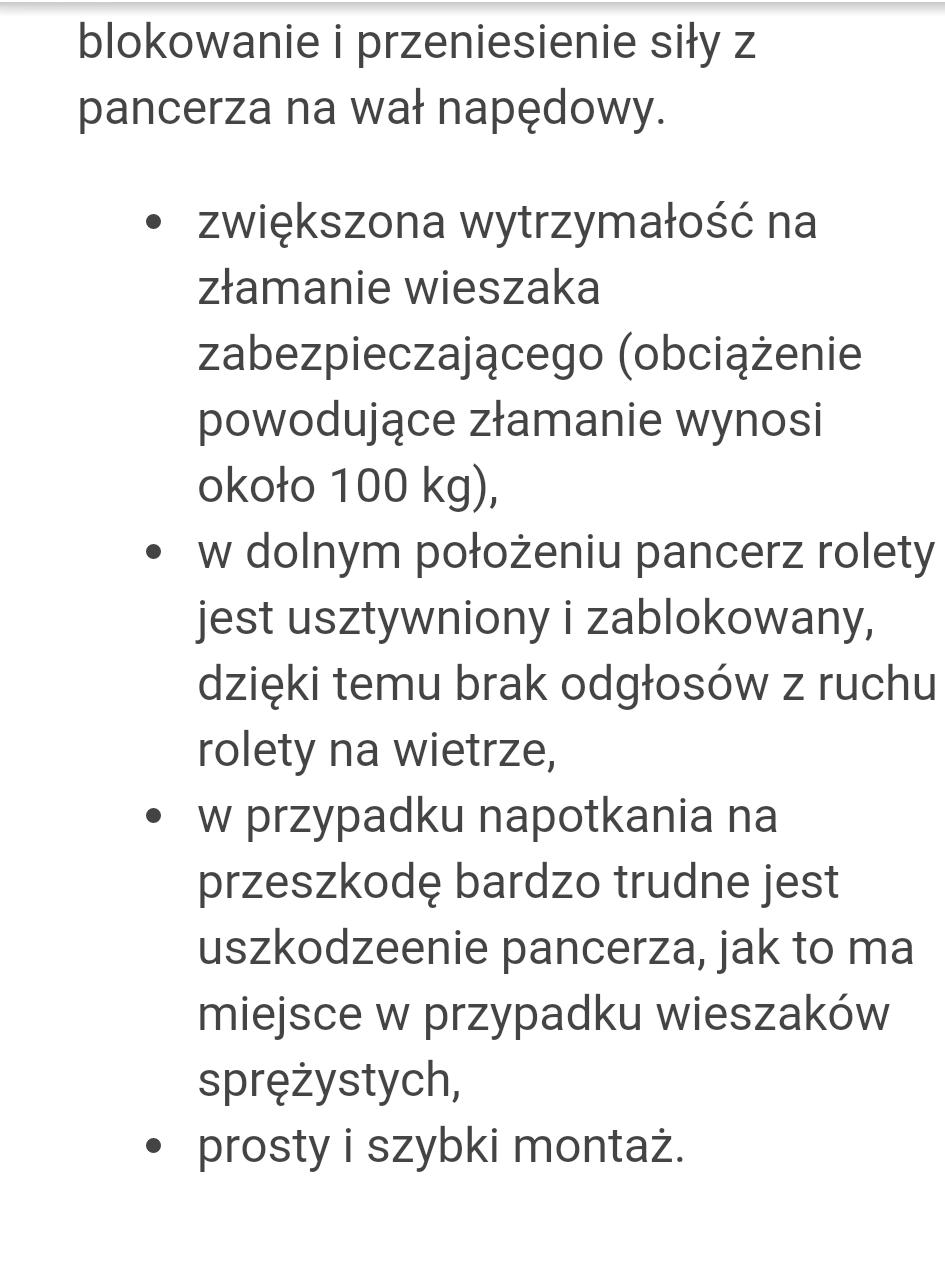

    They recommend lock to play hangers at detection. Could they be the key? Read this
    • How do I protect external roller shutters from crushing when they stop? Screenshot_2019-10-28-22-25-13-1.png (201.39 KB) You must be logged in to download this attachment.

    miroslaw great , this was the first thing I replaced, in fact the previous hangers were damaged. When the roller shutter was jammed on these new rigid hangers the profiles were damaged, they were hooked out, in short they came apart.
