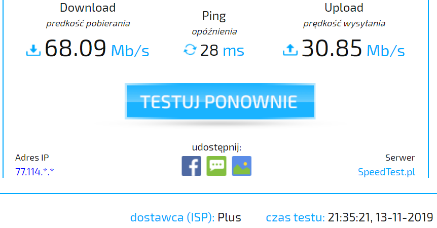

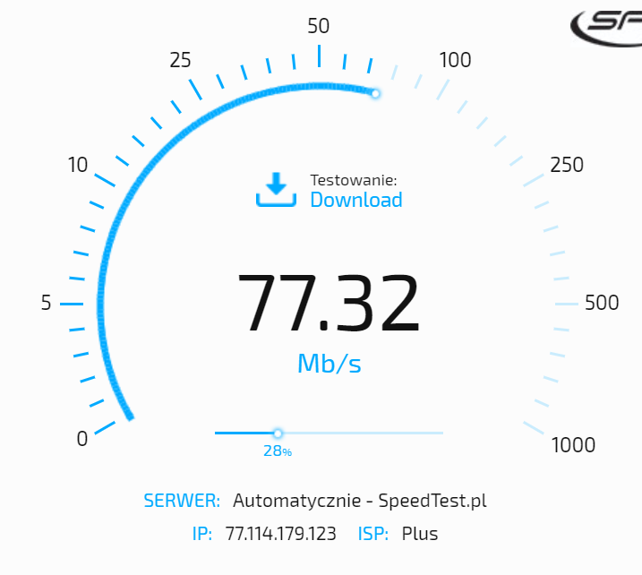

  • #31 18276523
    kejk1992
    Posts: 35
    Rate: 14
    Screen with the test time (there was even 80 + DL in the peak)

  • #32 18276538
    matek451
    Posts: 31253
    Help: 4352
    Rate: 5808
    So it's OK, just use it. A decent upgrade of the BTS and the addition of the LTE2600 on 20mHz band does a good job. It is a pity that Plus is taking such steps in only a few areas and at selected base stations.
