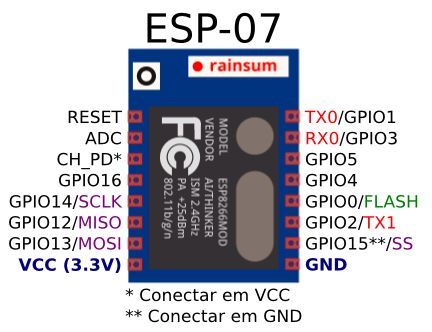

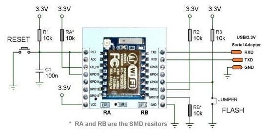

    I own a module as per the topic. I have never used it so far. When I connect it to the power supply, does it execute some program uploaded by the manufacturer? There are two LEDs on it, but neither is lit. The module does not respond to AT commands, I checked on different speeds.
    I have connected according to this description:
    Link .

    Usually, there is a soft interpreting AT command uploaded. Maybe you have the interface speed set incorrectly, or you don't add CR+LF at the end?

    When 3.3V is applied, a red LED should light up, even if nothing else is connected and there is no software uploaded.

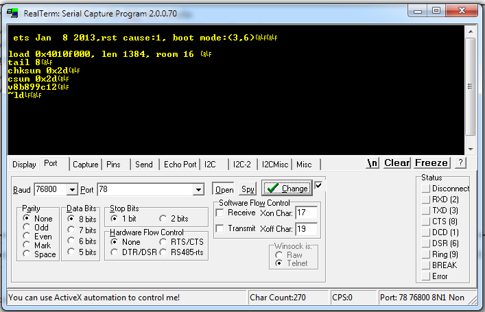

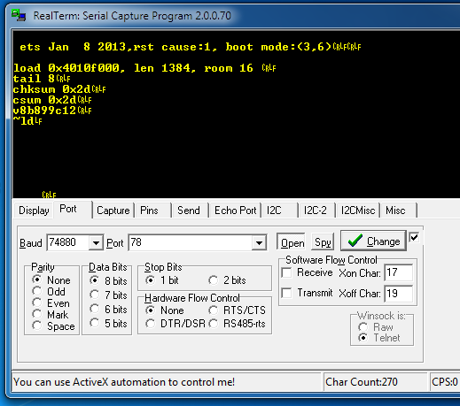

    khoam wrote:
    Set the speed in the serial terminal to 74880,
    Rather 76800.

    I do not have RST and GPIO16 connected. CH_PD directly to the power supply (I shorted a resistor because it makes no difference). Similarly GPIO15 directly to ground. GPIO0 and GPIO2 without pull-up resistors to Vcc. GPIO2 directly to GND. Another difference is that the ground of the converter and the module are not connected.

    I have connected the masses, no change. I will add the resistors later, as I already have enough for today. I come across different wiring diagrams and I don't know which is the right one. Sometimes instead of a time out it says "Invalid head of packet ('xyz')", where "xyz" is different.

    I added all the resistors and even a capacitor to the RST, but nothing changed. Maybe this module is faulty.

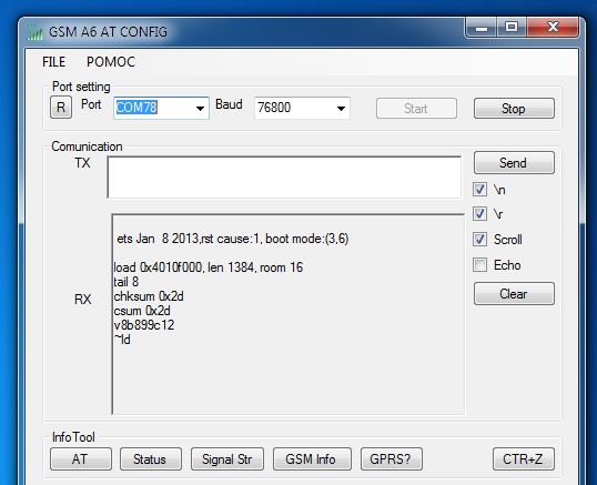

  • ESP8266 UART supports 74880, not 76k
    #23 18479423
  • UART converters accept 74k and 76k baud rates
    #24 18479743
    kaczakat
    Posts: 1748
    Help: 317
    Rate: 231
    I also have a 74k in my Arduino and it works. But 76k also works:
    [ESP8266][ESP-07] Is the program preloaded at the factory? LED does not light up. .
    Both speeds work in realtherm too, although in turn this software does not support either:
    Maybe the difference is too small to be relevant to the occurrence of errors, maybe the uart converter doesn't give a damn what it is set to and chooses the closest possible one, well that would be acutely inconsistent with what you wrote, because the CP2102 that I have now connected supports just 76800 You have to check on FTDI, this one has a larger range and see when something cries out, but that's if someone is very curious and determined (CH34x also has 76800).

    I supply the board with 3.3V. I also switched the USB/USART converter to 3.3V, but I did not let the power from it go to the contact board. I took power from an external power supply and a power module for the contact board. I'm just wondering if, with the converter set to 3.3V, this is also the voltage level on its signal lines.
    As I wrote earlier, none of the LEDs on the ESP-07 module are lit.

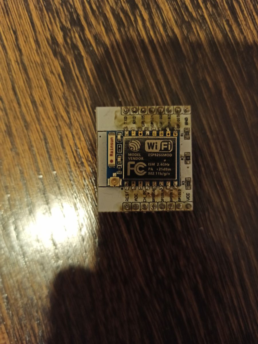

    khoam wrote:
    Can you measure what the voltage is directly on the ESP-07 pin? Marked, as VCC on the picture below.
    Thanks khoam. Good clue. I must have soldered the Vcc pin of the adapter wrong. As I pressed it harder with the multimeter tip, the red LED on the module started to light up. I always have a problem with soldering.
  • #29 18481502
  • #30 18481520
    sq9etc
    Posts: 228
    Help: 11
    Rate: 15
    khoam wrote:
    Well from the photo you posted earlier it looked like cold solder, but I didn't want to criticise you so immediately
    However, you should have:) .
    I'll correct this tomorrow and re-call the rest of the connections just to be sure.
    There is hope that I have not rammed the module.
