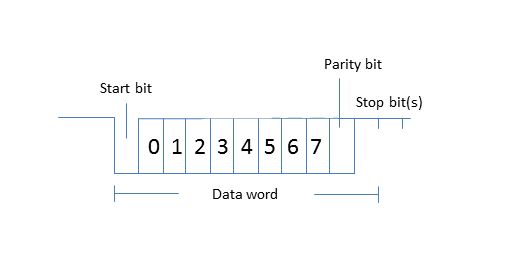

    Most embedded engineers are familiar with the UART interface: universal asynchronous receiver / transmitter. It is a microcontroller peripheral that converts incoming and outgoing data bytes to a serial stream. A start bit starts a serial stream and a stop bit or two ends a data word (frame). The UART also has the ability to add a parity bit to the frame to help detect if an error has occurred during transmission. Picture 1 shows a standard example of a frame that can be seen by viewing data transmitted over the UART.
    USART vs. UART - what are the differences?
    Fig. 1. Data frame in the UART interface.
