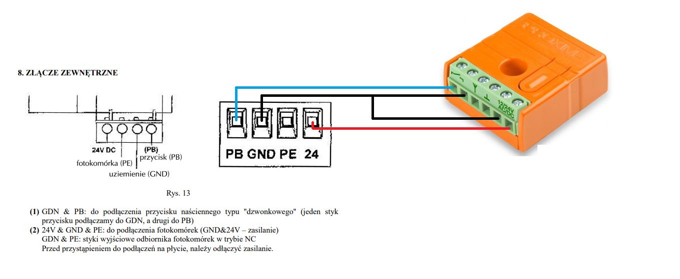

    I have a WIŚNIOWSKI garage door operator and a HATO entrance gate operator, of course the remotes do not work. I am going to buy a proxima NM radio and connect it to the hato controller so that the wiśniowski remotes work with the hato. Can anyone tell me where to connect what and how between the hato controller and the proxima?

    ad1233 wrote:
    Can someone tell me where to connect what and how between the hato controller and the proxima?
    In the image below you will find the solution:
    Connection of Proxima NM radio to HATO controller .
