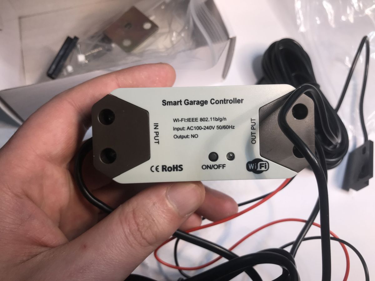

  • A Smart Garage Controller held in hand, showing input/output ports, ON/OFF button, and cables. .

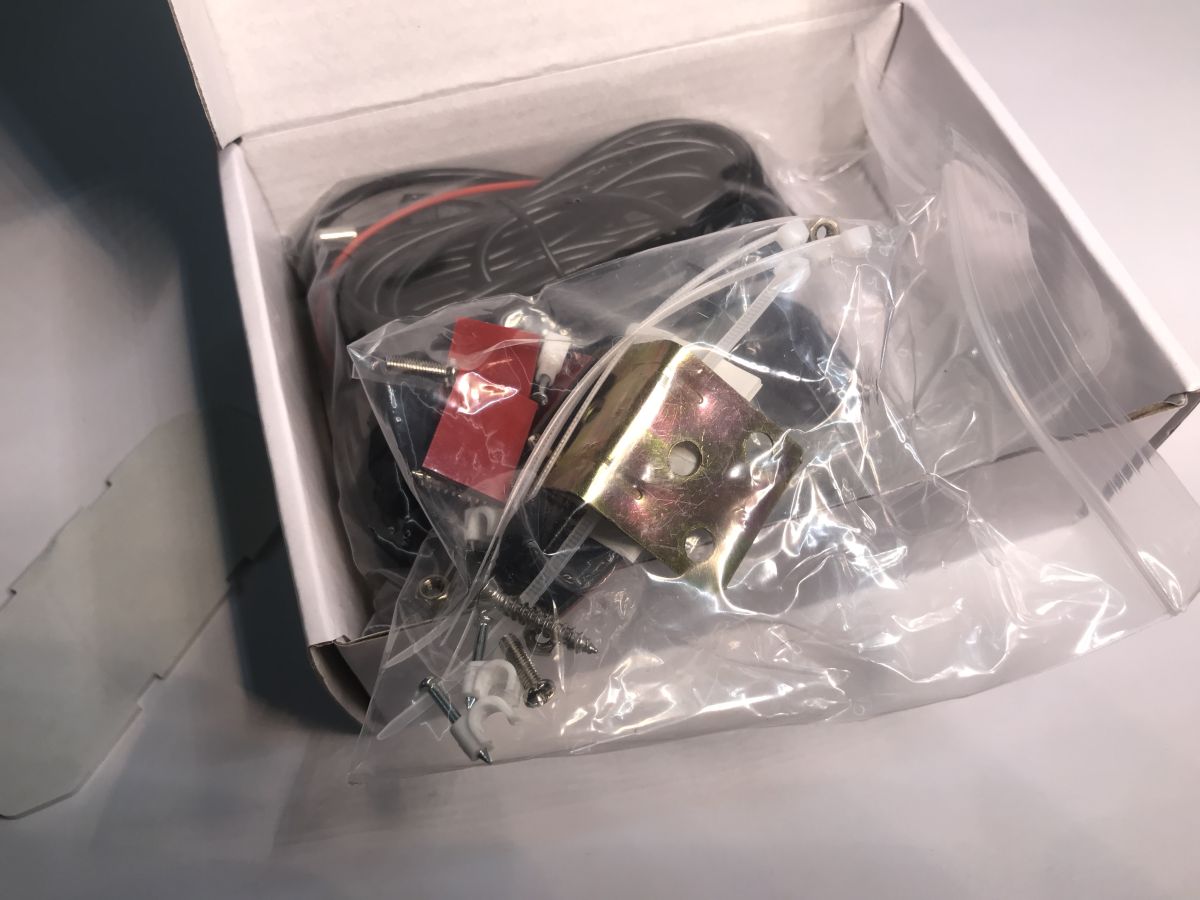

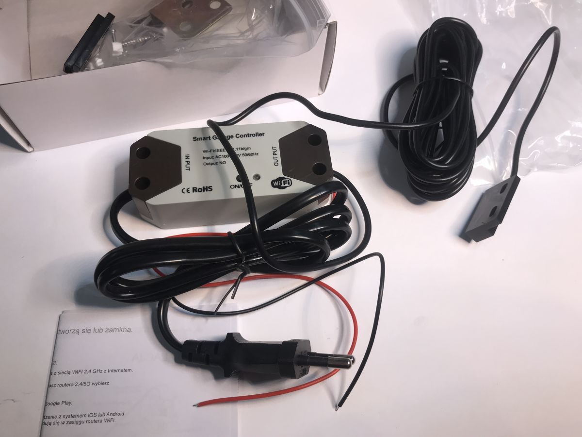

    Here I will show a garage door controller that can be easily changed in software so that it works 100% locally, without the cloud, and connects to Home Assistant. Here is the ATLO-GDC2-TUYA, available to buy for just PLN60. Normally it works with Tuya, but it is built on CB2S, so you can upload our Polish soft to it. All you need for this is a USB to UART converter, but perhaps let's start by looking at the contents of the kit:
    ATLO-GDC2-TUYA garage door controller package with an illustration of smartphone control and included components. Box of ATLO-GDC2-TUYA garage door controller with images of the device, garage doors and compatibility with Google Assistant and Alexa. .

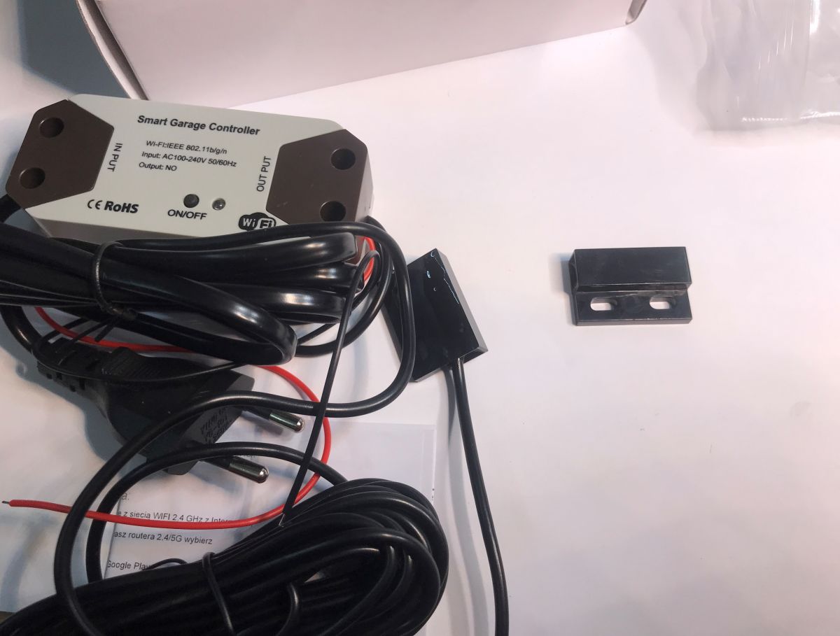

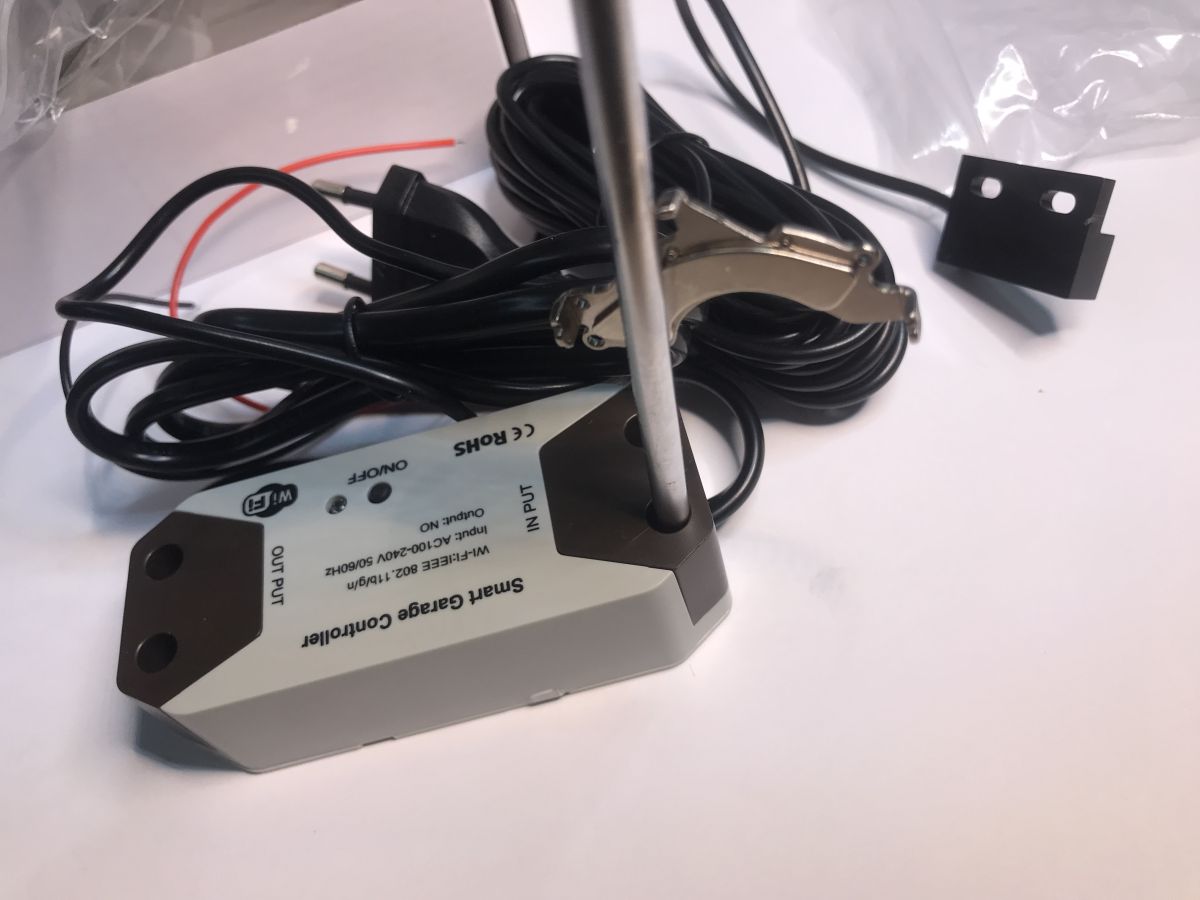

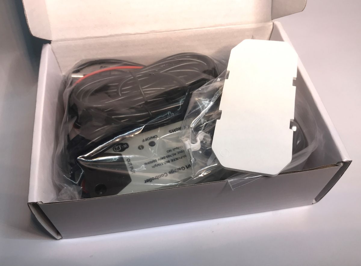

    The kit is quite extensive, because in addition to the gate controller itself with the sensor on the long cable, you also get the mounting components, and the whole thing is mains-powered, i.e. it has a built-in power supply. I have already seen kits that required an external power supply fed into the USB port, there is no such problem here.
    ATLO-GDC2-TUYA garage door controller set in an open box with accessories and a long cable in a plastic bag. Contents of the ATLO-GDC2-TUYA garage door controller set in an open box, with visible cables and mounting accessories. ATLO-GDC2-TUYA garage door controller set with manual and accessories in plastic bags. .
    ATLO-GDC2-TUYA garage door controller kit with sensor, wires, and mounting accessories on a white background. ATLO-GDC2-TUYA garage door controller set with accessories: controller, long-cable sensor, wires and mounting parts. ATLO-GDC2-TUYA garage door controller with cables and an information label. .

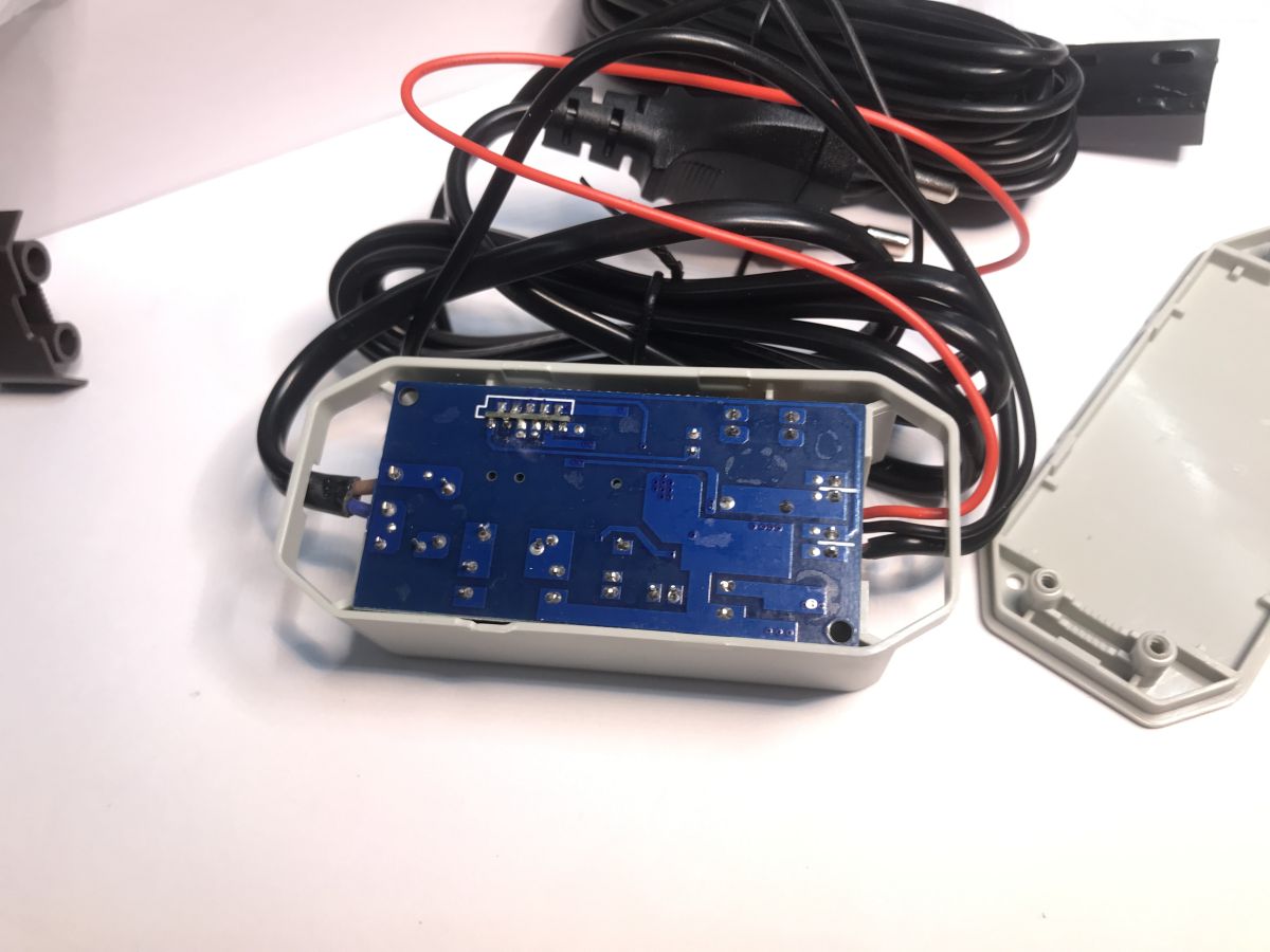

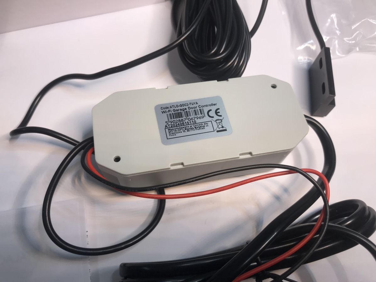

    I then move straight on to the presentation of the interior. The screws need to be removed.
    ATLO-GDC2-TUYA garage door controller with power cord and long-cable sensor on a white background. ATLO-GDC2-TUYA garage door controller opened, showing the PCB and connected wires. .

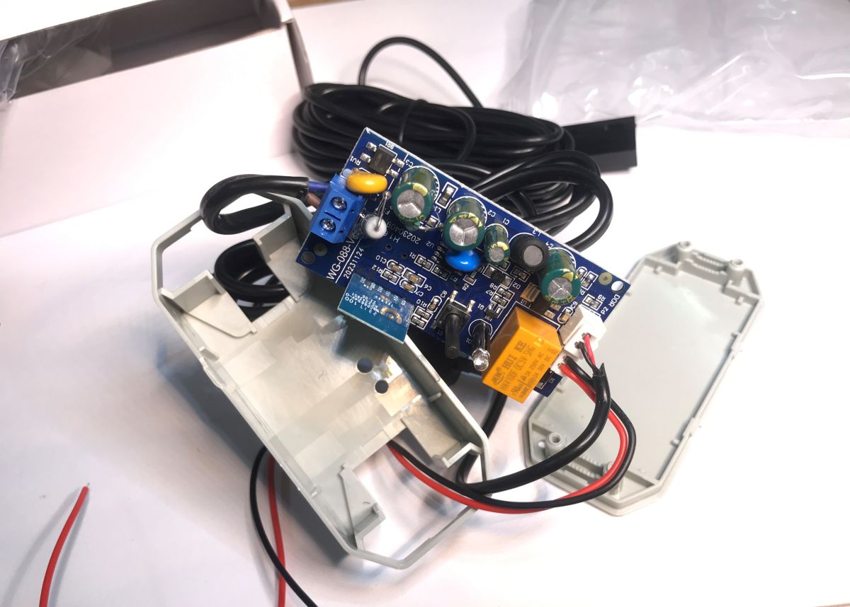

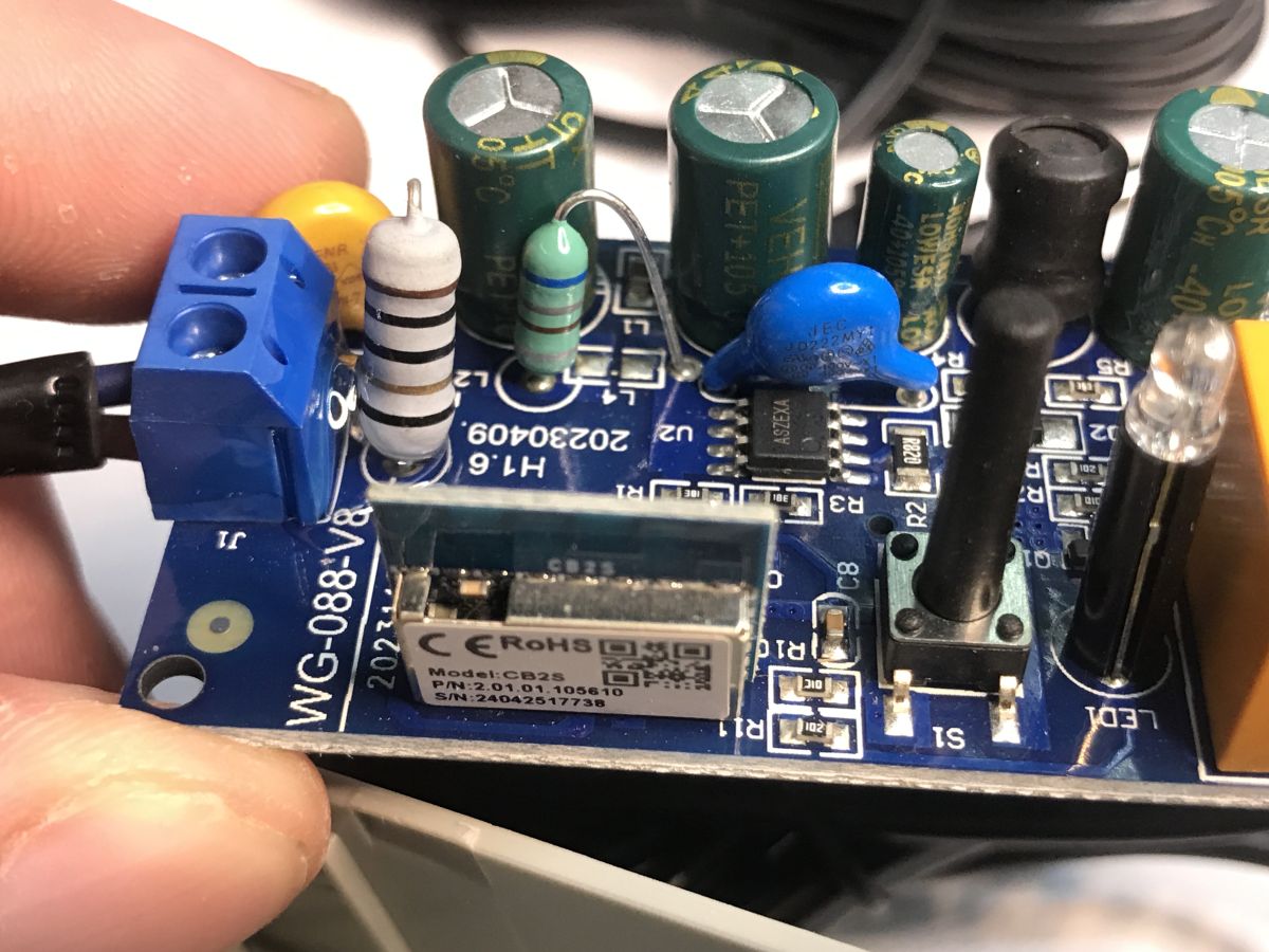

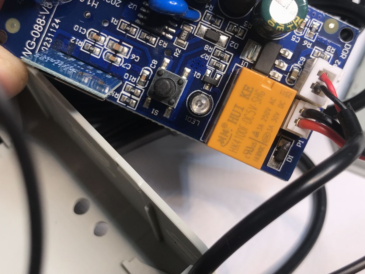

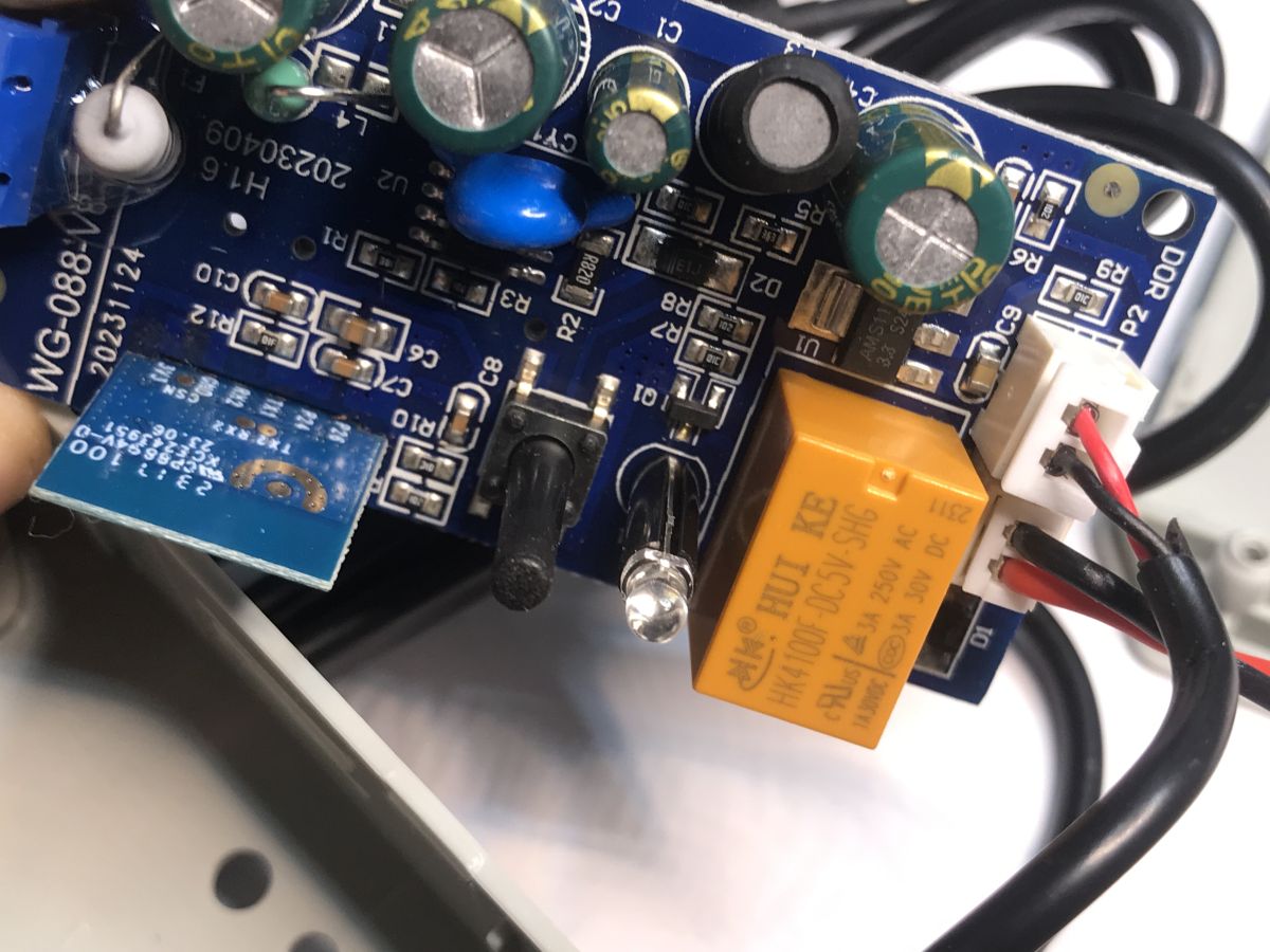

    The board is double-sided, but the components are only on the top. It mixes surface mount and through-hole assembly. From the solder side you can see the WiFi module already soldered in.
    ATLO-GDC2-TUYA garage door controller with open casing, showing PCB with electronic components and wires. .

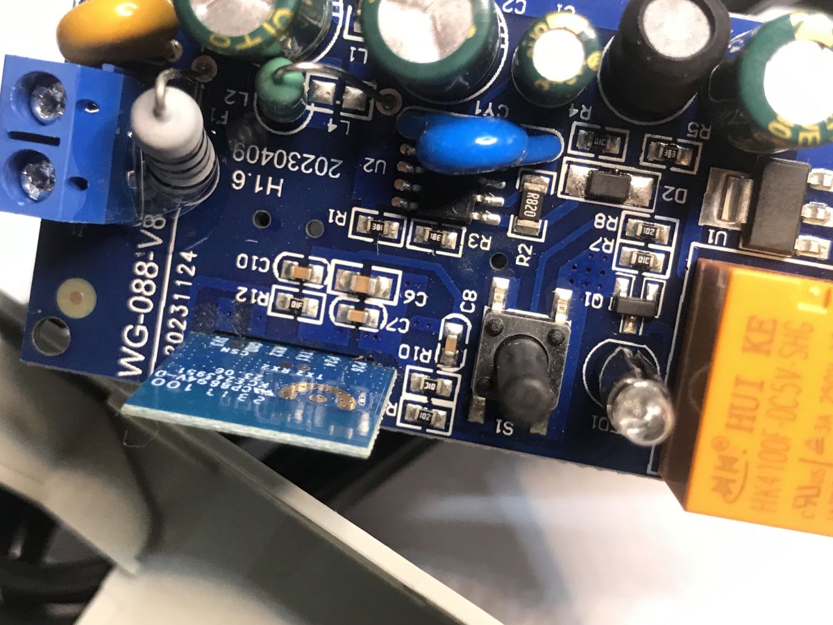

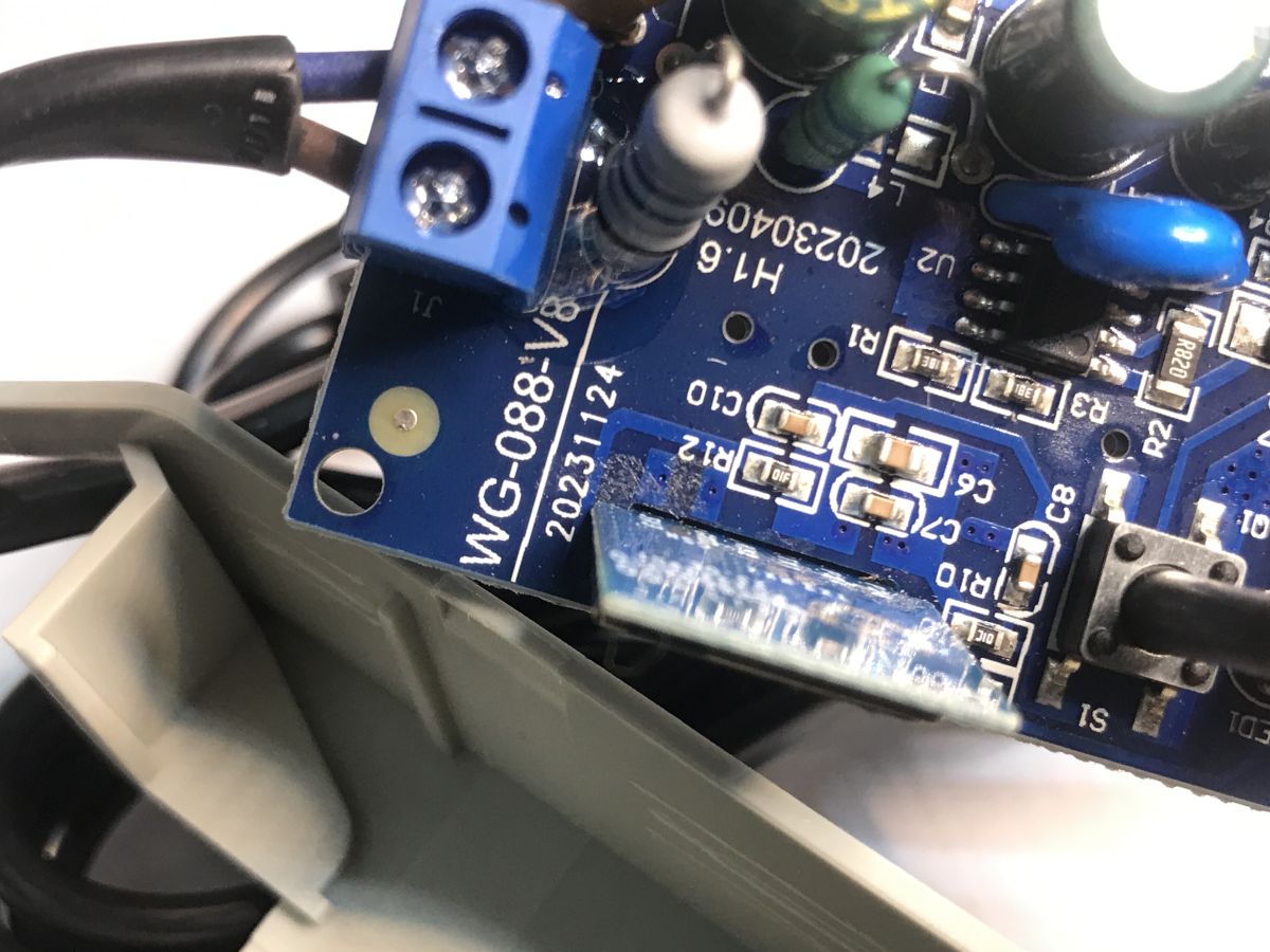

    The first impression is positive. A fuse and even a varistor? Apparently these are the basics, but in the cheapest products I often don't see a varistor. Apart from that, there is a non-isolated power supply (step down), a 3.3V LDO, a WiFi module and a relay. The PCB designation is WG-088-V8, date 20230409.
    Close-up of a garage door controller PCB with visible CB2S WiFi module, relay, and electronic components. Close-up of a garage door controller PCB labeled WG-088-V8, date 20231124, with various electronic components visible. .
    The relay (used to short-circuit the gate button) is HUI KE HK4100F-DC5V-SHG.
    Close-up of the ATLO-GDC2-TUYA garage door controller circuit board with a visible HUI KE relay and connected wires. Close-up of the ATLO-GDC2-TUYA garage door controller PCB with a HUI KE relay, capacitors, and connected wires. .

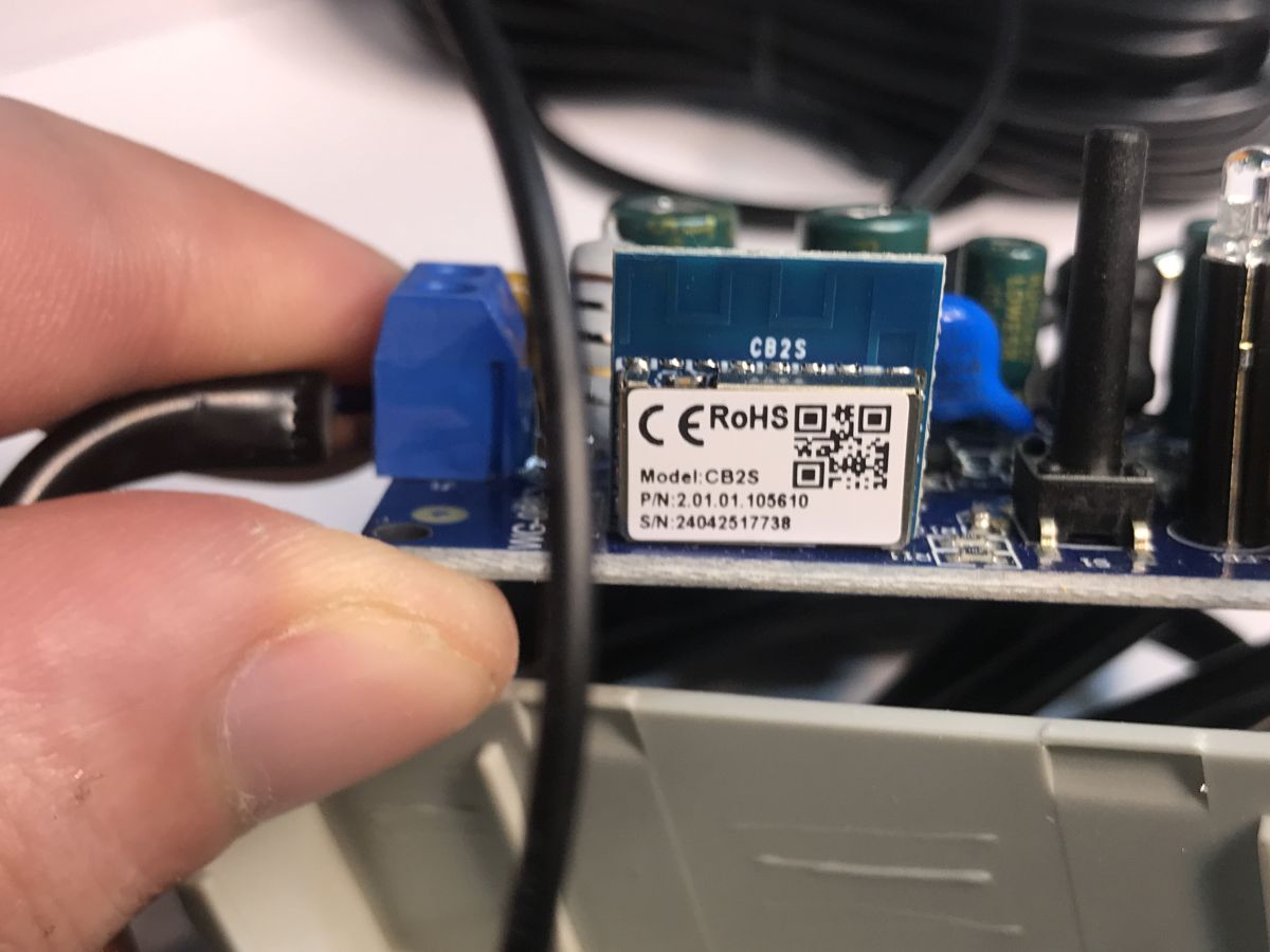

    WiFi module, or CB2S (BK7231N):
    Close-up of the CB2S module on a controller PCB, showing model label and CE markings. Close-up of the ATLO-GDC2-TUYA garage door controller PCB with visible components, including the CB2S module. .
    OBK can be uploaded to it: https://github.com/openshwprojects/OpenBK7231T_App

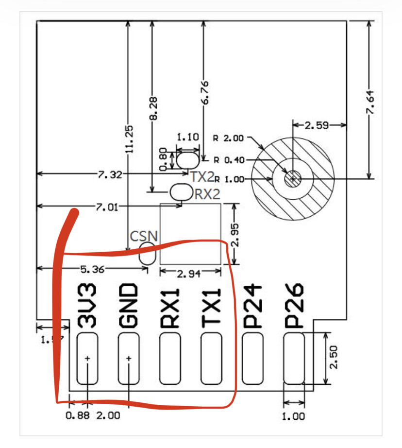

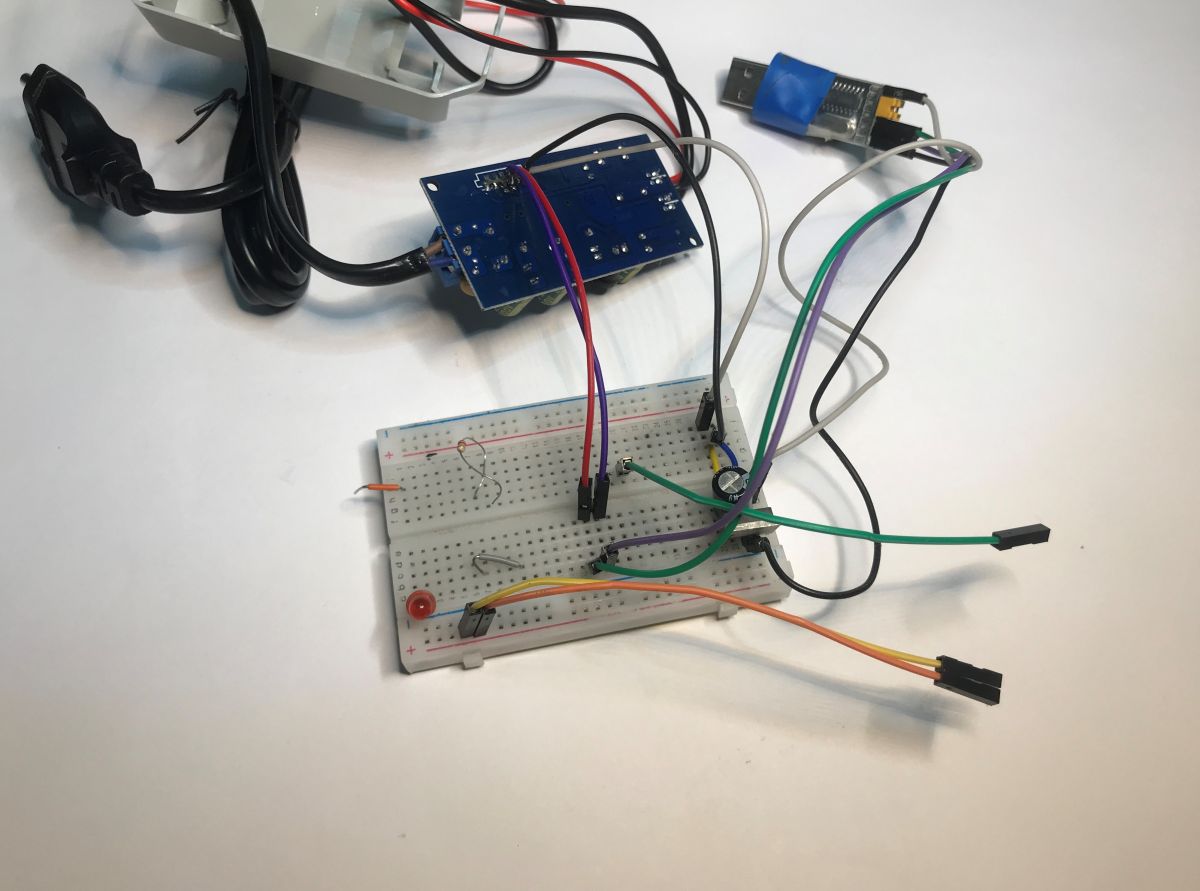

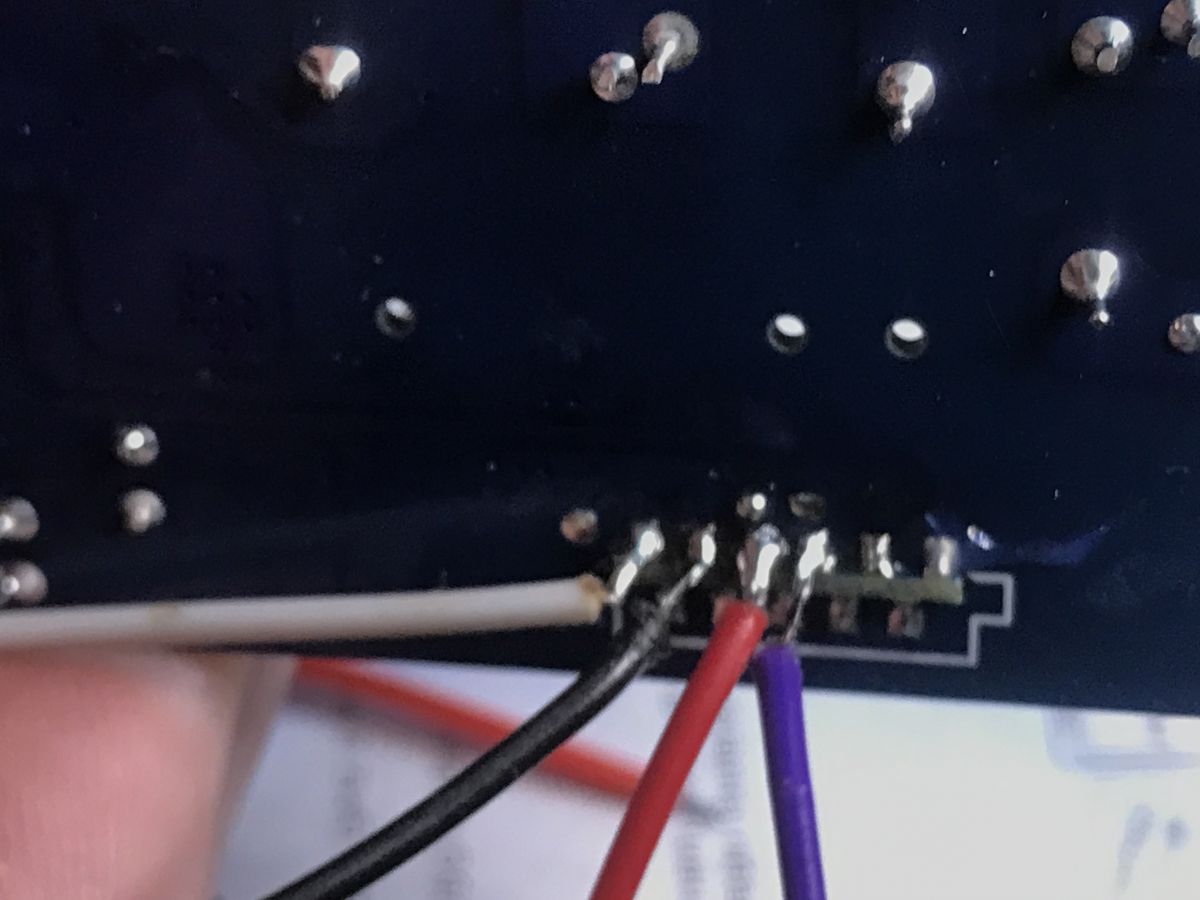

    We solder the four wires - RX, TX and GND and the power supply (3.3V):
    A section of a PCB diagram highlighting the 3V3, GND, RX1, and TX1 pins needed for programming. .
    Close-up of the bottom side of a PCB with four soldered wires: white, black, red, and purple. .
    Here is my whole circuit (with a 3.3V supply, as the device cannot be connected to the mains normally as its power supply does not provide galvanic isolation.... one could make a short circuit and damage the computer).
    Breadboard with connected wires, ATLO-GDC2-TUYA garage door controller, and USB-UART converter on a white background. .

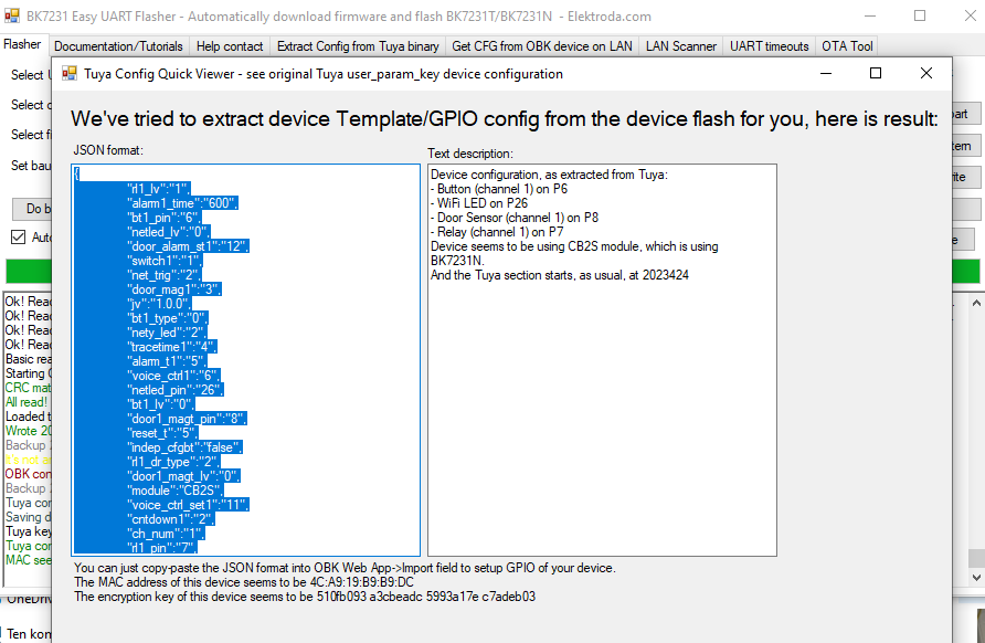

    The mentioned flasher allows to first read the manufacturer's batch and then upload the OBK. In addition, it detects the GPIO configuration:
    Screenshot of the BK7231 Easy UART Flasher program showing extracted device GPIO configuration in JSON and pin description. .
    Tuya configuration:
    You can now use the template converter:
    https://openbekeniot.github.io/webapp/templateImporter.html
    OBK configuration:
    Verbal description:
    Device seems to be using CB2S module, which is BK7231N chip.
    - Relay (channel 1) on P7
    - WiFi LED on P26
    - Door Sensor (channel 1) on P8
    - Button (channel 1) on P6
    Now you can already freely configure the GPIO as required and/or connect the device to the Home Assistant ( tutorial ). It doesn't have any pre-made interactions at the moment, so it's up to us to decide where and how we script it - it can be done in HA, or in OBK too, via obk or Berry scripts:
