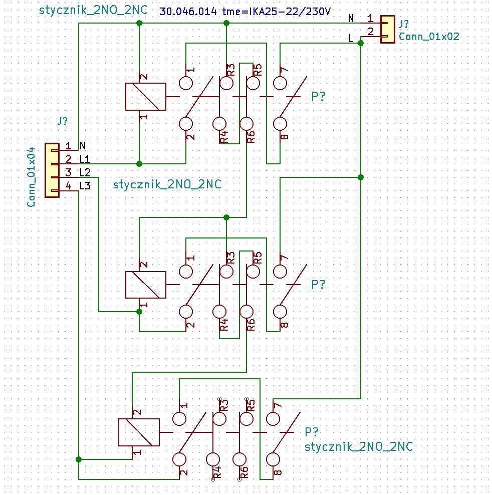

Can I replace an automatic phase switch with cheap contactors so the load automatically changes to another phase when one phase fails?
No—contactors alone are not a reliable replacement; use a dedicated automatic phase switch, because a failed phase can still sit at around half voltage and the contactor coil may not drop out, so it will not switch over [#18293557][#18296190] Automatic phase switches are designed for uninterrupted changeover and can switch when voltage falls below about 195 V, which contactors cannot do in this situation [#18290377] The thread also notes that a DIY contactor solution would need proper interlocking/auxiliary contacts to prevent two phases from being connected at the same time [#18290492] Even then, this kind of home-made setup is considered risky and more trouble than the ready-made device [#18295526]

    An automatic phase switch costs from PLN200 and handles up to 16 A. Above 16 A you need to give contactors + phase switch. This would cost me 300 zł.
    I thought that maybe instead of playing around with an automatic phase switch, wouldn't it be cheaper to buy contactors ( at a cost of 20 zł ) with different states ( open and closed) and do the switching on them? I'll blow a phase then it will automatically switch. What do you think?
    The only disadvantage would be that I would only have one emergency phase in case of switching with two contactors.

    To the author on contactors it is possible, but it is necessary to use contacts so that there is no
    It is possible to use contactors on contactors, but it is necessary to use contacts so that it is not possible to switch two or more phases at the same time. For this purpose you can use
    auxiliary contacts.

    Where do they sell contactors so cheaply that have more than 16A from a relay?
    ww.tme.eu/en/details/ika25-22_230v/contactors-modules-glow/iskra/30-046-014/
    this one costs 63zł.
    And here is my suggestion: Automatic Phase Switch vs. Contactors for 16A+ Load Management? .

    Janusz_kk wrote:
    And here is my proposal: Automatic Phase Switch vs. Contactors for 16A+ Load Management?
    Oh I wouldn't be so sure about this arrangement
    When applying power before contactor L1 cuts off N to the coils of the other contactors, what will contactors L2 and L3 do ?
    Once it has cut the N to the coils of the L2 and L3 contactors, won't they have any "desire" to work "interphase"?

    Always from a simple matter, colleagues are able to complicate everything to the maximum. There is a problem? There is a special solution. What else is there to look for? There are ready-made systems for this, not home-made constructions that pose a danger to people, animals and property. Apparently, what do we wear on our hands? A watch? What for? To tell the time. How about something else instead of a watch. And these examples can be multiplied at will. There is an automatic switch that operates without interruption, so we use it.
    We have an L1 phase. Phase L1 disappears and we have 150V instead. However, the contactor does not switch phase L2 because L1 did not let go. Not together that on day three there was 120V and the fridge was still running.

    elezibi , I don't suppose you suspect that colleague Janusz_kk was so unreasonable as to propose an untested solution? This can be checked by assembling the layout.
    bumble , we are already like that, we do everything to complicate our lives.
