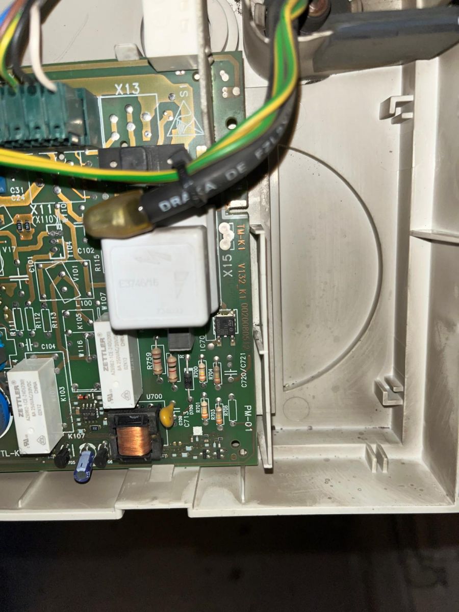

    If I understand correctly, it is removed.
    • Vaillant EcoTEC Plus F27 Error: Flame Sensor Issues & Troubleshooting (VC PL306/3-5) IMG_20230425_110427201.jpg (4.22 MB) You must be logged in to download this attachment.
  • #32 20554599
    Jabbi
    Posts: 36
    Thank you very much. I pry the black cover from the bottom near the plate and it doesn't go up. I apologize for perhaps a naive question, but should I pull the cables from above, i.e. above the black cover - the cables should come out of the cover and it should remain, or maybe the cover comes out with the cable?
  • #33 20554601
    Adewag
    Level 21  
    Posts: 1080
    Help: 36
    Rate: 249
    I pulled the cable and the plug hard at the same time. There is a hole for the "tab" and it locks.

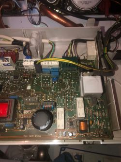

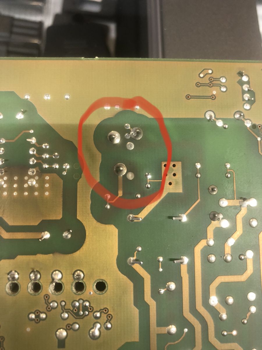

  • #36 20554692
    Jabbi
    Posts: 36
    Thank you for the info. I grabbed the pliers for the plug and it came out without a problem. Is it possible that this large 400 capacitor is 3-leg?
  • #37 20554823
    Adewag
    Level 21  
    Posts: 1080
    Help: 36
    Rate: 249
    That's what you see in the photo. Twice the mass.
  • #38 20555545
    Jabbi
    Posts: 36
    So one with 3 legs, so a bit different than what was written before? Do you know why I have another?
  • #39 20555745
    Adewag
    Level 21  
    Posts: 1080
    Help: 36
    Rate: 249
    It doesn't matter, it's the capacitance and voltage that count.

    Jabbi
    Posts: 36
    Successful boiler fixed error disappeared. Cost PLN 2.70 for two smaller twin capacitors that had to be desoldered by inserting new ones. The big one turned out to be functional and stayed in place. Thanks to everyone who posted in this thread, it was worth a try.

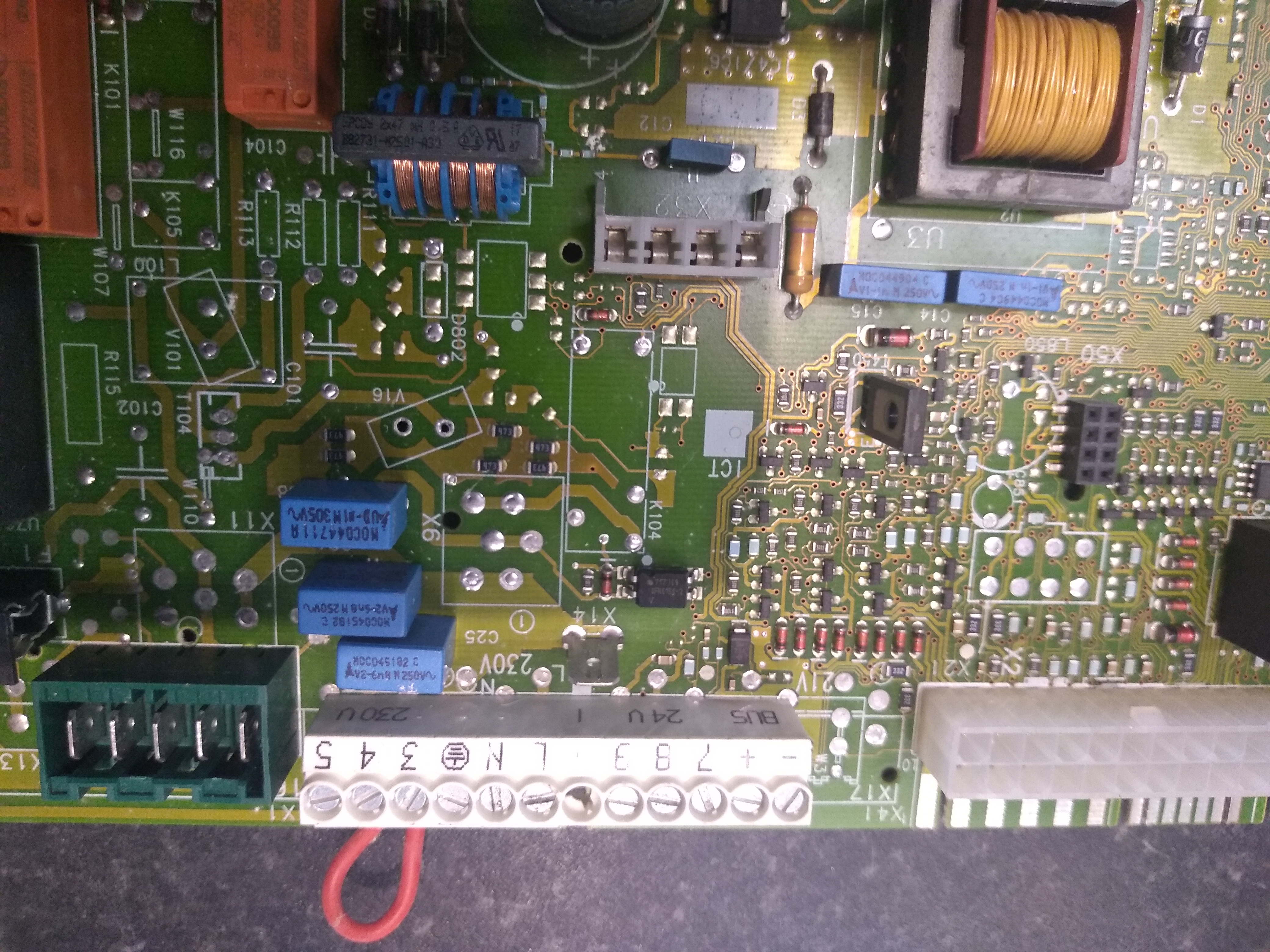

    Hello, I am reviving the topic.
    In my case at the service, the boiler after opening the chamber has not been cleaned for probably 8 years...
    so first cleaning and maintenance. . then checking the coils on the gas valve. Tomorrow I'll check the capacitors suggested here. I'd have to check the connections as it's clearly a lack of voltage at the spark generator.
    i attach the board symbol
    Close-up of a circuit board in a device with visible wires and electronic components. .
  • #49 21434896
    EkoGrzew
    Level 20  
    Posts: 431
    Help: 28
    Rate: 231
    The boiler will live. The two capacitors mentioned here on the test are good, but after measuring one 100 ηF above nominal value and the other 100 ηF below nominal value. Replaced. Also checked other paths, soldered capacitor, cleaned, .
    After fitting everything, the boiler returned to operation.
