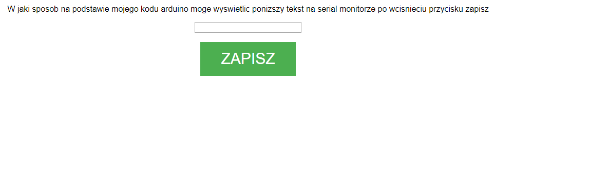

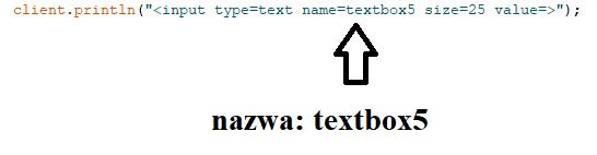

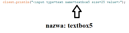

    I would still just need if anyone knows how I can put what I type in the Textbox into a string type variable on the arduino. I have code like this:
    Code: C / C++
    and this is what the 192.168.4.1 page looks like
    How to configure WiFi on Zamel switches via ESP8266? .
    If I understand correctly the name of this textbox is textbox5:
    and now how can I send text from a textbox instead of what I have highlighted in red?
    I would like to use several textboxes and send texts from all of them, something like:
    Code: C / C++
    , where later I would already split this text into individual strings in the arduino.

    #8 18348166
    ex-or
    Level 28  
    Posts: 785
    Help: 147
    Rate: 151
    You need to put all the input tags (three of type text and one submit) in one form. See for yourself an example: https://www.w3schools.com/tags/tryit.asp?filename=tryhtml_form_submit
    Of course, you also need to modify the ify decoding the response because at the moment the program only expects one parameter in the response and receives three.
  • #9 18348796
    madiz08
    Posts: 517
    Rate: 172
    Actually works, thanks :) .

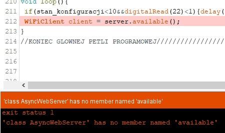

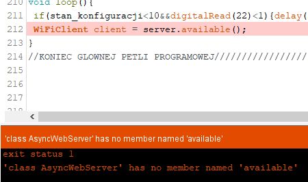

    In the example below, I have already managed to create a transition into configuration mode, like an access point, where I can enter a name, wifi password and other parameters. If I enter them, the ESP32 resets itself and enters the operating mode where it already connects to my wifi network and additionally the PLC:
    Code: C / C++
    The next step I would like to do is to be able to send commands from a browser or application, where for example sending 192.168.0.85/H will cause an LED to light up for now. Previously when I did things like this I used :
    Code: C / C++
    However, when adding something like this to my current code it causes compilation errors telling me that :
    For the AsyncWebServer library, how can I write a read of what came from the client, and then against that perform the given actions?

    Perhaps I should ask the question differently:
    The problem is that I would like to use in two different libraries in different cases, and I declare all of them at the beginning.
    1. as after turning on the ESP32 I am in configuration mode and I want to enter parameters from a page put on the wifi network of my ESP32 I use ESPAsyncWebServer.h
    2. as after switching on the ESP32 is in normal operating mode, i.e. it has connected to my wifi based on the parameters previously entered in configuration mode, I would now like the ESPAsyncWebServer.h library to no longer be taken into account and not affect compilation errors WiFiClient client = server.available();. At this point, I would like to use the standard wifi.h library only
    The dependency of whether I am entering configuration mode comes from reading EERROMread(0). If the value of this byte is <10 then I am in normal mode, otherwise in configuration mode
    Is it possible to use one or the other library depending on the condition, or can they somehow be changed for such a need?

    Initially, I depleted the code to enter only the configuration mode:
    Code: C / C++
    and as such I tried to modify it so that the whole thing was in the configuration function.
    At first I tried to move the HTML page there, without success, but after commenting out the libraries and what's in the config function the compiler didn't throw me any errors for the HTML build, also I guess it could stay that way?
    How to issue function_config mode() only executes once, so the do-while loop is empty
    I finally got around to transferring the libraries. At first I simply tried it this way:
    Code: C / C++
    When I paste the entire contents of a library instead of the library in question, every now and then compilation errors occur for the absence of various other libraries
    Could you guide me how to declare the local variable 'server', maybe that is the problem

    madiz08
    Posts: 517
    Rate: 172
    Works!!!!!!!!!!!!!!!!!! :) .
    Regarding the looping thing, I'm well aware of the no-networking, I just did it as a test so that I don't leave that mode.
    That is, #include always at the beginning of the code, and I gave AsyncWebServer server(80); in the config function.
