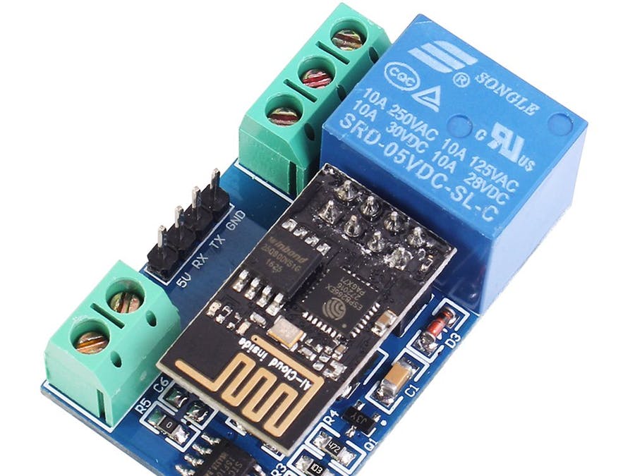

How can I program this ESP8266 relay module to switch a light on and off with SUPLA?
If this is that relay board, don’t try to drive the relay directly from GPIO2 or GPIO0, because the ESP8266 communicates with an STC15F104 over UART and the STC chip actually switches the relay. Use the configurable “InCan Easy” firmware as the SUPLA base, then set up the module yourself and it should connect to your registered SUPLA account after configuration [#17820996][#17821090][#17821096][#17821100] For the relay itself, send hex commands over serial at 9600 baud; examples given were `A00101A2` to open the relay and `A00100A1` to close it [#17821547][#17821826] If you already have working SUPLA code, replace the usual `digitalWrite()` relay control with `Serial.write()` of those bytes [#17821826]

    I have such a relay with wifi and I don't know how to program it under SUPLA to switch the light on/off.
    All the ESP programming and control e.g. via domoticz is by wemos and a separate switch on GPIO.
    Here the GPIO does not work, and a request for where to get the software for this ESP to control the relay from?
    Thanks but I can't find the right software anywhere.

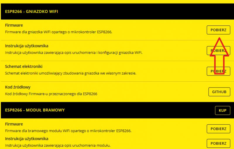

    Check it out: Link "InCan Easy" is quite versatile software with configurable features. Author: Espablo .

    Ok, all in all I found such a module in the cupboard with everything, after all it would be enough to short GPIO 0 or 2 to GND without the ESP8266 module and everything would be clear. But on my board these pins are not connected to anything. Instead, there is a stc15f104 chip, which is a separate MC and connected to the ESP via UART, the ESP sends it the appropriate message, and it turns on the relay. Now all you have to do is find what message it is and there you go. Here is a Soviet technical solution to the problem: https://www.youtube.com/watch?v=f8kW5INQMPU :D . There are also more civilised solutions https://www.hackster.io/makerrelay/esp8266-wi...nnel-relay-delay-module-iot-smart-home-e8a437, the commands are something like "A00101A2 open relay, A00100A1 closed relay, command format must be hex".

    It is communicated differently, but it works quite simply, just send these hexes to a serial set to 9600. If you have another ESP you can check if the relay clicks with this code, "it works for me":
    Code: C / C++
    Unless you don't need the original software anyway, and I don't know where to get it from. But all in all it's trivial, it receives a command from the server and simply writes that code on the serial to turn the relay on or off. If you have something working from the supla then just replace the digitalWrite() type commands in the code with Serial.write() from the example above and it will be the same.

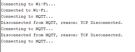

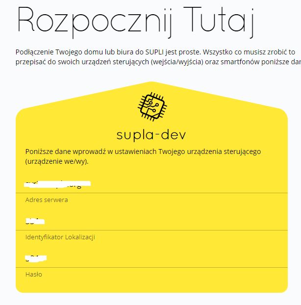

    I would like to refresh the topic slightly and refer to the example provided by khoam .
    Could you please explain to me what is the following data that needs to be filled in:
    Code: C / C++
    I recently bought two modules from Zamel, I am logged in on Supla.org, or rather I have my account there. Is mqttUser my login and mqttPassword the password from supla?
    I've tried typing that in. My ESP8266 connects to my home wifi but does not connect to the server
    Light control via ESP8266 relay with SUPLA - how to program? .
    I don't know how to check the server ip, port number and I also don't know what mqttQos is
    is that what needs to be put in there?
    Added after 1 [hour] 55 [minutes]: .
    Okay, I get it. the configuration can be done completely outside of the arduino. I downloaded the files from the beginning of the topic and uploaded this to my Node MCU 1.0 ESP-12. After typing 192.168.4.1 I entered all the data but you can see that the LED doesn't light up permanently when the esp8266 is switched on again, just flashes every so often, so I guess it's not making the connection. . Are there any current supli files that I should play through nodecu firmware programmer?

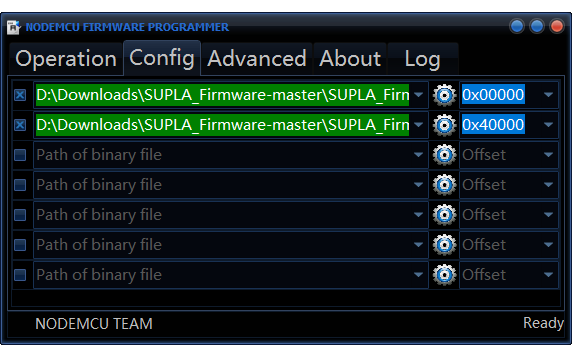

    Then could I ask you for the corresponding BIN files to podegrate to my ESP8266? When I tried the ones from the supli website, nothing happens, when I tried the ones from the beginning of this topic, it detects my wifi network, on 192.168.4.1 I can enter settings and save. After restarting the ESP no longer connects to my wifi. As with zamela products, the light does not come on all the time, it just goes off every 2 seconds or so, which I guess is when it starts looking for a connection again.
  • #22 18335778
  • #23 18335807
    madiz08
    Posts: 517
    Rate: 172
    Yes, I clean the flash by uploading blank_1MB.bin .
    As for the supli files, I downloaded these:
    But after loading them and turning them back on, nothing happens. No wifi network appears
  • #24 18335816
  • #25 18335817
    madiz08
    Posts: 517
    Rate: 172
    Light control via ESP8266 relay with SUPLA - how to program? wrgrwam wifisocket_eagle.flash for address 0x000 and wifisocket_eagle.irom0text for ardes 0x4000
    on the above settings
    Ok, I'll download it right away

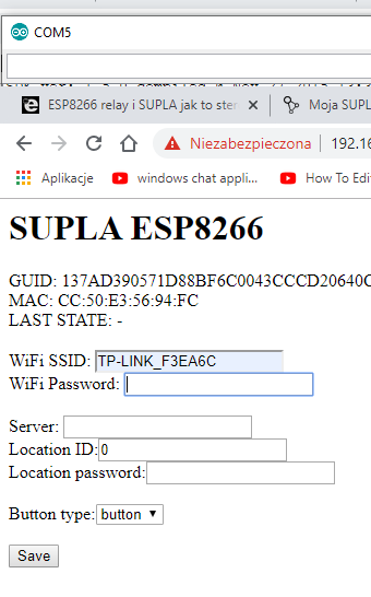

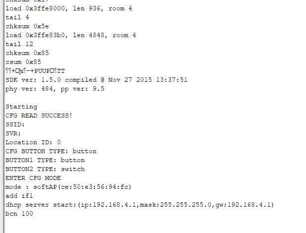

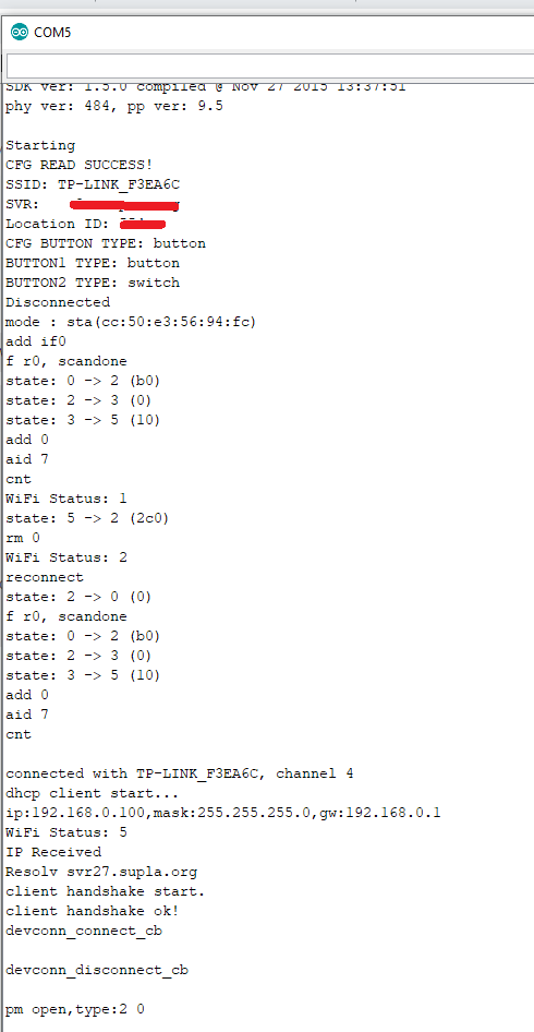

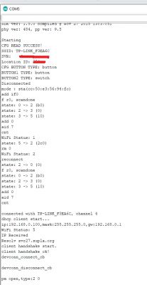

    Added after 12 [minutes]:

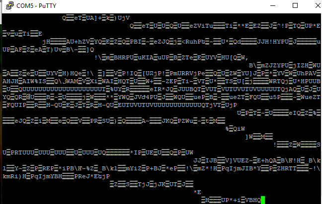

    Unfortunately I get the same bushes, regardless of the selected speed. I've never used this putty, but I think I only set the serial, COM5, and speed there, I've tried, 115200, 9600, 57600 and still the same thing
    On the Serial monitor of the Arduino the same thing. When I played the Arduino code, both on Serial monitor and on putty I got the same, I mean already correct messages
    Added after 21 [minutes]:
    I have now checked on speed 74880 and have the above.
    Aj, sorry the open wifi network came on after a while and it just didn't cause the LED on the ESP to glow, and could you tell me if it's ok based on that?
    because neither in the app nor on the website do I see the new device
    In the open wifi configuration there was something like this:
