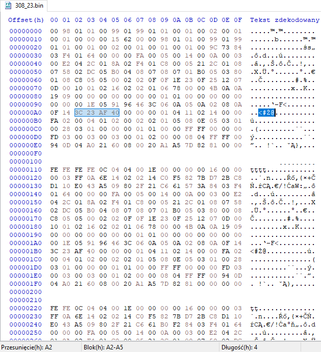

  • PIN migrates with VIN area swap in BSI
    #35 18389835
    glapsson
    Electronics specialist
    Posts: 557
    Help: 11
    Rate: 645
    It depends which ...
    What do you have in identifying this new BSI?
    sees VIN?
    if so, anyway, to add the keys, you must first make virgin and tap the PIN that was originally for the keys
    of course, I understood you correctly that the leg fell off this original prock from this car ...
    Just figured out the mileage change
    Of course, it is about the legal need for corrections when replacing the BSI
    AND calculating a mileage checksum for the BSI
    continental
    EL5
    FL3
    Added after 2 [hours] 51 [minutes]:
    I once asked about this:
    glapsson wrote:
    Well, it's from a different barrel.
    Question for mathematicians and programmers - but still on the topic of BSI (N0x)
    I blurred VIN because nobody needs it for anything
    I marked the area with the read PINs under the VIN number
    I will add that the exchange of these areas between BSI makes the PIN migrate in full
    Of course, I have a facebook what counts it from the machine, but the question arises from curiosity - HOW is it counted?

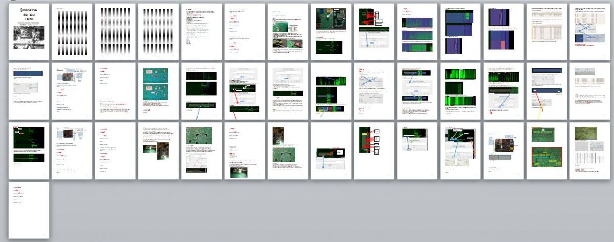

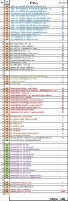

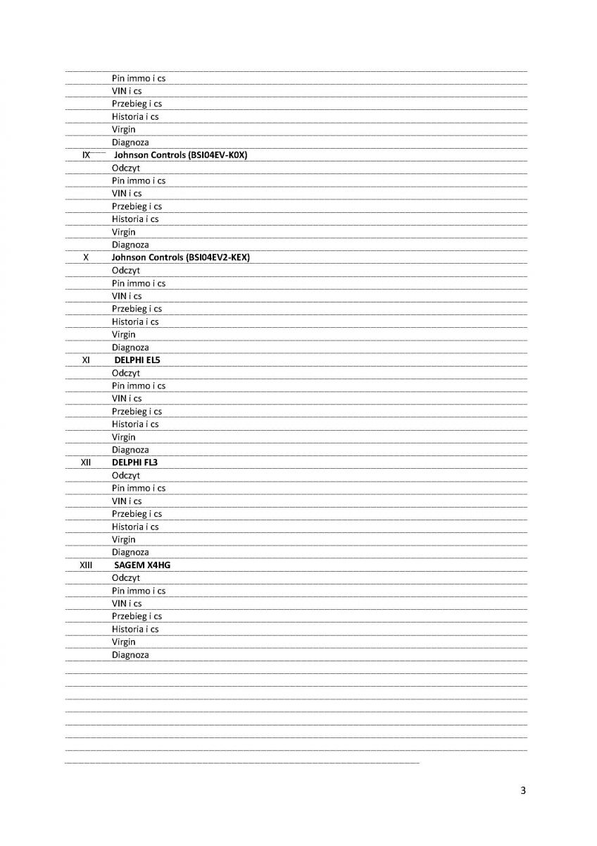

  • #49 18526530
    glapsson
    Posts: 557
    Help: 11
    Rate: 645

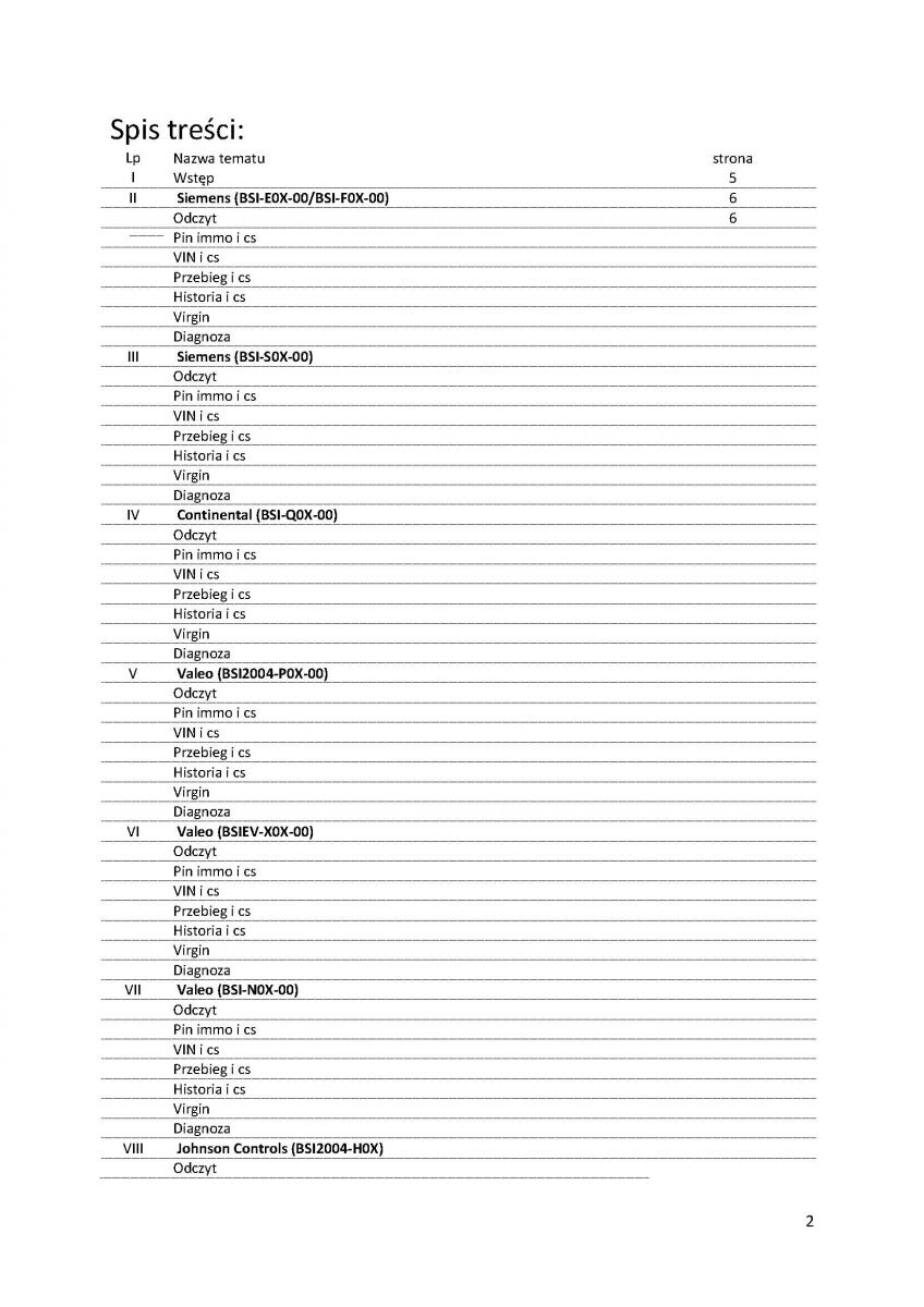

    I mobilized and started work on the BSI instruction for the PSA group
    here are the beginnings and table of contents how it will look like.
    promises to be in the coming days that he will come to stay at home, so it should not take too long.
    so far completed
    Valeo nox full
    continental full
    Delphi EL5 partially
    Delphi FL5 partially
    Sagem partially
    Title: How to Read EEPROM BSI DELPHI EL5 in Picasso II, C3 III, Aircross & Similar Models Title: How to Read EEPROM BSI DELPHI EL5 in Picasso II, C3 III, Aircross & Similar Models Title: How to Read EEPROM BSI DELPHI EL5 in Picasso II, C3 III, Aircross & Similar Models
    I wonder if there will be a demand for such materials ...... ??

    Nice job full of respect. When you have a ready, I will be happy to buy it.
    You have to respect someone else's work and you have to cost it too.
    I translate a bit of GB to EU, as for me, a bit of digging in BSI batches in new 19-20 year cars and a bit not profitable, time-consuming.
    The customer wants well it pays for online and has everything as the factory commanded.
    But if the corpse comes, sometimes you have to put up a new BSI, then it will be useful.

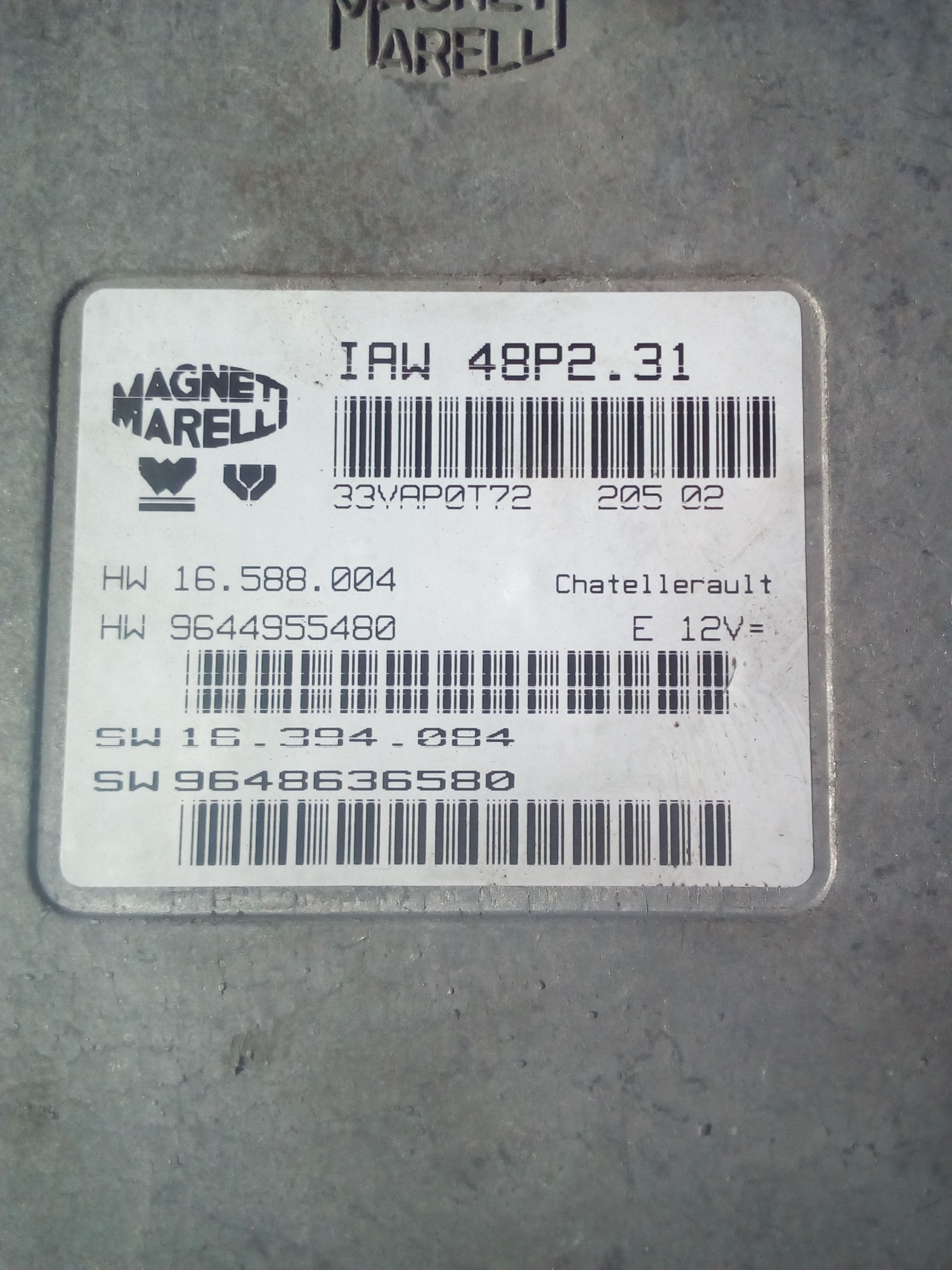

    Rate: 645
    You're not helping ...
    This will be the fastest
    VIN
    Nuery of the original BSI - sticker photo
    Engine controller numbers - sticker photo
    What about this pump - do you stay or did you replace?
    What was the damage .. what was flooded what have you already replaced - what was the nature of the repairs already performed?
    You know to help you, not everyone has time to run around the whole thread and look for individual entries,
    I started the topic, I know what it is - but I already asked about the ECU and you did not give an answer.
    If you say so that help is needed, then 100% information in one place is necessary.
  • #56 18532036
    GORO35
    Posts: 180
    Rate: 11

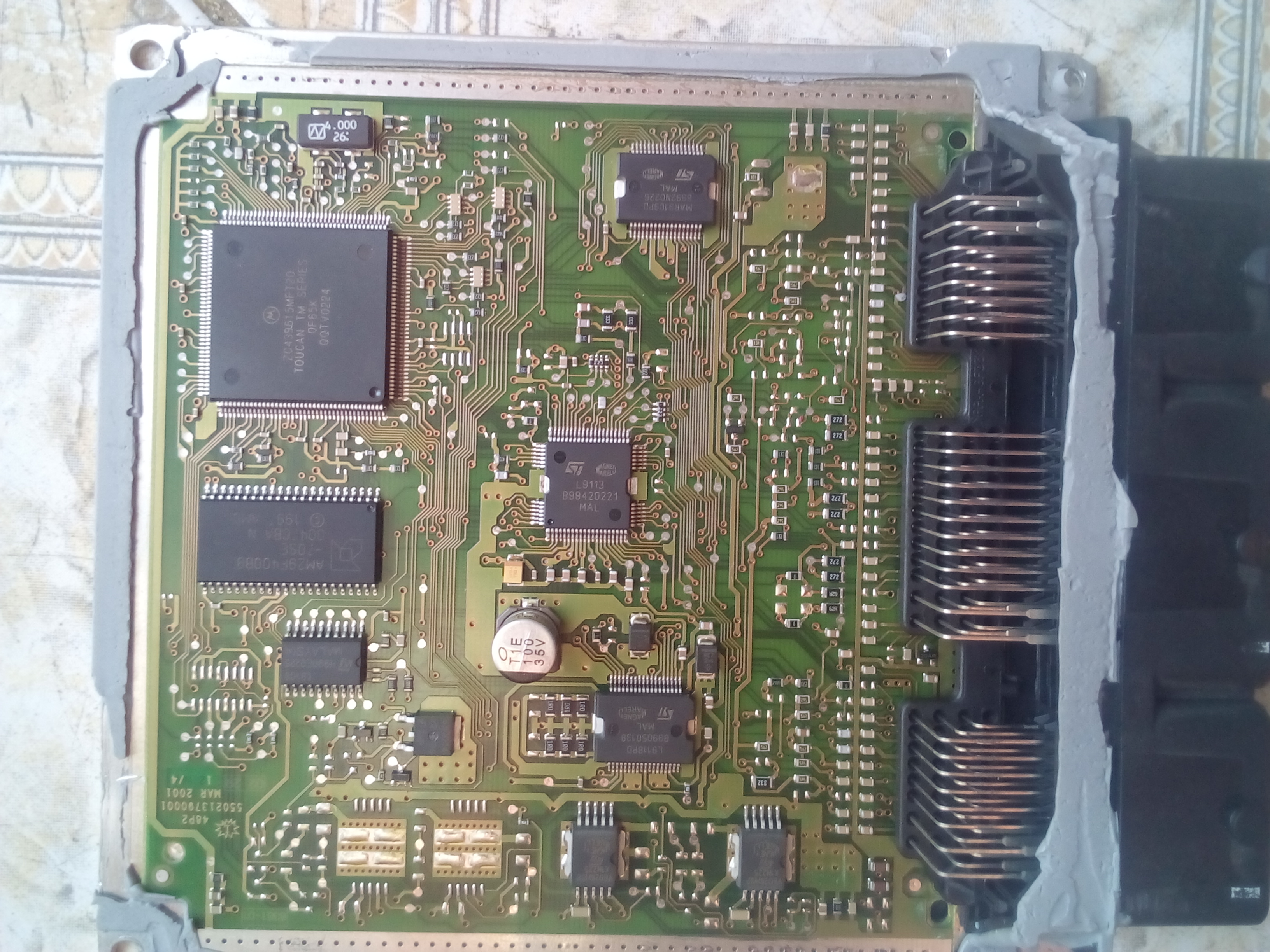

    First, thank you glapsson for taking up my topic.
    The car is Citroen C5 year 2002, engine 2.0 16v 136ps.
    BSI "LEAR BSI T04-00 PSA 96 474 482 80-IH 00-IS25.20-220702-5064169
    VIN NO VF7DERFNC76335790
    Unfortunately, because of my lopsided hands and stupidity, I damaged the original processor from BSi. I only have Eeprom. I have carprog and lexia, but so far I'm in the woods. I also send photos of the sticker from the ECU.
    • Title: How to Read EEPROM BSI DELPHI EL5 in Picasso II, C3 III, Aircross & Similar Models IMG_20200315_103550.jpg (2.19 MB) You must be logged in to download this attachment.

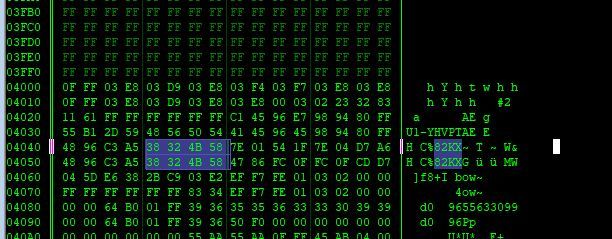

    To get the PIN you must read the FLASH memory (29F400BB)
    These cheaper programmers:
    LPT
    willem plus a stand
    UFP6.3 plus stand
    USB
    wellon plus stand from mod vp390 up
    TL866 II plus - plus stand
    and other more expensive ......
    Or helping someone to read it.
    IMMO OFF option also possible - but here unfortunately also flash reading and programming and immo line cut necessary.
    There will be no action of the pilots - so it is better to fix the system.
    Below is an example of a different batch and PIN location
    The PIN is public
