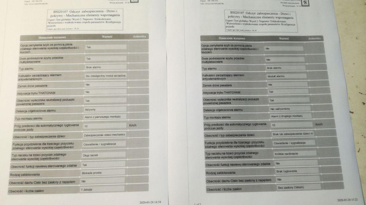

    I will also add that it is possible to telecode secured BSI, i.e. with online coding.
    This is not in this manual, but the plan is to extend the descriptions.
    The description will be general due to the multiplicity of software included in BSI
    but You can change the parameters in the field of configuration.
    of course, if someone decides on the instructions now - it will receive updates with the description of the configuration for free.
    Later, the price of the manual will definitely change.
    The telecoding is manual, it consists in changing bytes - and compulsorily counting the checksums of the configuration areas that I will describe.
    Below is a sample of changes made without online but it works.
    Title: How to Read EEPROM BSI DELPHI EL5 in Picasso II, C3 III, Aircross & Similar Models
    Feel free to contact PW
    Telecoding in secured BSI is a very complex topic
    and due to the lack of interest (no one even asked because maybe - the topic is difficult and an inexperienced person can kill a BSI or something in the car)
    It won't be in the manual ... because I don't want to be held responsible for someone else's mistakes.
