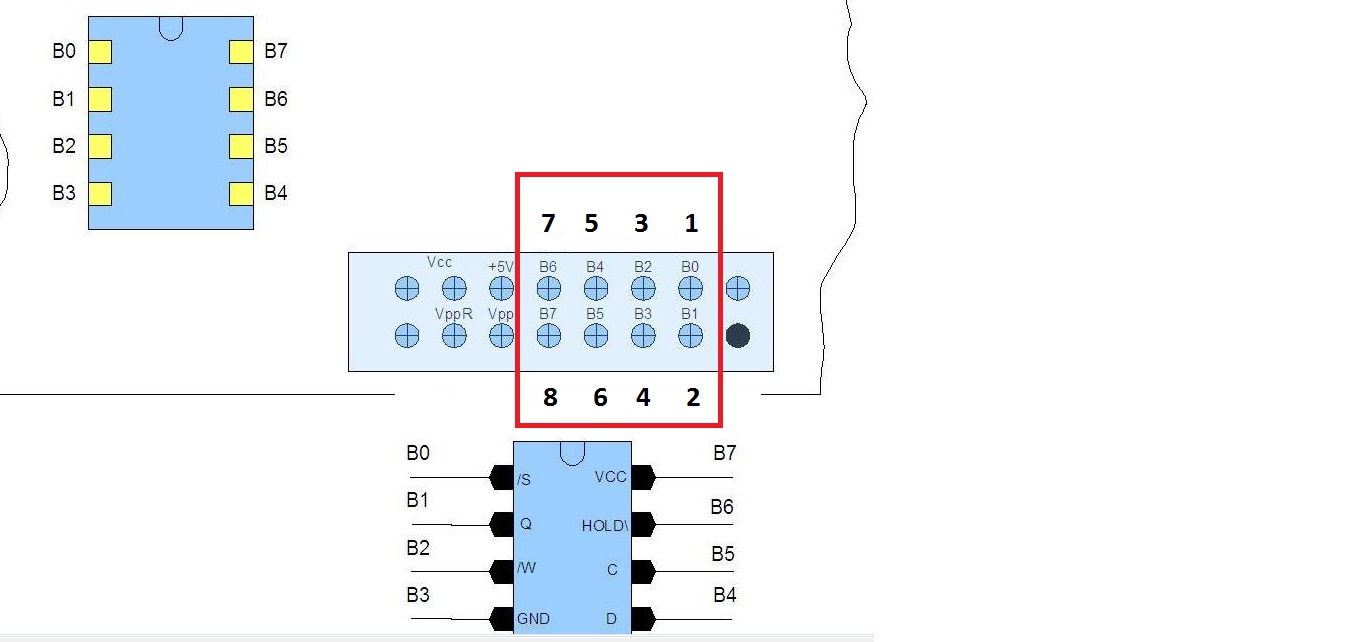

    Below I present the readout of the eeprom BSI EL5
    used in the new CItroen models
    For example Picasso II, C3 III, Aircross and probably others.
    I made the reading with UPA-s
    but it was not without its problems.
    BSI was purchased on a popular auction site and, unfortunately, in the first phase, despite the correct connection, there was no data in the reading - only FF
    After separating the boards and desoldering the 95128 chip, I got the data
    It is also interesting that in the diagnostics on the table, the processor clearly did not load eeprom data (i.e. VIN and coding), there were question marks in the place of VIN number.
    It was possible to enter the VIN and it was active but only until the power supply was disconnected - i.e. the processor did not program the eeprom either.
    After many different attempts, the decision was made to replace the eeprom memory with the new 95128
    At this point, the BSI recovered.
    The UPA read all the data previously read outside the system very nicely after the pads.
    You can perform eruptive reading operations, erase clones after BSI pads without dismantling the discs.
    I do not know why this was the eeprom state ..... maybe it is a protection against reuse .... I will still test it.
    It is a pity that the first reading could not be made in the system, but some came from the car after a specific crash (checked after the VIN read, the car is described as dead and in the photo you can see that on a specific roll)
    There is an inscription on the BSI housing: Do not use if dropped
    Maybe it has to do with eeprom blocking ... or maybe it's an accident or someone on purpose.
    I throw in the connection for UPA and PINOUT BSI for diagnostics on the table.

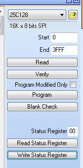

    I will only add that I have read and programmed in the system using the UPA as 25C128
    for a simple reason - up 95128 is not included in the set

    I developed the pads myself
    I disconnected the plates and measured the legs of the memory .... it is a simple operation and requires no secret knowledge.

    The UPA also has status options
    Title: How to Read EEPROM BSI DELPHI EL5 in Picasso II, C3 III, Aircross & Similar Models
    Maybe it is blocking work in the system .....

    I made a PCB design so as not to solder in the system
    Eagle design
    Standard plate with BDM frame
    I changed the position of pin 6 (UPA - 2) in this project
    I have sent the order - not tested yet, I am waiting for the PCB
    Printing on the foil pins compatible
    Maybe I will force myself and test something myself ... but I don't feel like it
    I etched the test plate.
    Due to the use of a single-sided plate - printing on the reverse side
    so that it is easier to solder the socket and that the pressure of the needles does not tear the pads off.
    Everything works as it should

    Reading test in the system:
    BSI EL5 reading in the system:
    UPA 1.3 - does not read (voltage drop from 4.75 after connecting the system to 3.72V - power supply error
    Xprog M- does not read (reading only FF)
    Carprog- does not read (without 00 power supply, with FF power supply)
    SEEPROG - reads OK
    VELLON VP390 - reads OK
    UPA-S- reads OK
    BSI FL3 reading in the system:
    UPA 1.3 - reads OK
    Xprog M- reads OK
    Carprog- reads OK
    SEEPROG - reads OK
    UPA-S- reads OK
    And as you can see, it's supposed to be the same, but not.
