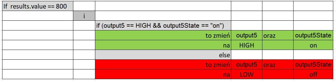

    khoam wrote:
    Draw up a simple table and write what you want to get depending on the states of the variables: results.value, output5State and output5.
    Why doesn't the Arduino ESP8266 code change the LED state when IF? .
  • #12 18394392
    krzysiek_krm
    Level 40  
    Posts: 4612
    Help: 716
    Rate: 599
    Look at the table, once the condition is met you "change" the HIGH/on to HIGH/on, something that makes no sense.
    I understand that you want to change the condition to the opposite i.e. HIGH/on to LOW/off and vice versa.
    Or just negate the tag and "send" its value to the output.
  • #13 18394463
    maystero
    Posts: 1011
    Help: 58
    Rate: 205
    So if I understand you correctly - it should be like this?
  • #14 18394488
    krzysiek_krm
    Level 40  
    Posts: 4612
    Help: 716
    Rate: 599
    In my opinion - yes.
    Besides, I think that the study of two conditions (logical product) is redundant.
