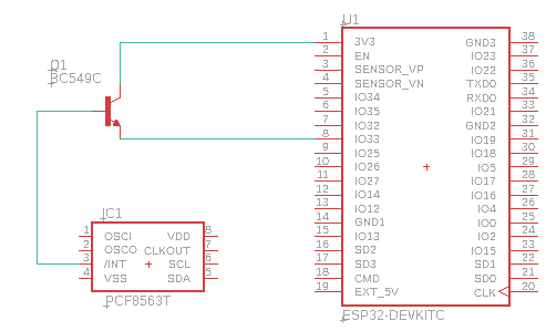

    Tell me if it is possible to connect the interrupt (alarm function) of the PCF8563 to an ESP32 input accepting a high state ?
    The PCF8563 from what I have read only has "open drain" on the interrupt and I already have the input on the ESP32 set to wake up via a high state on the input.
    I can't really change this, can I use some transistor e.g. to have a high state there instead of "open drain" ?

    Yes, a simple NPN transistor

    Ok, I'll check but I thought NPN required a power supply at the base.

    yes requires, e.g. a 10k resistor from the base to the + supply. Likewise, give a resistor from the collector to the + supply of the ESP.

    pawlik118 wrote:
    this requires, for example, a 10k resistor from the base to the + supply. Likewise give a resistor from the collector to the + supply of the ESP.
    ok, but I can't connect it like that because INT PCF8563 is open drain, or do I understand it wrong ?

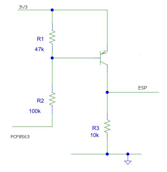

    Connect the PCF output from the ESP32, and add a resistor from the PCF output = ESP32 input to the + supply (10k). The resistor will then force 1 when the PCF output is in a high impedance state. You can do it like this, or like the diagram above. The difference is only in the inverting or not of the signal.

    Rigs, option with transistor (0 during operation, 1 interrupt) works.
