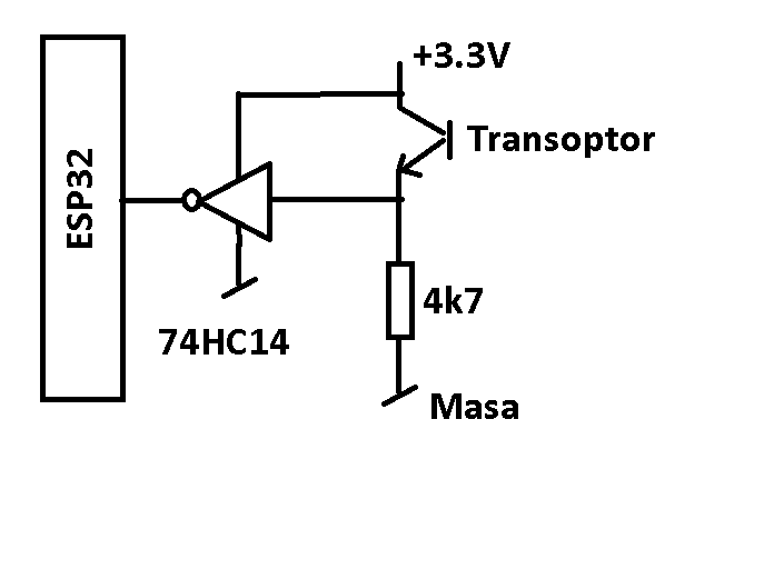

    Hello, as in the subject, I have a problem with the detection of an interrupt from a PC817C optocoupler.
    The voltage is 3.3V and I have the emitter of the optocoupler (leg 3) connected to the ESP32 with the GPIO35 pin,
    with an external pulldown in the form of a 10K resistor Ω connected to GND.
    I have set this pin as INPUT and the interrupt mode as FALLING.
    The ESP32 detects the interrupt but it is not synchronous, and mostly detects double.
    My ESP32 is a DevKitC ESP-WROOM-32U.
    No problems with the Arduino UNO, it detects correctly,
    But the ESP32 seems to have faster sampling at a higher frequency than the Arduino UNO.
    I think the ESP32 pin voltage of 3.3V is not a problem, as the Arduino UNO has a pin voltage of 5V.
    I tested on my little oscilloscope and at 2V and 10ms the signal is rectangular and varies from 0.16V to 3.2V,
    and when I decrease the time the signal looks more and more like a sine wave,
    when I add a larger resistor the signal sharpens but the voltage floor rises significantly,
    and when I decrease the resistance the signal rounds off and looks more like a sine wave.
    In the function called by the interrupt I have added a check to see if there is a low state on the pin:
    Code: C / C++
    This caused me to no longer detect interrupts doubly, but they are still not synchronous.
    I ad hoc solved the problem softly with code like this:
    Code: C / C++
    Is it possible to somehow improve the signal so that at higher sampling frequencies i.e. less time it is more rectangular, and so that there are no problems detecting the interrupt during the descent?

    It seems to me that you would help yourself a lot by inserting some simple gate ( inverter ) with Schmidt input between the optocoupler and the ESP input. This should improve the shape of the optocoupler signal.
    In general, optocouplers are very slow compared to processors and other modern circuits, so you can expect good results from such a treatment.

    I think you would help yourself a lot by inserting some simple gate ( inverter ) with Schmidt input between the optocoupler and the ESP input. This should improve the shape of the signal from the optocoupler.
    And could you give me some schematic of how to connect this and what gate model to give?
    And whether to leave this resistor?

    Here you go :) .
    I would use a circuit n.p. 74HC14 , which has Schmidt inputs and works from as low as 3V supply.
    A single cube has as many as six inverters, so you can use them for other purposes too.
    Search the internet for "74HC14 pdf" . You will find a description and the layout of the legs of this cube. Cost less than 1 Pln.

    I'm running out of space on the board and I don't want to enlarge it because it won't fit into my case.
    Is there perhaps a smaller version of this 74HC14 chip, with one input and output?

    There are single gates n.p. here: Link , but you have to buy min. 5 pcs at 1.25pln/piece. A bit expensive.

    yego666 wrote:
    There are single gates n.p. here: Link , but you have to buy min. 5 pcs at 1.25pln/piece. A bit pricey.
    I found this chip on Alegro for 1zł.
    And is it perhaps in a THT through-hole housing?
    And if I use this gate, when there is theoretically a high state, i.e. some voltage from PC817
    then there will be a low state behind the gate, did I understand correctly?
    If so, I now have to set it to RISING instead of FALLING mode.
    Of course I am going to use the SMD version anyway when I update the board,
    but in order not to bin the five boards I have, I would make an adapter on a universal board.
    Thank you yego666 , you have helped me a lot, many thanks to everyone for participating in this topic of mine.

    You make a good combination with the polarity :) .
    Unfortunately the tht version they don't produce :( .
    Make a prototype from one gate of the 74hc14 chip in the tht version.
    This will probably be the easiest way.
