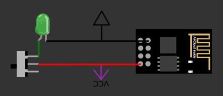

    Hey,
    in ESP01 I have a status check on GPIO2. When I connect GND, it shows 1, when I disconnect it shows 0.
    I have a circuit for this (shared VCC and GND with the one from ESP) with a physical switch and LED.
    I would like to check if this additional circuit is closed, but there is 3.3v on it, not GND.
    How to connect one to the other? Some transistor between GND and GPIO2, with the middle leg to my circuit? Just which one? I'm completely green in these matters :/.

    in software
    jarekgol wrote:
    Normally when you want to connect a pin to a controller, you connect GPIO.n to the pin, pin to GND and you turn on the pull-up on the port
    and that would work beautifully with GND, and I need it with VCC
    jarekgol wrote:
    , or you give an external resistor to + and GPIO.n
    You can also pin from + to port if the controller supports pull-down or add a resistor to ground.
    pull-down will not work. How else can I figure it out
    I have roughly something like this:
    Diagram with a button, LED, and electronic module with VCC and GND labels. .

    Describe somehow in full sentences what the work is in.
    This switch in the picture is the only one I found in the simulator, in reality there is a simple ON/OFF.
    In full sentences the work:
    I have a 3.3V DC power supply in the fuse box. To it is connected (under -) the wire that goes into the wall. Later it comes back and is connected under the diode and further to the power supply (under +).
    I can power it the other way round and it also works (after reversing the diode).
    This wire goes to the liquid tank and when there is a lot of liquid, it starts to pass current, the diode starts to light up.
    From the same power supply, I powered ESP01 in parallel.
    I want to check if the diode lights up (or more precisely, if the current is flowing and not through the photodiode ;) )

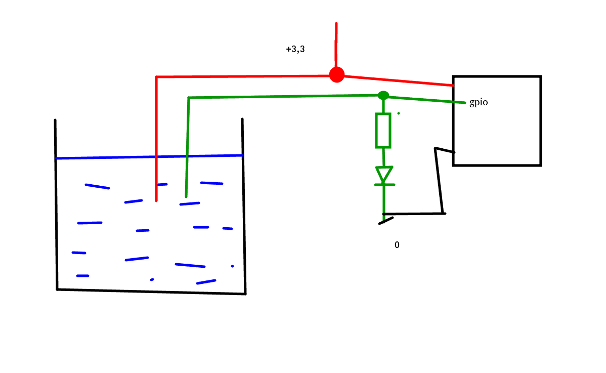

    It would probably be nicer to give a comparator on the way there, but as it lights up for you, it should work.
    Be careful, because such a level check, can eat the cables due to electrolysis.
    ps. You may still have to give some resistor to ground from that green test line, but that will come out in the wash.

    jarekgol wrote:
    Be careful, because checking the level like this, can eat the cables because of the electrolysis.
    I don't know what's in the tank, but the led has been running for a dozen years, so maybe there's a float in there that turns the circuit on dry?
    Maybe I misunderstand your drawing, but when the liquid level increases, doesn't a `+` appear on the GPIO when I need a `-`?
    My knowledge of electronics is low, so forgive me if I write some stupid stuff.... can't I do this by connecting an NPN transistor with the outer legs to GND and GPIO, and the middle leg between the LED and the tank?

    As for the 0.1 you can
    1) embrace it programmatically
    2) Reverse engineer my schematic (as you draw, you can throw in to check.
    3) Negate it hardware-wise, i.e. transistor, while remembering to have a resistor at least a few kilo ohms in the base.
    Maybe look into the tank and see what's there ;)
    @khoam what is this functionality used for? Because in this article it says that "can be prevented from booting if some pins are pulled LOW or HIGH. " but for what, I don't see.
