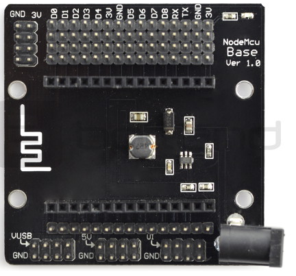

The most likely cause is that the NodeMCU Base is meant for ESP8266 boards, so with an ESP32 DevKit some pins can end up shorted to GND or power, and if your firmware drives those critical pins as outputs, that can damage the module [#18560293][#18560341][#18560372] However, if the ESP32 also heats up and fails when powered by microUSB with the base removed, then the module itself is probably already damaged rather than the expansion board being the only problem [#18560308] The fact that it had worked for about two months does not rule out the base contributing to the failure; it just means the mismatch did not cause an immediate fault [#18560308][#18560341] No new scripts or MicroPython changes were reported, so there is no clear evidence that software changes triggered it [#18560412]

    Hello, I probably burnt the esp32 wroom devkit module. Now when I switch it on the LEDs don't light up and it gets very hot until it steams. I may have made a mistake. I will describe how I connected it. The module was plugged into an expansion board designed for nodemcu - maybe this was the problem ? I attach how this expansion board looks like. I powered this from a 12v liion pack - this nodemcu expansion board supports 6-24v input.
    What could be the causes of the ESP32 burning up when connected to the expansion board? .

What likely caused my ESP32 to burn when plugged into a NodeMCU base?
The NodeMCU Base is for ESP8266, not ESP32. Pin functions differ, so the base can short ESP32 pins to ground or power. That creates high current and rapid overheating. As one expert noted, “some ESP32 pins are shorted to ground and power.” Remove the base and test via USB. [Elektroda, khoam, post #18560293]

Are NodeMCU Base boards pin‑compatible with ESP32 DevKit?
No. They target ESP8266, and several signals map differently on ESP32. Inserting an ESP32 DevKit can connect certain ESP32 pins directly to ground or power. That miswiring risks permanent damage. Always verify pin maps before mixing hardware. [Elektroda, khoam, post #18560293]

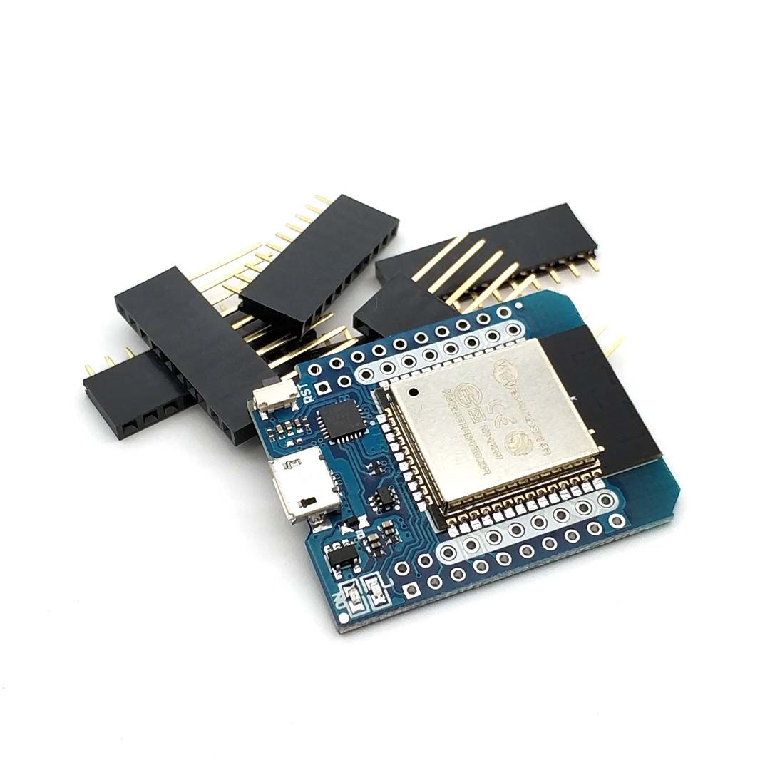

What ESP32‑friendly alternatives to a NodeMCU Base are suggested?
Use a D1 mini ESP32 with dual‑row headers; it’s available in Poland and makes attaching RF modules easier. This approach avoids ESP8266‑only bases and gives cleaner mechanical mounting for enclosures. [Elektroda, khoam, post #18560803]
Is there an ESP32 IO Shield like NodeMCU Base?
Yes, for example the keyestudio ESP32 IO Shield. Availability can be limited locally; one user noted it wasn’t available in Poland at the time. Consider sourcing alternatives or using header‑based boards instead. [Elektroda, prem111, post #18560719]

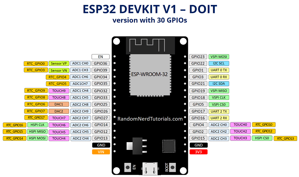

Do newer ESP32 DevKits with >30 pins change compatibility?
They increase misalignment risk with ESP8266‑only bases. As one expert noted, “newer versions of ESP32 DevKit have more leads than 30.” That difference makes accidental shorts more likely on fixed‑routing bases. Use ESP32‑specific carriers. [Elektroda, khoam, post #18560712]
