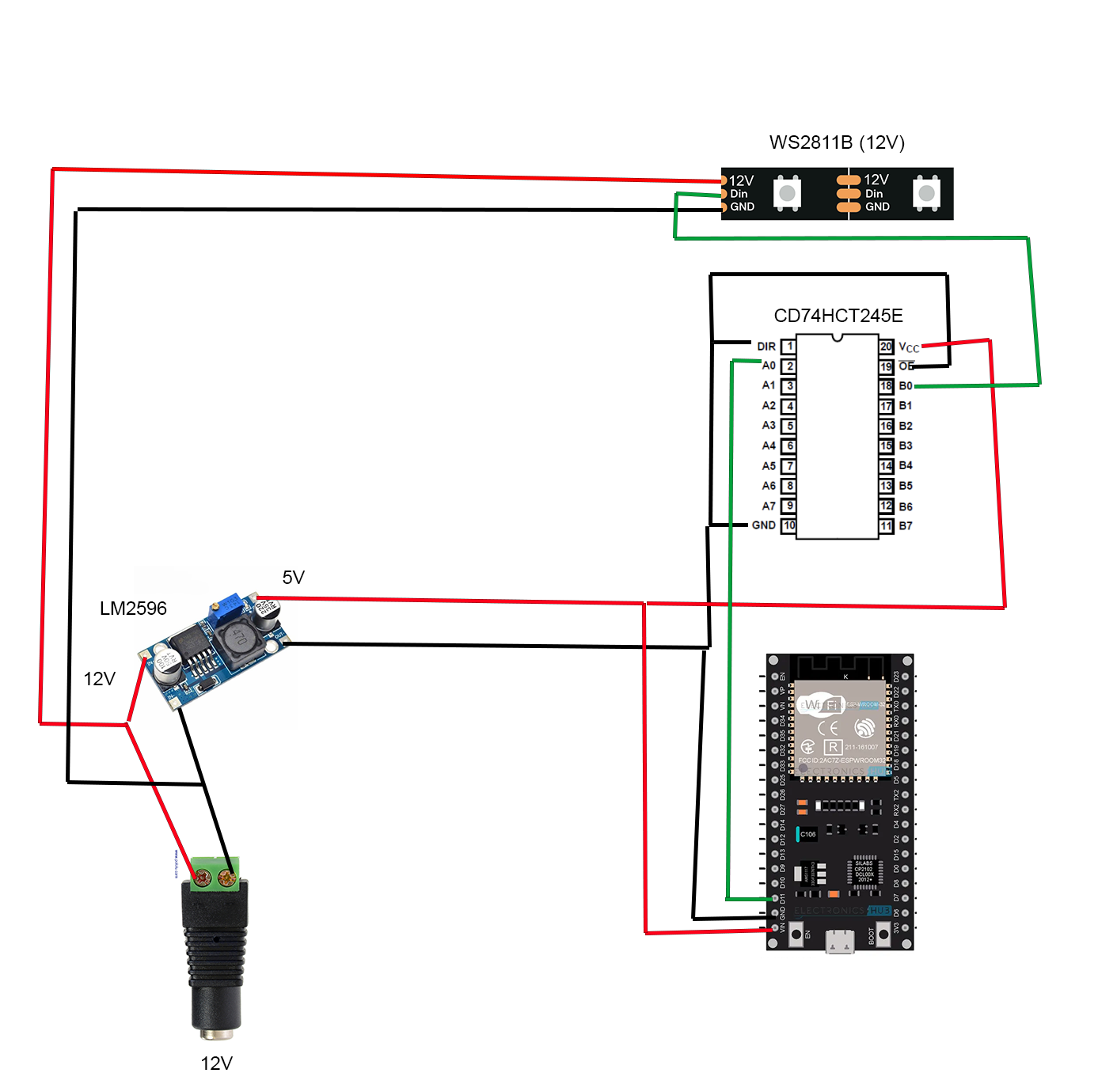

    Hey,
    Apologies in advance for the poor quality of the diagram.
    Connection diagram between ESP32, CD74HCT245E level shifter, LM2596 voltage regulator, and WS2811B LED strip.
    Namely, what seemed like a simple task – connecting an LED strip controlled by an ESP32 – turned out to be much more of a hassle. So far, I’ve burnt out three ESP32s, which, to put it mildly, is annoying.
    Perhaps I’ll start from the beginning, as I don’t fully understand why the chips only burnt out when the DATA pin was connected directly from the GPIO to the LED strip. As far as I understand, a microscopic current flows through the DATA pin, so the only risk of burning it out is reverse current resulting from a short circuit somewhere along the LED strip. How, then, should I test the LED strip?
    I also wanted to ask whether it’s normal, when testing with a multimeter on the ‘diode test’ setting whilst the strip is connected to the power supply, that:
    - GND to GND, + to + → beeping
    - GND to +, + to GND → continuous tone (short circuit)
    What have I checked?
    - the LED strip is powered
    - the connections are correct (checked with a multimeter)
    - the code is simple and ‘sometimes’ worked (provided the ESP32 didn’t burn out...)
    - the GND pins on the voltage regulator are connected together (checked with a multimeter)
    - I set DIR to LOW and HIGH (according to the datasheet, it should be HIGH for data to be transmitted from A to B)
    I’m running out of ideas on which direction to go next; especially as the ‘magic smoke’ has already gone up a few times.
    With the strip connected to the power supply at the first pads (before the first LED), I get 12V between GND and DATA, and ~12V between DATA and GND. I assume this isn’t how it’s supposed to be, but it seems to be the case on all the strips (I have four). Perhaps this is where I should look for the cause?
    The only way I’ve managed to send data to the strip is directly from the DATA pin on the ESP32 with an additional resistor (330 ohms), though this hasn’t always worked and I haven’t been able to identify a pattern.
    Thanks in advance for any suggestions!
    And I’d be grateful for any feedback, as this is my first post on this famous forum ;)
    AI: Could you describe exactly how you’ve connected the ESP32, the 74HCT245E level shifter, the LM2596 voltage regulator and the WS2811 LED strip? Details of the connections may help to identify the problem.
    I’m attaching a diagram.
    AI: What are the specifications of the power supply you’re using to power the LED strip and the ESP32? I’m referring to the rated voltage and current.
    12V 10A, although I’ll probably use a Korad unit with protection in further tests.

    I would prefer your diagram to reflect your components and not found and copied from the internet.... Does your ESP32 have one GND or two GNDs?
    Check the datasheet of your ESP32 with what voltage you can supply, check the actual supply voltage, do you have it too high since you have already stoned it 3 times? I don't know your ESP32 well enough, maybe you have some jumper there to switch the supply voltage from 5 to 3.3V and vice versa? Or maybe you were turning the potentiometer on your LM2596 voltage regulator? Check these issues again?
    The GND from the ESP32 is supposed to go to the WS2811 as well, so both GNDs from 12V and 5V are supposed to be connected together. Well, but since you write that on the regulator the GNDs are common, that connection is there, but I don't believe it anyway? Also, ground: the GND from the ESP32 or from the 74HCT245E I would send via the shortest path to the WS2811 and not via the GND of the regulator? Presumably this doesn't matter much in such a project as to the cause of the ESP32 stoned? Provide a source (link) to this project to make sure about the other connections in the schematic you drew? See here you have a similar project and similar problems - read the advice in this link: Link Many valuable comments can also be found here: Link .

    With the strip connected to power on the first pads (before the first diode) I have between GND - 12V DATA - 12V -> ~12V. I assume this should not be the case, but it seems to be the case on all strips (I have four). Maybe look for the cause here?
    Verify the supply voltages with a voltmeter and not 'diode test mode'? Verify these measurements and especially the short-circuits you found by other means, even just with an ohmmeter without plugging in the power supply?
    During the first attempts, beginners burn the first diodes, so I suggest cutting off the first diode. Stick a 62 -330 Ohm resistor into the DIN signal circuit as you did for testing.

    1. all GND pins on the ESP32 are the same ground. Although there may be several pins labelled as GND, internally they are connected and provide a common reference point.
    2. the ESP32 is most often supplied with 3.3 V (max. 3.6 V according to the datasheet). If you supplied the module with a higher voltage, it may have been damaged.
    3 It is necessary to connect the GND of the ESP32, the GND of the regulator (LM2596) and the GND of the WS2811. It is best to do this in a star fashion, avoiding unnecessary loops.
    4. if you have actually damaged the ESP32 three times, it is imperative to check both the supply voltage level and any spikes (pins) on the supply line.

    Thanks for the reply and the links! That's by way of introduction, the parallel Reddit thread finally ended up with an accurate diagnosis, as you also mentioned - I cut off the last LED (well segment, as this strip groups three each) - it was the one that was burning up, letting current through DATA.
    The LM2596 was putting out ~5 V, I checked before plugging in after playing around with the potentiometer ;) .
    The GNDs are common - I connected for safety as you also mentioned.
    "During the first attempts beginners burn the first diodes, so I suggest to cut off the first diode. In the DIN signal circuit as you did, stick a 62 - 330 Ω resistor for testing."
    Well, too bad I didn't do that right away ;) I didn't think that the damage could lead to the above mentioned DATA line problems.
    As for the ESP32 power supply itself, there was no problem. On the other hand, I was making the mistake of being able to power from USB and voltage regulator at the same time. It doesn't have to, but it can go wrong.
    "Furthermore, I don't understand what you are writing about here:"
    I mean I took a multimeter and checked if there was a "short circuit/connection". Continuous sound.
    On the other hand, when checking the voltage between DATA and GND, I had a full 12 volts. And here was the problem.
