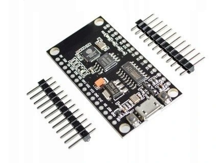

    Some time ago I purchased a Wemos ESP2866 module to use as a wireless controller for a WS2812b led strip.
    Wemos ESP2866 Burnt When Connecting WS2812b LED Strip .

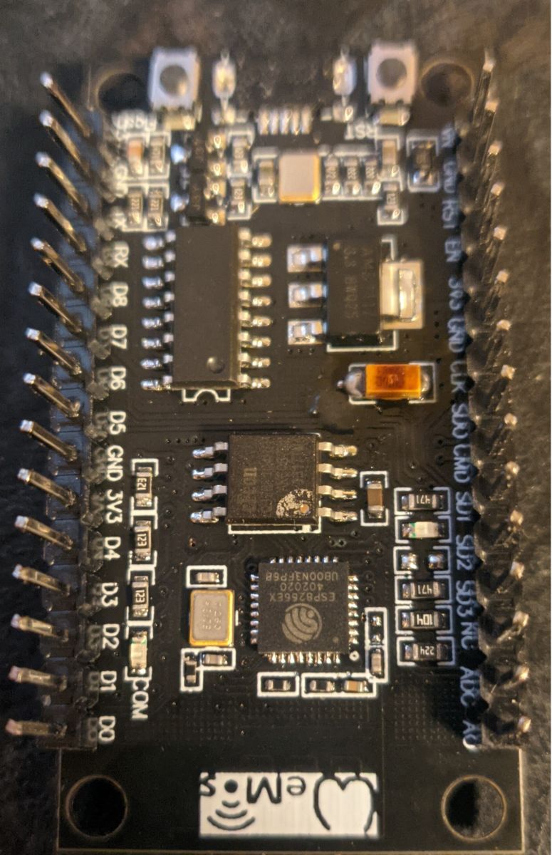

    After soldering the goldpins I connected it to the computer. Smoke went up. I quickly unplugged the unit, but noticed no damage (apart from a stain near the orange capacitor). I changed the cable, reconnected it to the computer.

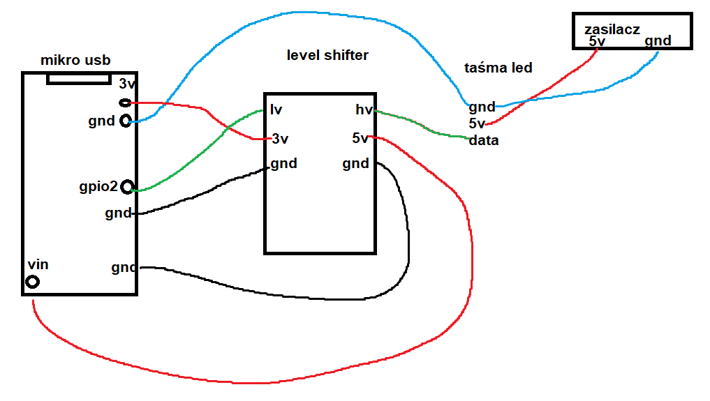

    I managed to upload the WLED software. That is, by this point the board was relatively functional. I proceeded with the next part. I tried to connect to the WLED but was unable to, the board was going out. The hub has an auxiliary power supply, so I decided to switch to the charger from the phone. Connection diagram below inspired by what I found on the WLED website (https://github.com/Aircoookie/WLED/wiki) Wemos ESP2866 Burnt When Connecting WS2812b LED Strip
    Shortly after connecting, the board died on the amen. Heavily heated, the miniusb port pulled out of the board when trying to disconnect. I am unable to verify if it is still bootable.
    Photo of the damaged board
    What went wrong? Is a manufacturing defect to blame? Or did I make a mistake later and "hit" the board when connecting to the power supply and led strip? If I did something wrong, I would like to avoid the same mistake in the future

    How is the ESP board powered? I am referring to the positive pole of the voltage. According to your drawing, it is fed from the level converter board, not from the power supply.
    Also, if I'm not mistaken, you didn't connect +5V from the converter to the Vin of the ESP board only to, depending on whether the board is shown from the side as in the picture or the other side, to D0 or A0. The Vin is near the USB port.

    The board was powered by a microusb. Although I also suspect some problem with the cable because on the first one (the one I used when the smoke first went) the module was not detected in the device manager. Although I find it hard to believe that a faulty cable would cause such damage.
    The vin was supposed to be a 5v source for the logic converter, as I read that it can be either a power source for the board (but you can't use it as a source at the same time as connecting it via usb) or as a source of voltage for the components connected to the board (provided the current requirement is within esp capabilities)
    The damage I noticed first: the square element marked AB1742 where the indentation in the pictures is visible in my case is an exposed leg. You could feel the components heating up strongly near the 3.3v outputs Then the orange capacitor was burnt.
    Possible solder bridge near the burnt capacitor

    I have read that without a logic converter there are voltage fluctuations which cause flickering so I figured since I have a converter there is no reason not to use it. However, going back to my initial question, could the cable have damaged the board when first connected? For future reference I will avoid using the VIN as this may have caused additional problems.

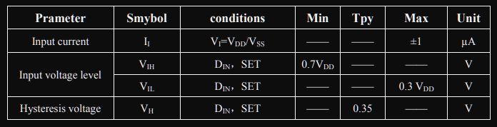

According to the WS2812B note, the input HIGH is 0.7×VDD, about 3.5 V at 5 V. 3.3 V logic is marginal. “The minimum VIH is 0.7VDD.” A level shifter improves reliability and reduces flicker risk. [Elektroda, khoam, post #19532163]
