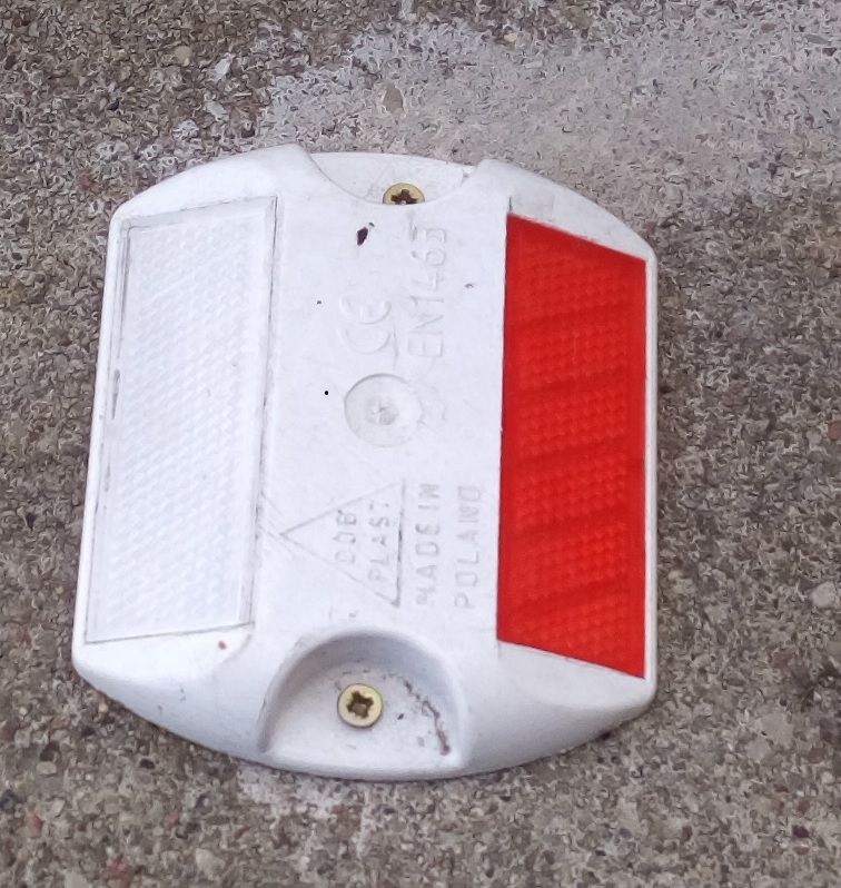

    If the cover is metal without any holes it is in practice an insurmountable barrier for the radio signal.
    Is there a lot of traffic on the road ? Can anything be attached to the cover ?
    You have probably seen the reflectors commonly known as cat's eyes hanging on the asphalt. The casing is about 25mm thick and can withstand a little car traffic. A transmitter with a battery can be placed in such a piece. The whole thing, of course, has to be encased in resin. I have been testing the durability of such a solution for a parking space occupancy sensor for three months. Unfortunately, there has hardly been any snow this year. So it is difficult for me to say whether snow and ice will cause connectivity problems.

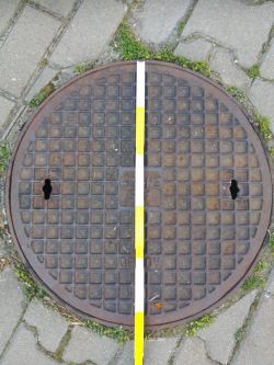

    Thanks to TvWidzget for your willingness to help. The cover has two holes, about 3 cm in diameter, for ventilation I think. Do you think it will be enough to transmit the signal?

    cerga wrote:
    The cover has two openings of approx. 3 cm diameter, for ventilation purposes I guess.
    Rather for hooks to lift the cover.

    I was referring to such an enclosure:
    Wireless septic tank - how to transmit the transmitter signal from the manhole .
    The receiver at my place is just high up, but this is due to the specifics of the application. I have not measured the range. I think it will be 10-20m. The transmitter sticks out above ground level. The receiver can therefore also be placed low.

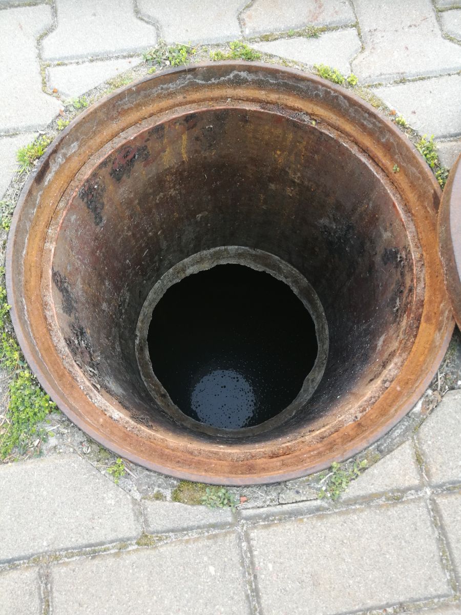

  • #14 18599567
    cerga
    Posts: 10
    kot mirmur wrote:
    Are you able to draw a side cross-section of this septic tank, fellow author? Some simple drawing, and give the approximate diameter of the effluent pipe.
    Hello, I will provide pictures. One with the lid and one without (sorry for the views). The lid is 54 cm in diameter.
    Unfortunately the diameter of the drain pipe unknown because, as can be seen in the photo, the pipe is hidden somewhere under the sump.
    Without diving it is not possible to measure :) .
