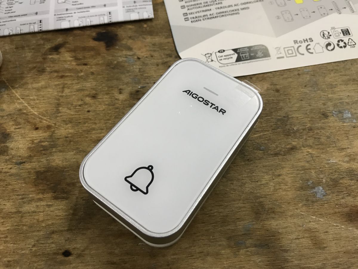

  • Aigostar wireless doorbell on a table with instructions in the background .
    Wireless solutions are often considered more convenient and handy than wired ones. Installation is easier, there is no need to pull cables, drill, hide them under angles and combine how to do it aesthetically. There is, however, an inconvenience - the need to regularly replace the battery, which usually dies at the least convenient moment. But are we sure? Perhaps we could do things differently? Let's find out!
    Today, a product bought in our country for all of PLN 45 comes to the table. Here we have a wireless and battery-free wicket doorbell with IP44 rating, i.e. resistant to small particles and water splashes. The product model is U6A-N6A , and the product itself offers:

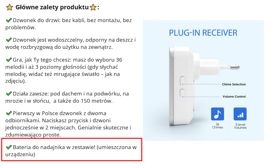

    We did a bit of digging around when buying this product, as you can find all sorts of nonsense in the offers, including silence about batteries in the case of the battery-operated transmitter, as well as talk of batteries in the case of the transmitter.... battery-free:
    Advertisement graphic for a wireless doorbell with a plug-in receiver. .
    Well, but that's probably the result of copying without checking the bid description. In any case, it's time to look at what we received in practice:

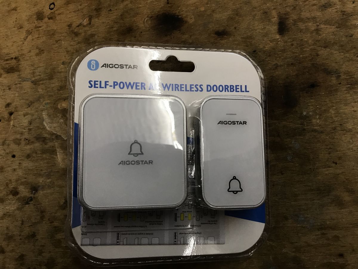

    Packaging of Aigostar self-powered wireless doorbell .
    Wireless and battery-free doorbell Aigostar in packaging. .
    English-language name: "self-powered AC wireless doorbell".
    The contents of the kit itself are nothing to discuss, as the bare minimum is here - and we don't need more:

    The workmanship plastic is quite solid, it is not the cheapest plastic of which torches from China, for example, are made.
    The whole thing works without pairing:

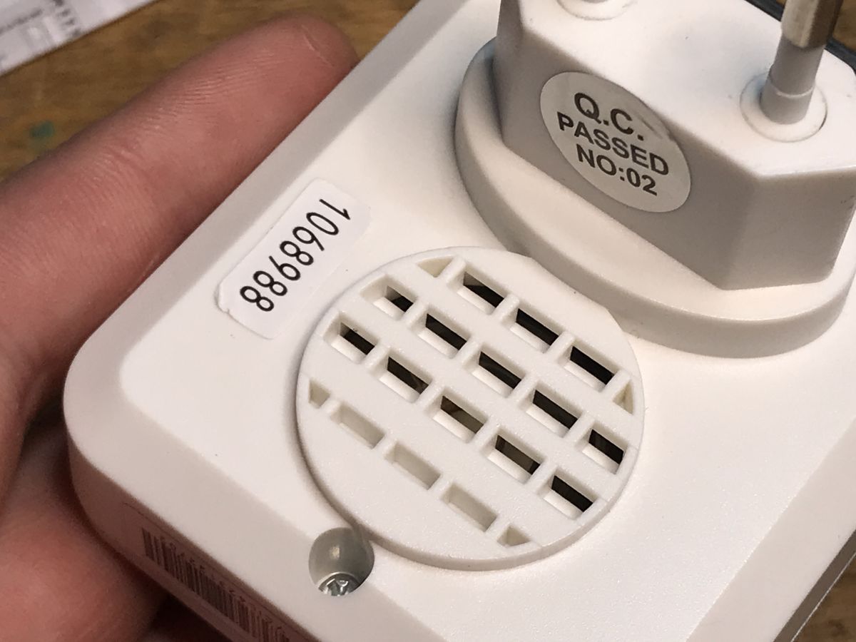

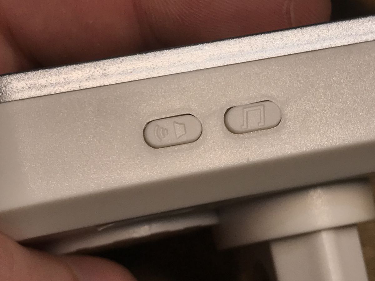

    There are two buttons on the receiver housing - melody selection and voice level:
    Close-up of buttons on wireless doorbell receiver housing .
    We are most interested in the transmitter, so we will start with the receiver.

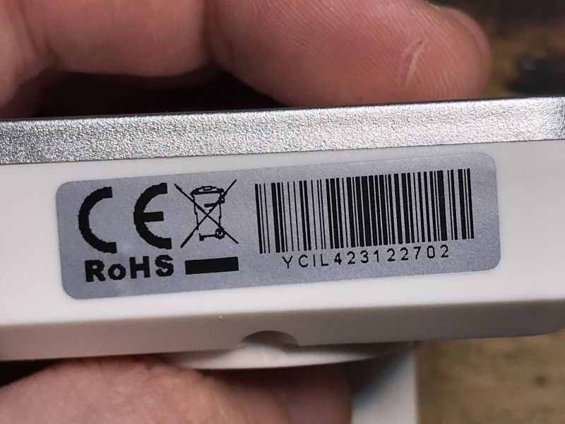

    Receiver of a wireless, battery-free doorbell with speaker grill and inspection stickers. .
    Close-up of a label with CE and RoHS certifications and a barcode. .

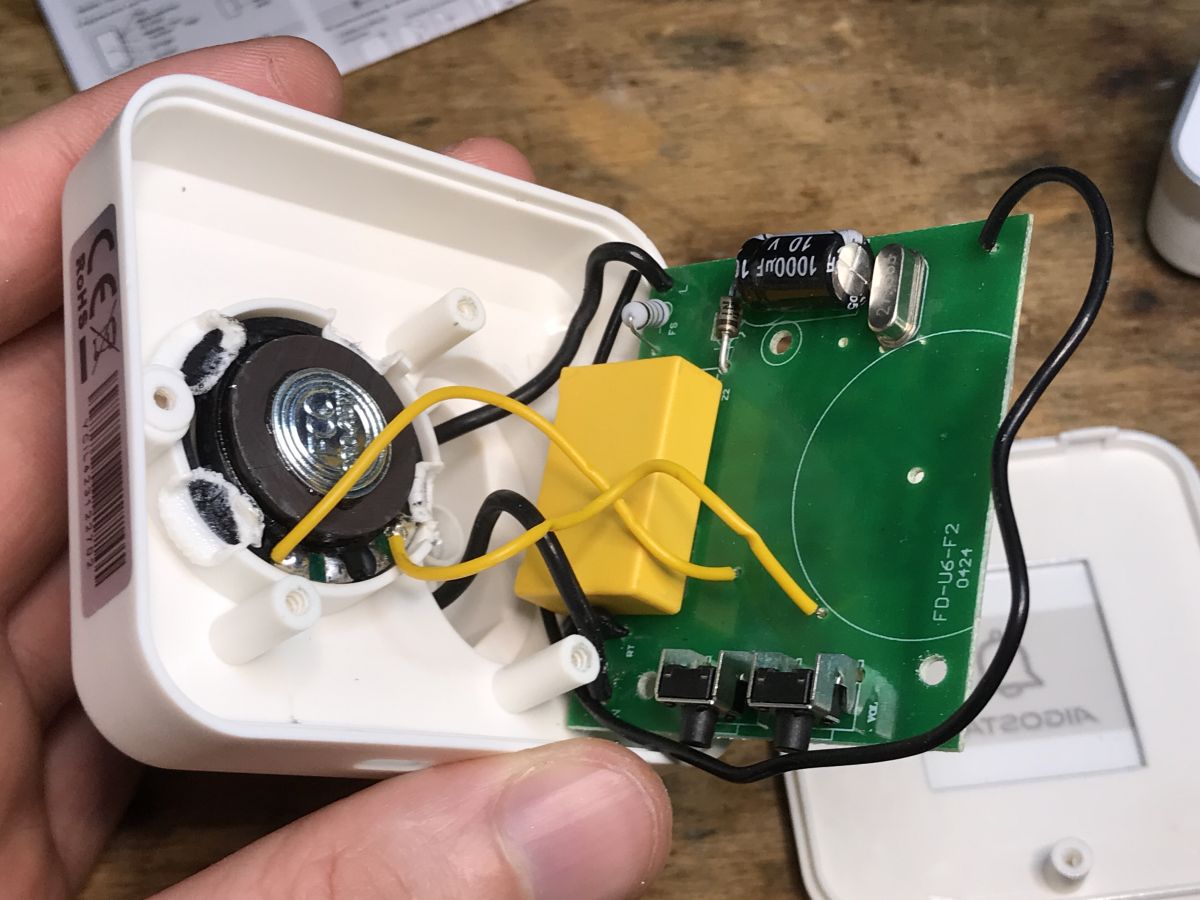

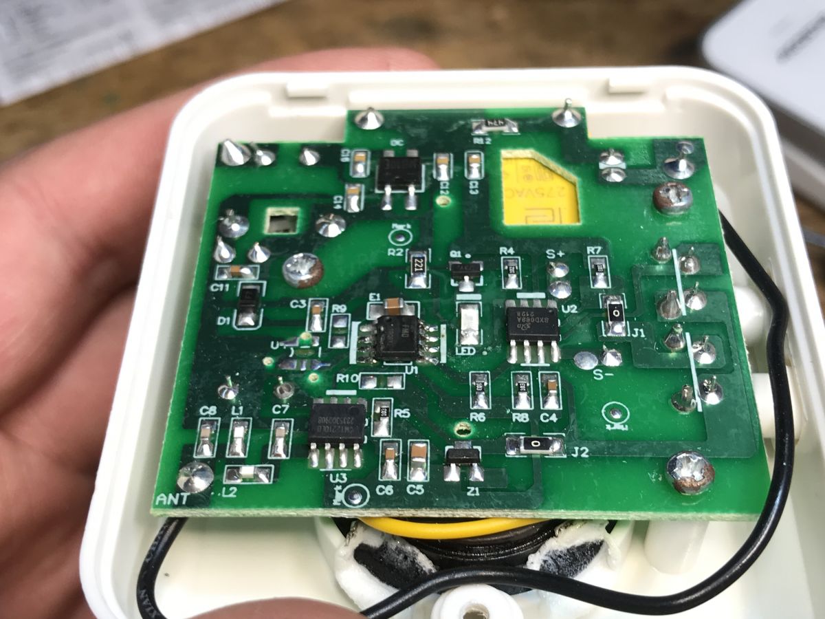

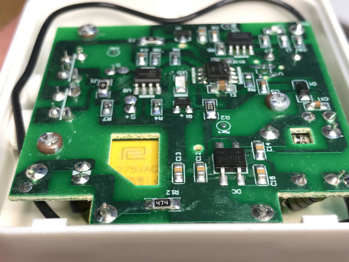

    The board is single sided, mixing through-hole and surface mount.
    Interior of a wireless doorbell receiver showing the circuit board. .
    Close-up of the interior of a wireless doorbell receiver. .
    Receiver PCB of wireless doorbell .
    Close-up of electronic internal components. .
    Close-up of electronic components on a PCB. .
    Close-up of an electronic enclosure interior showing wires and components. .

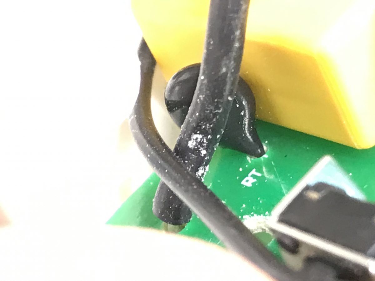

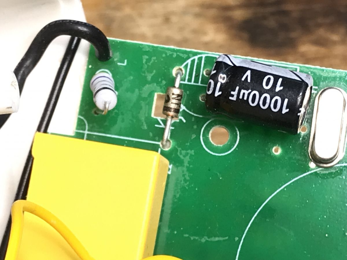

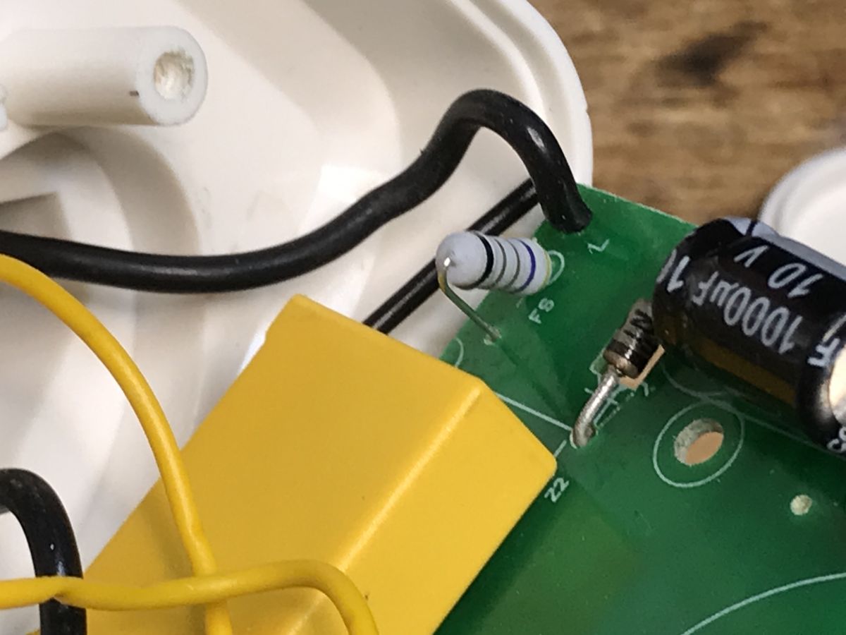

    There is no step-down converter for mains power, the power supply is realised by a transformerless power supply on a capacitor. The input is also protected by a fuse. A little further on you can see the MB10E rectifier bridge. From its 'plus leg' there is a connection to a 1000uF electrolytic capacitor and a Zener diode, presumably this is the power supply stabilisation and filtering circuit.
    Further down the line things get a bit more complicated:
    Close-up of a printed circuit board with integrated circuits. .
    Close-up of a PCB with electronic components. .
    Close-up of a printed circuit board with visible electronic components .

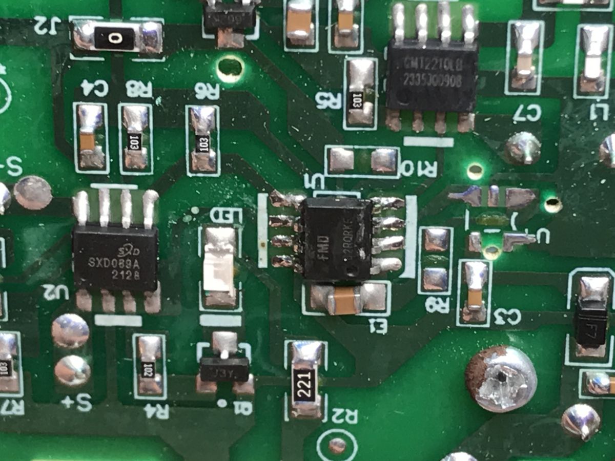

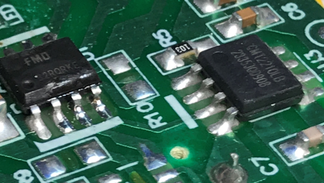

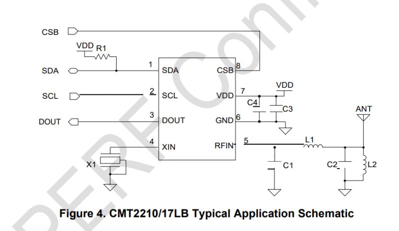

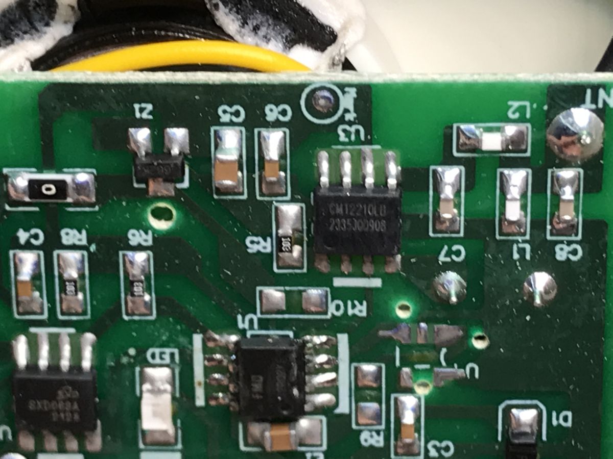

    The CMT2210LB is an RF receiver, you know. He also has a 27MHz quartz resonator in his circuit.
    Technical specifications for the Hoperf CMT2210/17LB RF receiver. .
    CMT2210/17LB typical application schematic .

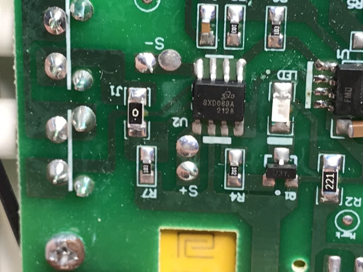

    That leaves two chips. SXD089A - I couldn't find any information about it online, but it seems to be connected to the speaker via the S+ and S- pads, so maybe it's an amplifier?
    The other is an FMD 82RQRKE or similar. The output of the RF receiver is connected to it:
    Close-up of a printed circuit board with two integrated circuits. .
    So it's probably the MCU. The buttons are probably operated by him too. He's probably the one playing the melody, which is then amplified.

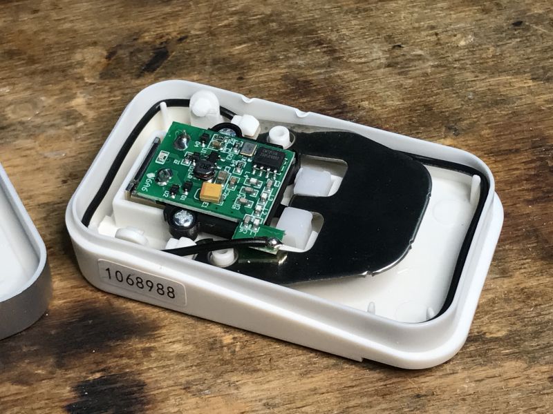

    Now for the most interesting part, which is the transmitter:
    Aigostar wireless doorbell receiver on a wooden table with instructions in the background. .
    A wireless and battery-free doorbell lying on the table. .

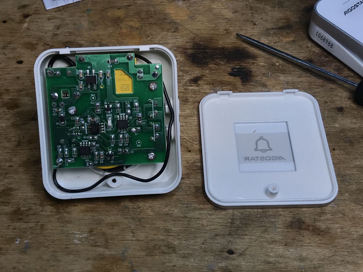

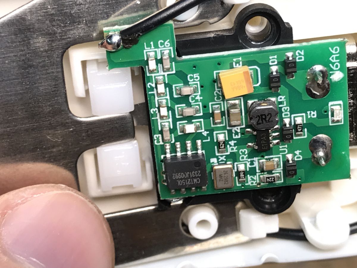

    The first thing that catches the eye is the antenna:
    Disassembled wireless doorbell transmitter with visible circuit board inside. .

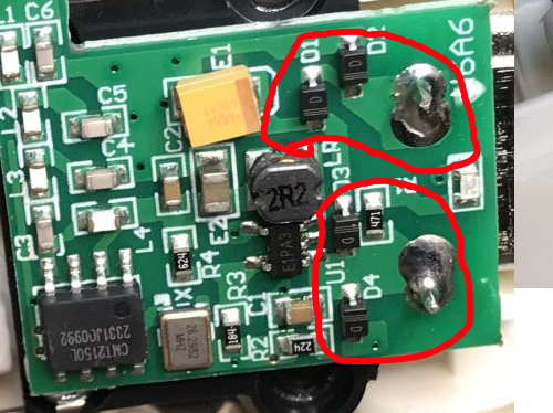

    Here we also have an RF transmitter along with a resonator and a circuit that looks like an inverter. The power, however, actually comes from a generator that converts the force of pressing the button into current:
    Close-up of the interior of a wireless battery-free doorbell transmitter. .

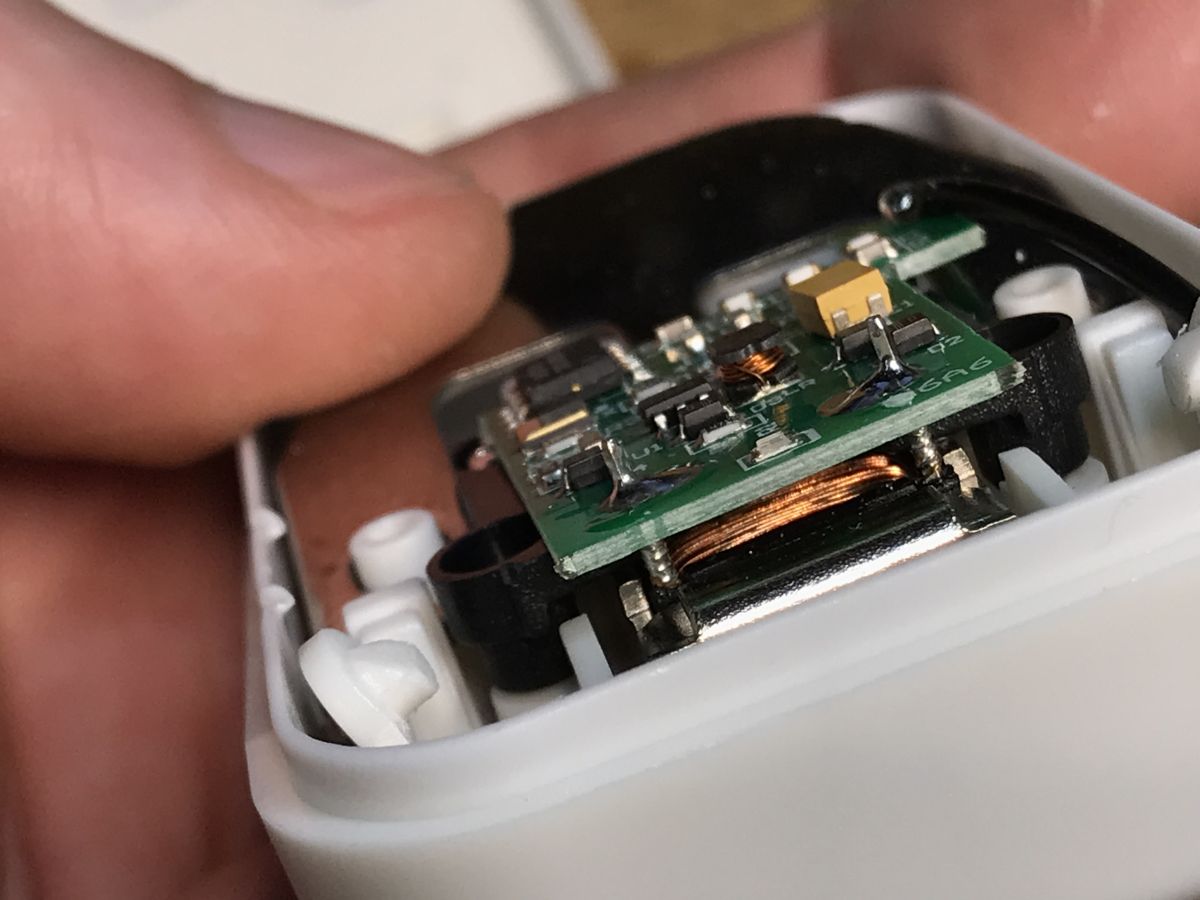

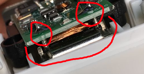

    You can even see the coil from this generator, while I did not dismantle it more, I did not want to damage the product.
    Circuit board of a battery-free doorbell transmitter. .
    Indeed, it takes a bit of force to push it in, this is no ordinary microswitch:

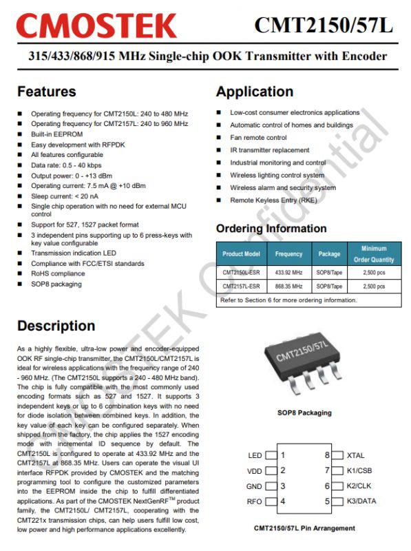

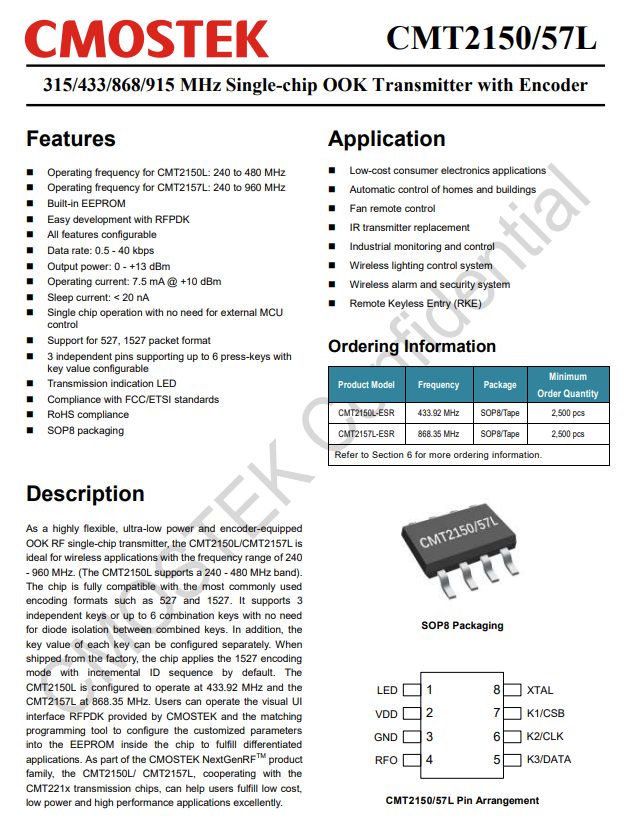

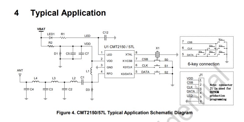

    It remains to specify the name of the RF transmitter chip - CMT2150L.
    CMOSTEK CMT2150/57L chip specification. .

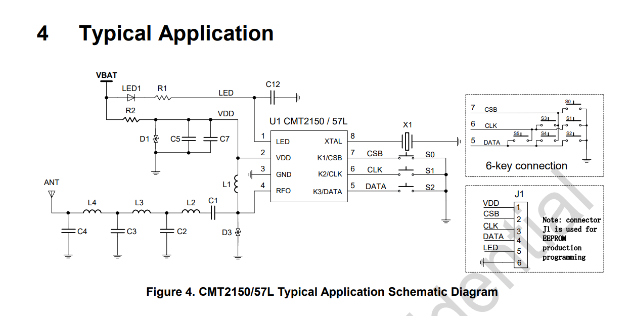

    It is interesting that this chip supports up to 6 buttons, but only one is used here:
    Typical application schematic diagram for CMT2150/57L .
    The question of mounting remains - I didn't take a picture, but the instructions show that the transmitter has a separate frame which can be fixed with double-sided tape or screws. I refer you to the instructions for details.
    In summary , the transmitter does indeed work battery-free and the whole thing performs well for a PLN45 purchase with same day shipping. From China it might even have been cheaper. The choice of tunes is wide and the voice level control is also useful. By the way, I also tried to play around with the range, but within my small flat I didn't manage to 'lose' it even though there were two rooms between the transmitter and receiver.

    It's a pity you didn't describe exactly the most interesting thing - i.e. how this current is generated. A bit of current is needed, however - apart from the transmitter itself, there is also the LED.
  • #3 21461301
    vodiczka
    Posts: 30276
    Help: 1185
    Rate: 4311
    krzbor wrote:
    It's a shame you didn't describe exactly the most interesting thing - i.e. how this current is generated.
    Probably described, just a bit mysteriously
    Realistically, it takes a bit of effort to push it, it's no ordinary microswitch:
    I'm betting on a microswitch but it could also work with a piezo effect.

    krzbor wrote:
    It's a pity you didn't describe exactly the most interesting thing - i.e. how this current is generated. A bit of current is needed though - apart from the transmitter itself there is also the LED.
    vodiczka wrote:
    I'm betting on a microdynamo but it could also work based on a piezo effect.
    After all he has shown, you can see the coil. Energy requirement to send a "ringing" packet less than when lighting a cigarette lighter.

    acctr wrote:
    It showed, you can see the coil.
    I have yet to see a coil generate a current by itself. For that you need an alternating magnetic field. I was just wondering how this is done. It's more likely that putting the magnet in and out of the coil isn't enough (although I may be wrong). Maybe there's a mechanism to put the magnet in a spinning motion - that would certainly extend the pulse.
    Maybe a piezo as described here: Link .
    All the more so if you can see the coil the rest you can add/draw for yourself, as befits homo sapiens.

    Krzysztof Kamienski wrote:
    I'm not very smart but I get it - the worm turns the rotor of the alternator when pressed, like in communist children's farts.
    Or perhaps when pressing, a spring is tightened, which at some point is released and an oscillating movement of the magnet in the coil is created?
    Or perhaps even more simply as EnOcean does:
    Copper coil mounted in a black plastic holder. .
    From 7:34
    I know that you enjoyed the blurb. However, I am interested in the actual solutions.
  • Bistable core likely generates the pulse energy
    #19 21465084
    acctr
    Posts: 4554
    Help: 389
    Rate: 2025
    The pictures show the coil and the PCB shows the two legs from it, connected to the rectifier bridge:
    The image shows a coil and two leads on a PCB connected to a rectifier bridge. .
    Close-up of PCB with marked coils and rectifier bridge.
    This indicates that the energy is provided by a coil and, assuming this equipment obeys the known laws of physics, there should be some sort of core underneath the PCB, housed inside the black casing.
    Simply moving the button is a linear movement and such a changing magnetic field is unlikely to induce a large enough current.
    The key issue, then, is how to transmit the movement of the button to the core. In one of the videos you can hear how the button works - there is a clearly audible 'click' which means that at some point something jumps.
    Presumably the movement of the lever is transmitted to the spring, which at some point causes the core to change position quickly, similar to what happens, for example, in microswitches used in computer mice
    The core has two stable states corresponding to its position relative to the coil and the transition between them is a correspondingly large dΦ/dt.
    PCB with electronic components, including a coil and a bridge rectifier. .
