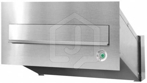

    I would like to install a letterbox in a fence post along with an illuminated bell button.
    The instructions say to supply the illuminated button with 24V.
    I have a 3x2x0.5mm cable connected to the post (I assume 2 wires will supply voltage to the backlight LED and 2 wires will supply voltage to the jumper button).

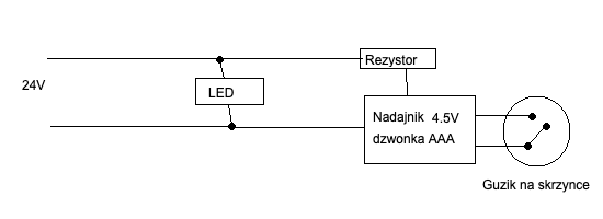

    What if the 24v power fed into the slop could be used to power the bell transmitter hidden inside?
    As far as I can see, 90% of wireless bell transmitters run on 3xAAA (4.5v) batteries and here I could use the 24v sent to the backlight, select a suitable resistor and achieve 4.5v for the "factory" transmitter which would mimic a 3xAAA battery.
    Wireless Doorbell Signal Transmission from Garage to Flat .
    Problems I see:
    - whether such transmitters are easily disassembled at all or whether half of them will be destroyed if you try to tamper with the casing
    - whether there is a chance that such a transmitter will work for years without failure and even after sealing the roof of the pole (no access to the inside) I am not shooting myself in the knee
    As I wrote, I am a layman in these matters so I can write silly things. But as they say if something is stupid but works .... it is not stupid :)

    Obtain the voltage using a suitable stabiliser.
    Bell transmitters are seamlessly disassembled.
    One works for years and the other doesn't - it's Chinese and you never know.

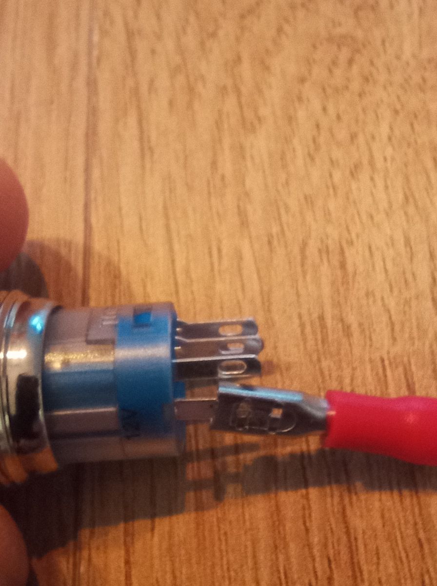

    And do you perhaps know if there are any such small connectors on sale. The one pictured is 2.8mm wide and is too big for the male connectors sticking out of the bell button.
    They do exist.
