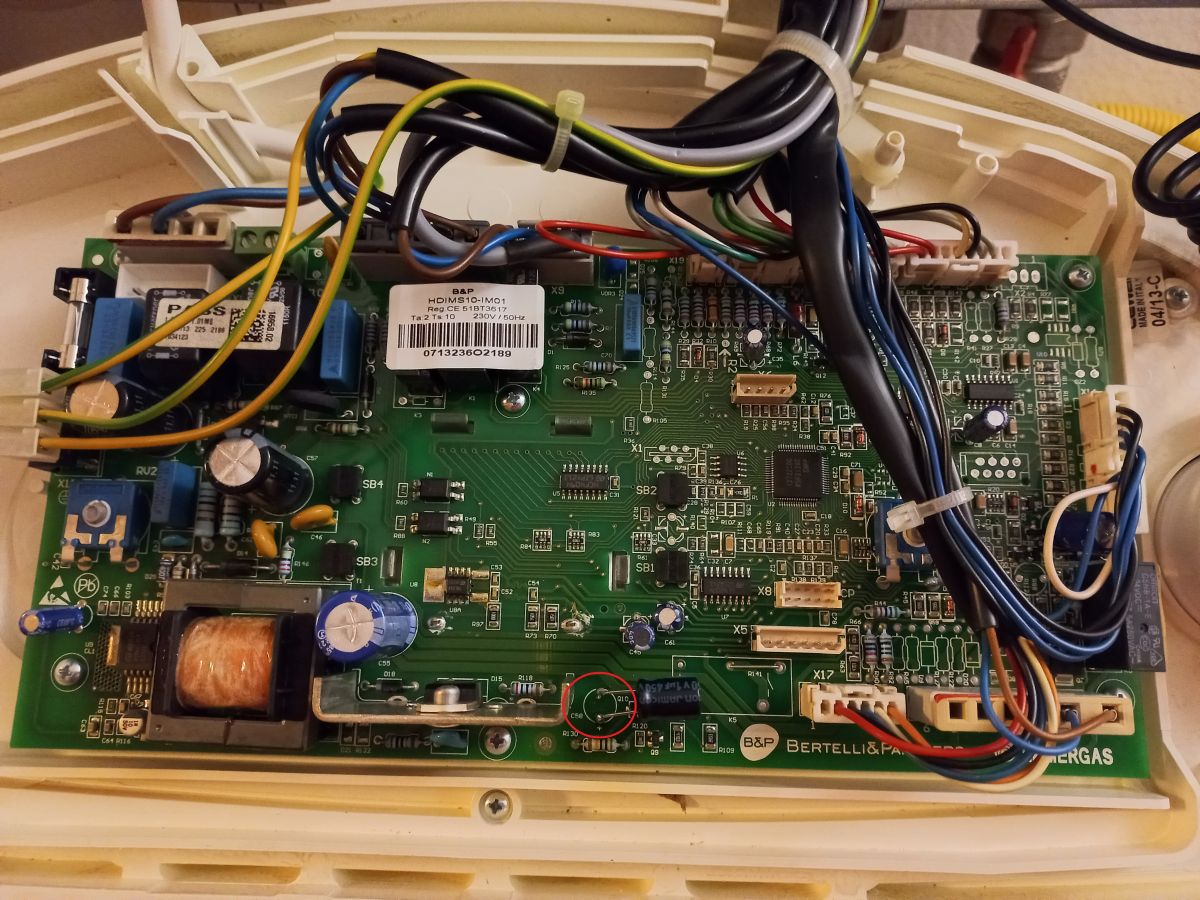

E37 is usually caused by a fault in the control board power supply, most often a failing C58 1µF/400V capacitor; in some boilers C50, C83 or C72 also lose capacitance, and the heatsink heat can shorten C58’s life [#19912412][#20221678][#20915212][#20114622] Check the power supply rails: the board should provide about 28 V and 240 V, and if the latter drops below 197 V the controller reports E37 [#19912412] The most common practical fix is to replace the suspect capacitors with good 105°C branded parts; reported working replacements include C58 1µF/450V or 400V, C50 330 nF X2, C83 10 µF/50V, and C72 22 µF/63V [#20114622][#20915212][#21547655] One user fixed it by replacing only C58, which had drifted down to nF-range capacitance instead of 1 µF [#20221678] If the capacitor swap does not solve it, the fault may be elsewhere in the power supply, such as the optocoupler, so a professional board repair may be needed [#20883506][#19912412]

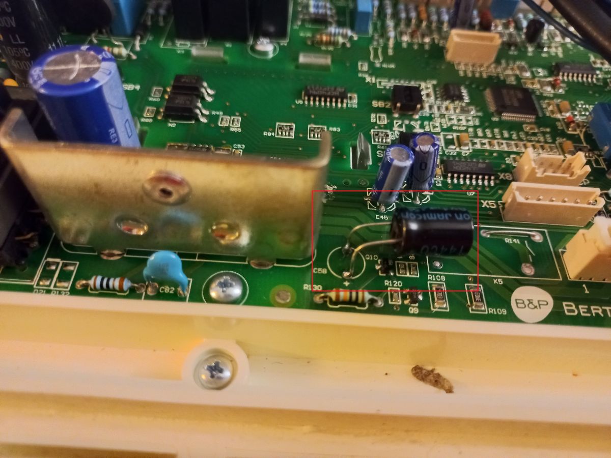

  • Replacing C58 capacitor fixes E37 error code
    #31 20915212
    szucsvendel

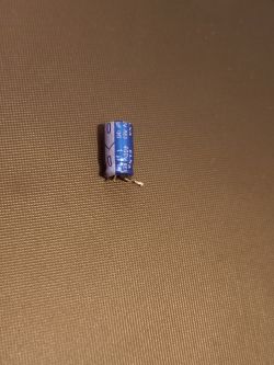

    I also managed to repair the E37 error code problem. (Victrix 26)
    I replaced the electrolytic capacitor C58 and the boiler is working normally again.
    New: 1uF 450V 105°C Jamicon
    Original: 1 uF 400V 85°C ELNA
    I hope that this replacement actually solved the problem and the error does not occur again.
    I think the root cause of the error is: The C58 capacitor is very close to the heatsink, which is hot. The heat of the heatsink reduced the life of the condenser. When I removed the plastic cover of the panel, I felt that the whole unit was slightly warm.
    I strongly recommend that you try replacing the C58 capacitor before you buy the new expensive control panel. (It's worth a try.)
    The old capacitor should be cut with a small cutting-nippers. The new capacitor can be soldered onto the cut leg relatively easily. In this way, the panel does not have to be unscrewed and turned over for soldering.
    I hope that everybody will be able to fix the Immergas E37 error code phenomenon.
    If you have any questions, I will try to help.
    Control board of Victrix 26 boiler with highlighted capacitor C58. View of a circuit board with a replaced capacitor C58. ELNA electrolytic capacitor 1uF 400V on a brown background.

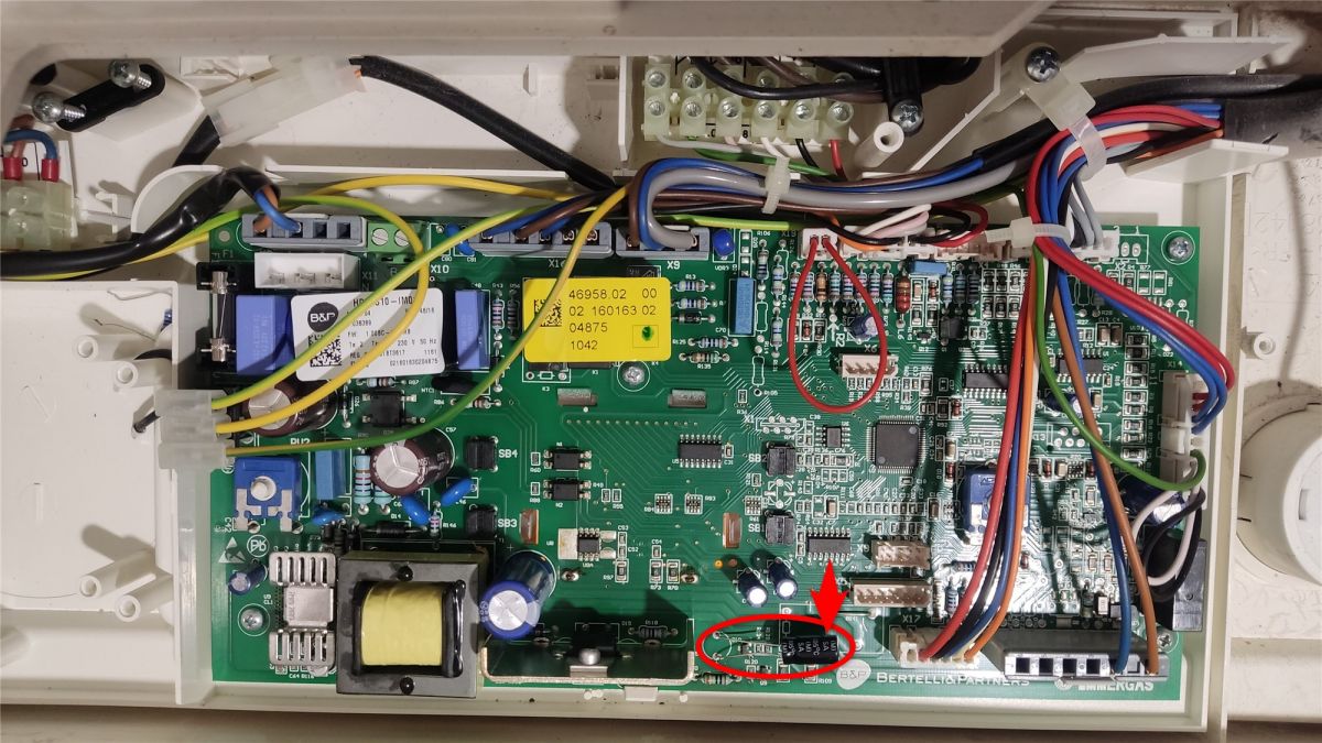

    For me, replacing the capacitor helped with error E37 in the Immergas EXA 24 boiler C58 . The old one only had 60pF instead of 1uF.
    After the replacement, the furnace started and works :-)
    Circuit board of Immergas EXA 24 boiler with replaced capacitor C58.

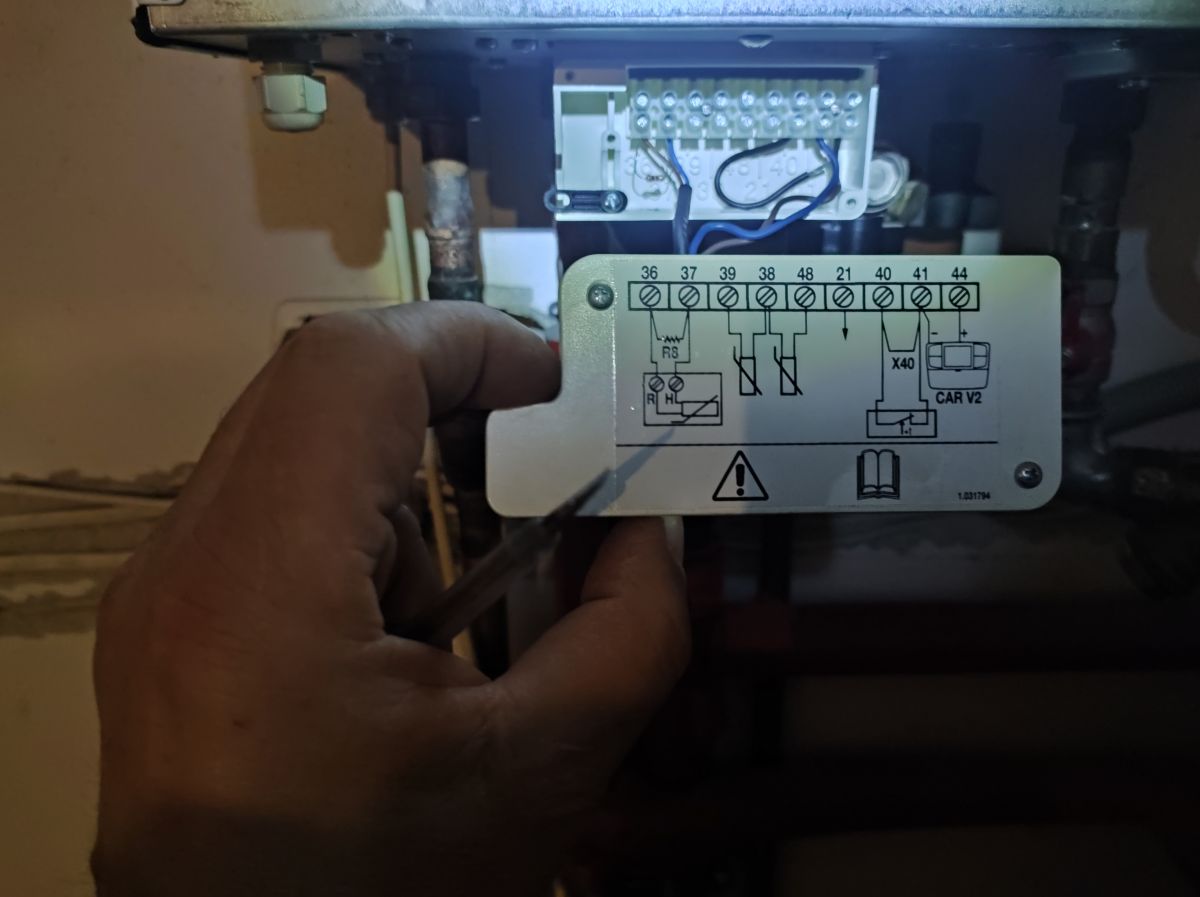

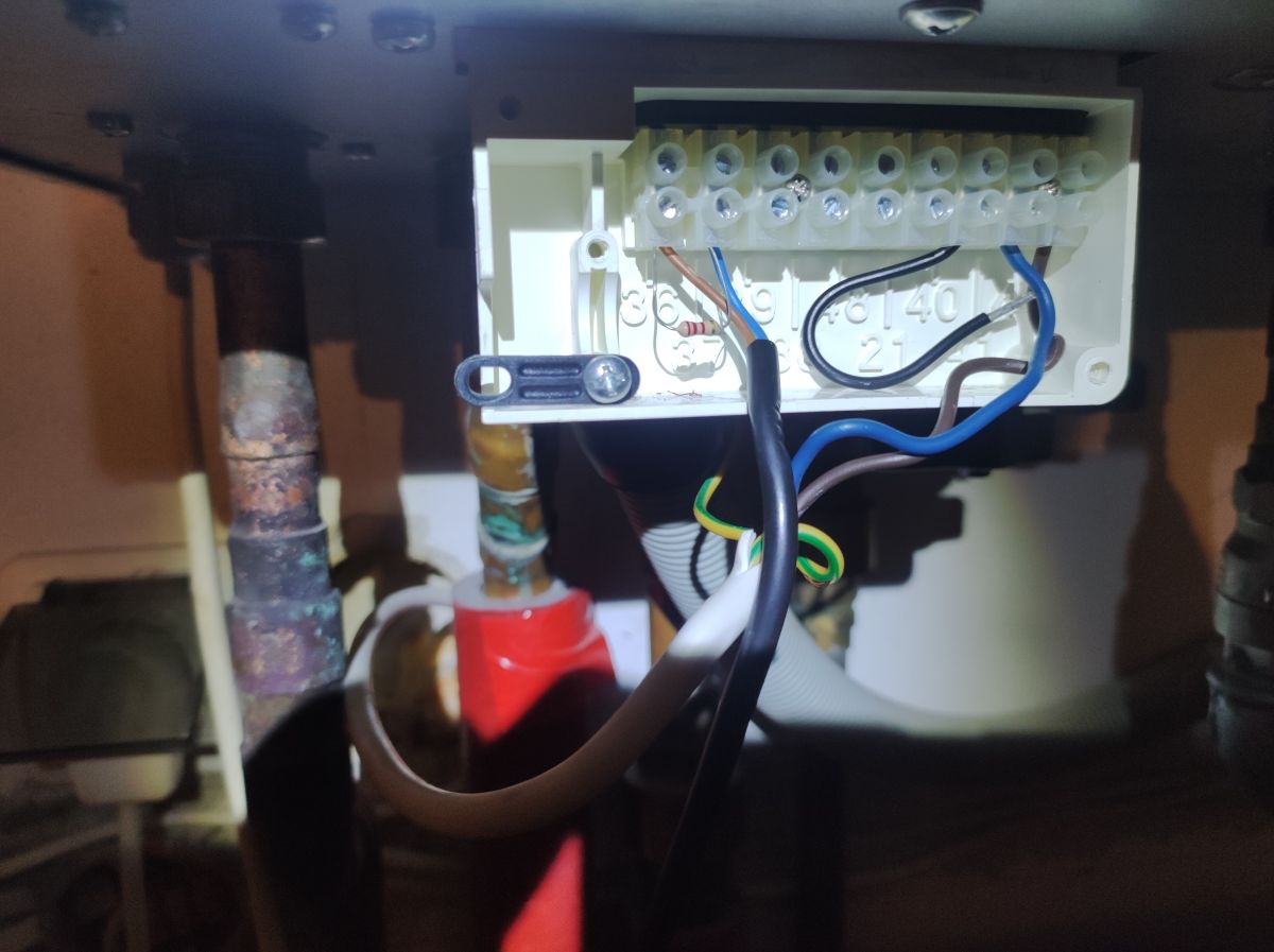

  • Loose resistor on inputs 36–37 may be the fault
    #36 21292060
    juveniaolsztyn
    Image of a boiler's connection panel with visible wires and a resistor. Hi, from the description of the E 37 error, it seems that it could relate to faults on the motherboard or on the devices connected to it, i.e. the detector or the controller. I don't know anything at all about electronics, but I decided to check the latter option. I started to unscrew the furnace housing and became interested in the small box underneath, which has two cables: in my case, a black one from the temperature sensor from the water tank and a white one from the controller located in the hallway. On the lid of the box are shown the wiring diagrams of these devices. And interestingly, I saw a resistor, which according to the diagram was supposed to be connected to inputs 36 and 37 together with the temperature sensor wires, was lying loose on the bottom of the box. On its "legs" were visible traces of screw pressure from the mounting strip. Furthermore, I am puzzled by the black wire coming out of input 40, with also visible screw pressure marks from the trim. My question is whether (I made it provisional for the photo) this is how I should connect the resistor (maybe the other way round) and whether, in your opinion, according to the diagram, the black wire hanging down should be bridged to input 41. If I get it right and it's ok, then great, if nevertheless the E37 error still appears, then I'll get on with the board.
    Image of a hand holding a panel with a wiring diagram in a furnace, showing entry numbers from 36 to 44. .
  • Resistor and bridge should be disconnected
    #37 21292154
    Rysio4001
    Heating systems specialist
    Posts: 3024
    Help: 617
    Rate: 1077
    @juveniaolsztyn
    In your case, this is how it is supposed to be!
    That resistor is supposed to be removed (disconnected), and that bridge is supposed to be disconnected too.
    Just take a look at the original instructions in the installer section, you'll know why, and that this is correct.
    P.S. I can see from the photo that you did, however, fuse your fingers, and connect this resistor.
    And how - do you now have hot water ? :twisted: .
  • #38 21299083
    juveniaolsztyn
    Thanks, of course not. As I've mentioned I don't know much about electronics, but I do like screwing screws. Of course everything is back in its place, i.e. the resistor on the bottom of the box. Thanks, I will now get down to the C58 capacitor as you suggest. Thanks kind regards.

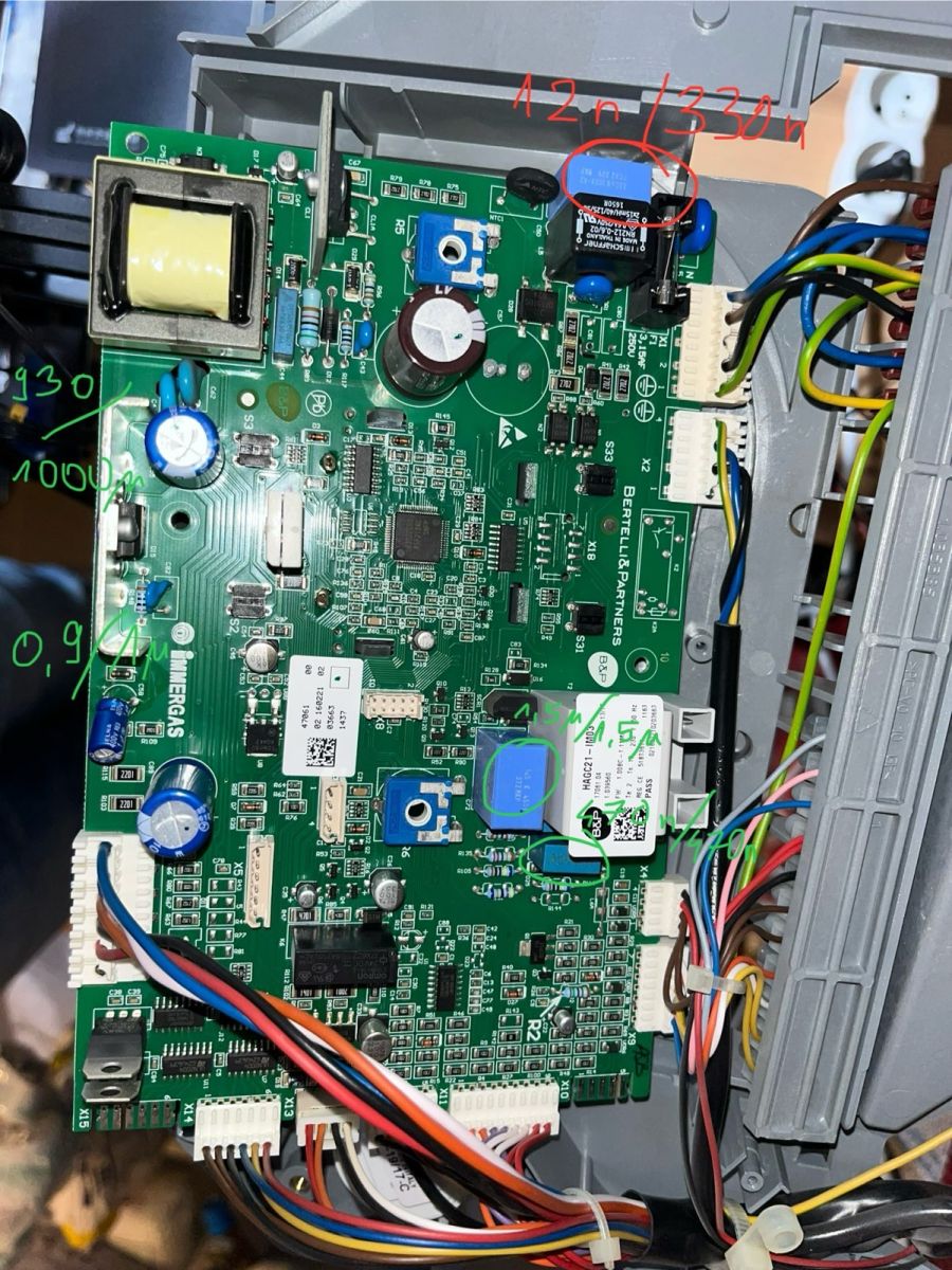

  • C50 capacitor loss caused E37 faults
    #40 21547655
    tomekgl
    Posts: 119
    Help: 13
    Rate: 57
    At my place, in the Immergas Victrix 12 TT ERP (2018 year) C58 was fine, for that the capacitor in the filter circuit on the power supply lost capacitance, C50 was 12n instead of 330nF. After replacing it with 330nF/310V X2, the boiler has been running flawlessly for a few days, whereas before it was popping E37 after just a few hours.
