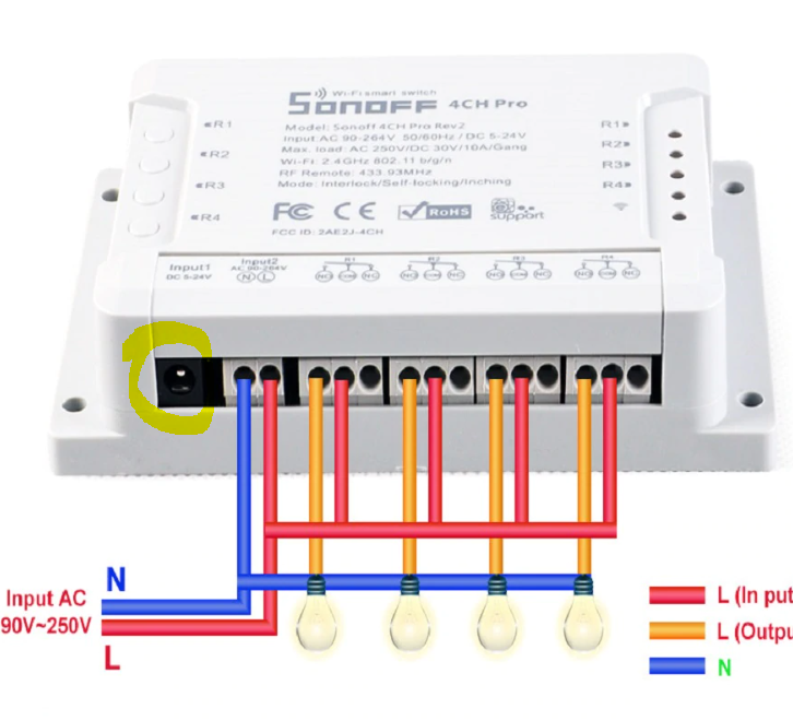

    Hi. I will be installing automatic watering in my garden, I am a bit green and have a few questions for you regarding the operation of such a watering system. The whole watering system will be based on a sunoff 4ch (4 channel) to each channel I want to connect an inverter/power supply from 230v to 12v. To the power supply I will connect a solenoid valve on 12v which will be open when power is applied. I will set the appropriate schedule in the application. What I mean is that each electro-valve will open one after the other. That is, 1 solenoid valve open for 30m, the rest closed, then the 2nd solenoid valve open for 30m. Is there any chance of this working?

    Wait, I power the sonoff 230v by connecting 2 +- cables or through this socket with a 12v power supply. And I connect the 4 valves, do I also connect the power supply to them or what, I'm a bit green :p

    @Oddawajsanki What power supply voltage does this Sonoff have ? 220 VAC or 12 VDC ?
  • #9 18706996
    Oddawajsanki
    Posts: 84
    Rate: 7

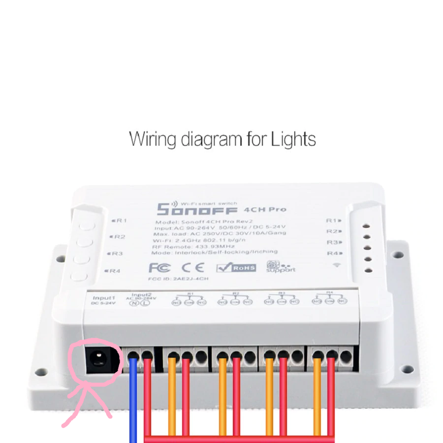

    Krzysztof Kamienski wrote:
    @Oddawajsanki What power supply voltage does this Sonoff have ? 220 VAC or 12 VDC ??
    Sonoff 4CH Setup for Sequential Solenoid Valve Operation in Garden .
    How is the connection supposed to look in this picture ? Sonoff 4CH Setup for Sequential Solenoid Valve Operation in Garden
    in yellow I have marked the input I will use
  • #10 18707006
    Krzysztof Kamienski
    Posts: 21895
    Help: 2033
    Rate: 5167
    It is better to power the Sonoff from 220VAC, in parallel with the input of the 12 VDC power supply. This will prevent damage to the Sonoff, through feedback pulses generated by valve coil inductions.
    Preferably power the Sonoff from 220VAC, in parallel with the input of the 12 VDC power supply. This will prevent damage to the Sonoff, through feedback pulses generated by valve coil inductions.

    #12 18707057
    Krzysztof Kamienski
    Posts: 21895
    Help: 2033
    Rate: 5167
    A 2 A fuse can be inserted in the circuit of each valve and the same in the 220VAC supply circuit.
