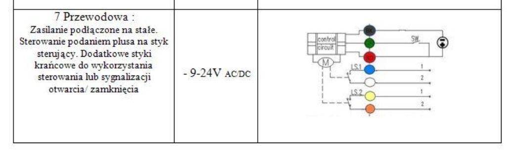

    I have a question about the type of shut-off valve control. I want to control the valve in such a way that it closes the water when the alarm is armed and opens it when the alarm is disarmed. The alarm control panel controls a relay module which has NO, COM, NC contacts. And now my question - which type of valve to choose. With two-point or three-point control and do I understand this correctly.
    As far as I know, two-point control means that one wire goes N, the second L (the valve is then closed) and the third L wire opens the valve and the disconnection closes it.
    Three-point control works in such a way that N goes to one wire and depending on whether L is fed to the second or third wire the valve will either close or open.
    Is there any difference between the two types of valve in my application? I can connect the two-point valve in such a way that N and L goes to the first wire and the second wire relays L to the third wire so that the valve opens and closes.
    And in the case of a three-point I can feed L with NO and NC contacts once to one wire and once to the other. I have tested such a control. In practice I don't see any special difference to my application. Is there any?
    The second thing - do both these types of valves have limit switches and once the set state is reached, they do not draw any current (regardless of whether it is open or closed)? It seems that they do. But I see that e.g. such a valve Link is made as normally closed and I don't understand what it means by normally since after reaching a preset state the valve should stop drawing current (regardless of whether it is open or closed and remain in this position, so it should not have a "normal" state). With valves with three-point control there is no distinction between NO and NC , which suggests that the two-point ones need a continuous supply to stay open? For me this is important, because a valve that draws current to be open (i.e. NC) would always have to be live when someone is at home. Anyway, the reverse version is the same only while the alarm is armed. That's why I'm looking for something that has a limit switch.

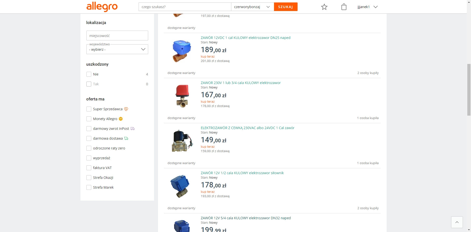

    Third thing - anyone recommend a good valve. I previously had a three-point Chinese one for 150 zł with turnbuckles. Type of control nice but after 2 weeks of operation the plastic connection of the valve to the motor broke. I am now looking for something better . The one from the link seems to be ok Herz is about 500 zł . Anyone recommend ?

    Hi. Use a valve with a "three point" control - N wire, and 2x L, one for closing and the other for opening. Such a valve needs power only for the time of opening/closing. Two-line valves in one position draw current all the time. At a friend's place such a valve was installed and it heated up a lot and drew a lot of current (12W of power has to be dissipated somewhere, and thus the valve in the open position was very warm, even though it was for continuous operation.
    NO - normally open - power to close
    NC - normally closed - power to open
    Both of the above-mentioned types do not have limit switches. Theoretically only valves with three supply lines have limiters which disconnect the valve drive when closing/opening, but it also depends on the design because they may have a clutch and therefore the supply must be given for a certain time.

    Select the valve model to suit your needs. Price does not always go hand in hand with quality. Perhaps you have come across a faulty unit? Buy from an established stationary shop/wholesaler so that you have somewhere to complain if something goes wrong.

    I solved the problem like this. I gave a valve with N-controlled and 2x L- closed/open limiters (something like the one in the links above). Control from the control panel, supply to the valve from 230V. I have no or only occasional power shortages (2-3 per year). Secondly, I find it hard to believe that such a coincidence would cause the water system to fail just when there is no power. I would have to be very unlucky. Just in case, I've made a bypass with a manual valve so that I can run the water in the event of a power failure or a problem with the control panel. Thanks to everyone for their suggestions.

    jajen wrote:
    the only time there could be a problem is if a valve fails to close during arming due to a failure of the valve itself, but this could apply to any valve and a 12v buffer will not change this.
    therefore I am in favour of feeding the signal from the limiters to the inputs of the control panel and installing flooding detectors which are configured in a separate zone and resetting the alarm from these detectors with a different password than the one used to arm the alarm and of course notifying the phone if flooding is detected. Then you know about the damage to the valve beforehand, if a pipe bursts the detector detects flooding it closes the electro-valve and does not open it until you consciously enter the password to cancel the flooding alarm. And you don't have to shut off the water in the building every time the alarm is armed, so you can set the washing machine or dishwasher before you leave.

    kood wrote:
    e.g. of such:
    Which ball valve control to choose for an alarm system? .
    Fellow kood , which exact ball valves with limiters are you using ? I have had a cursory look and it looks like the 7-wire valves have additional limit switches. The 3-wire ones also have one you would have to connect to after unscrewing the valve. I would like to confirm the actual position of the valve to Satel's Integra control panel, because as you yourself rightly pointed out that giving an open or close signal is not always equivalent to its execution. I intend to connect wired flood detectors to the control panel and use them to control the ball valve, additionally also when arming the alarm.
    For the time being, I have bought the ball valve alone , because temporarily they do not have a 7-wire version https://washservice.pl/pl/p/Zawor-kulowy-nierdzewny-1-cal-DN25-pod-silownik-ISO5211/123.
    Delivery is expected in 3 weeks. Then I will buy the control unit itself.
