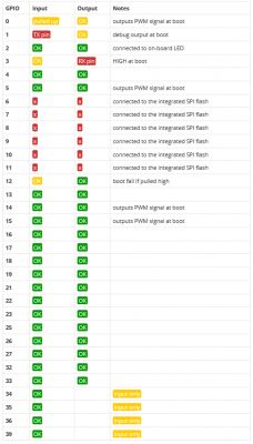

    For example, on this board GPIO2 is connected to the LED on the PCB.
