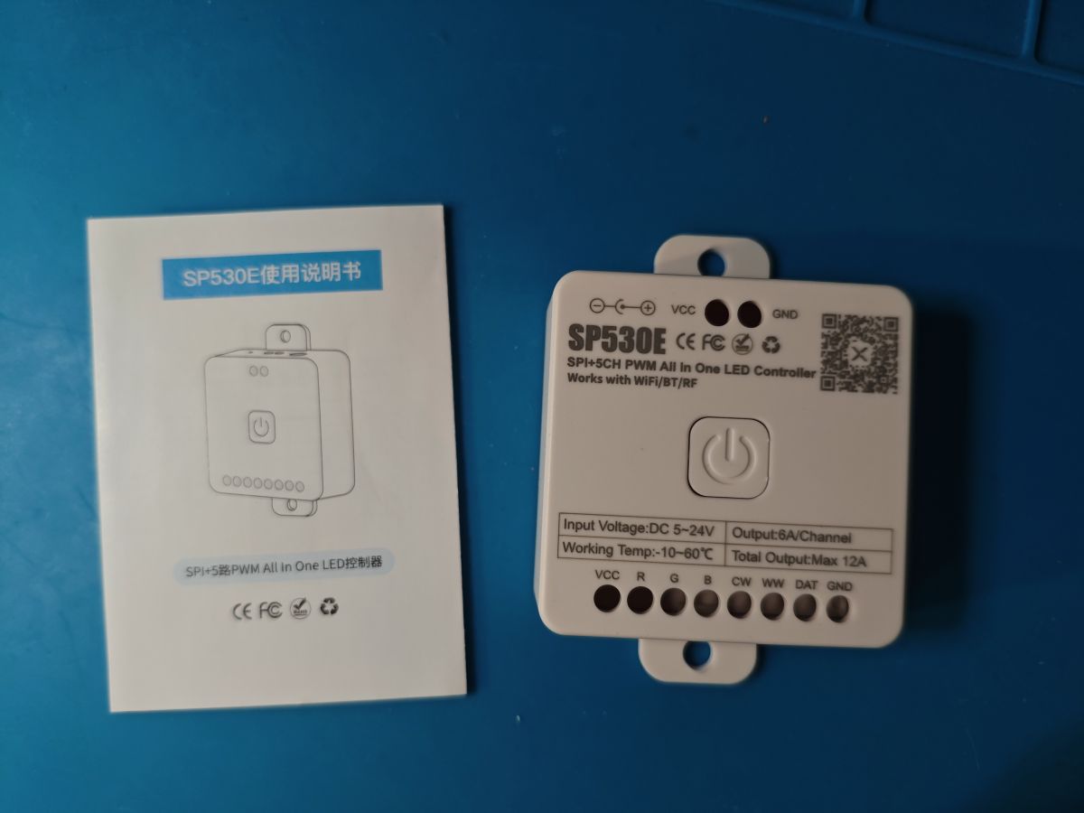

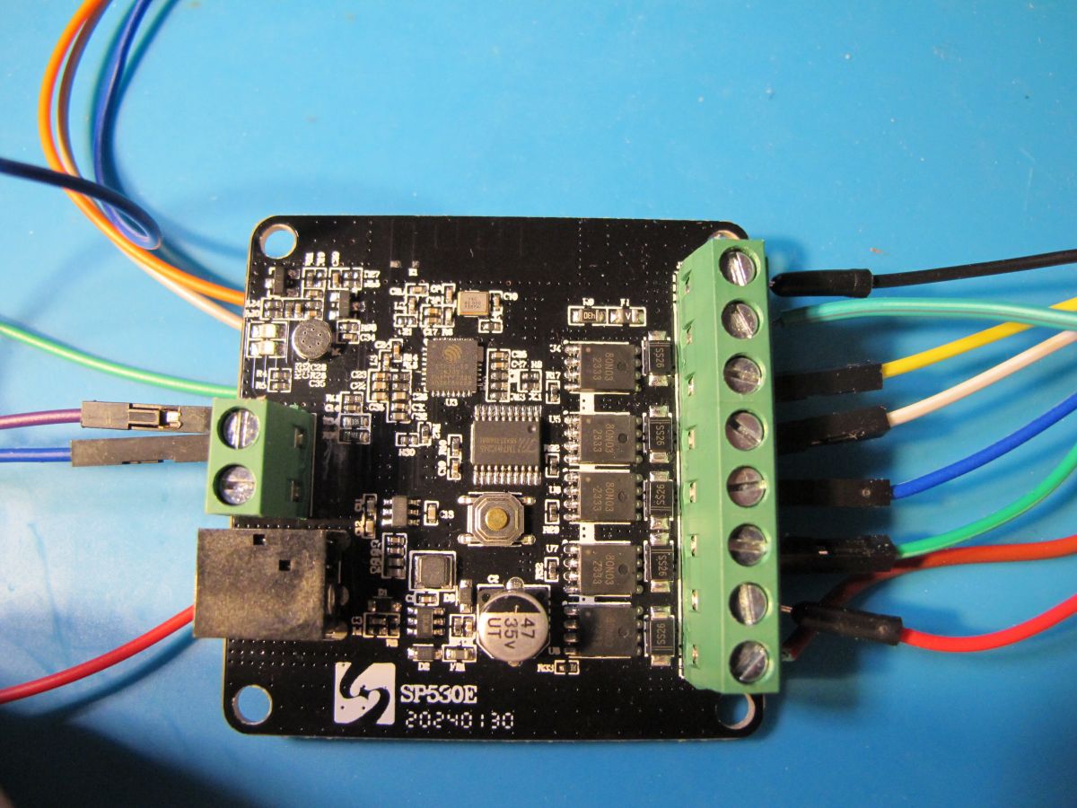

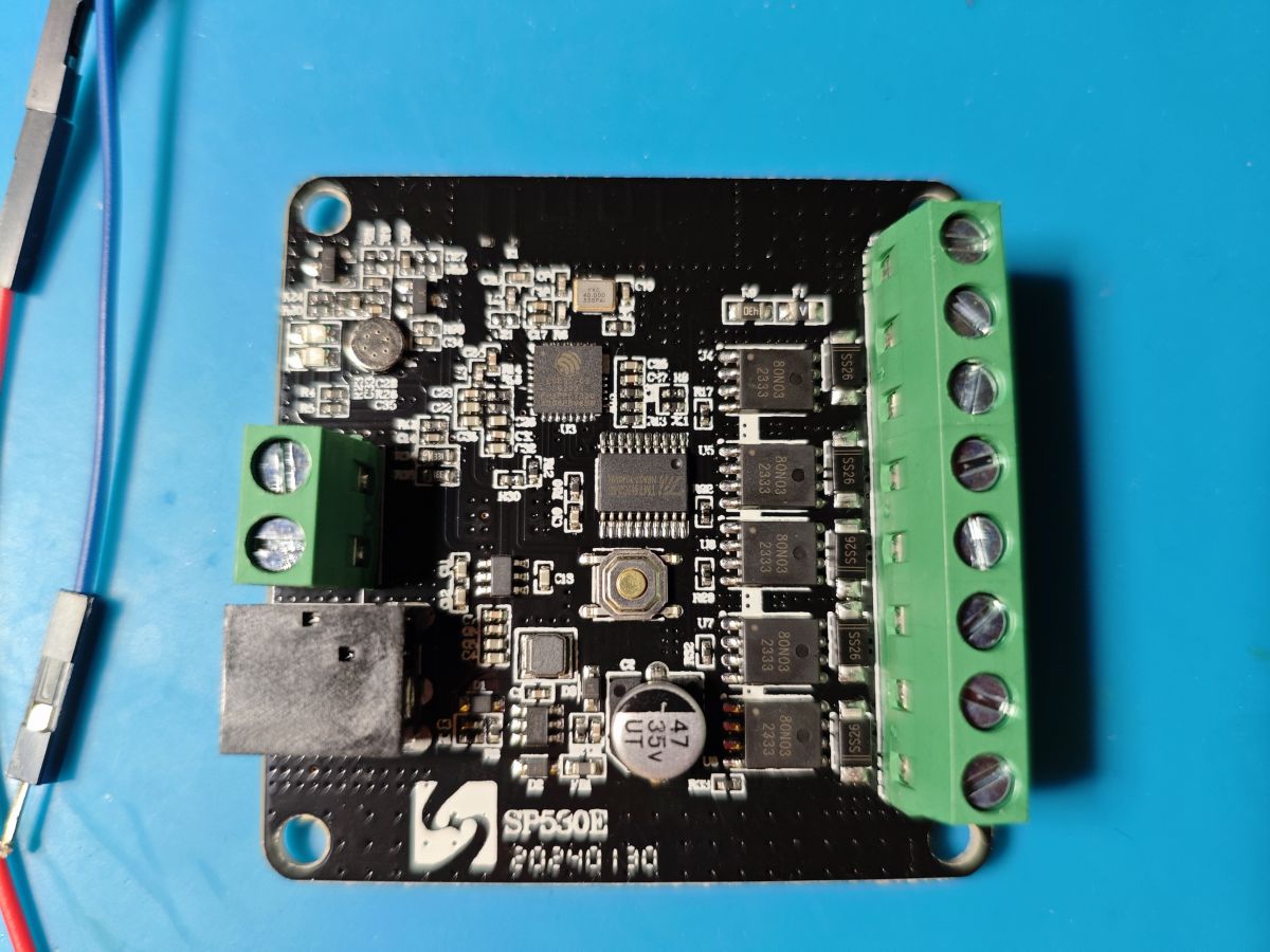

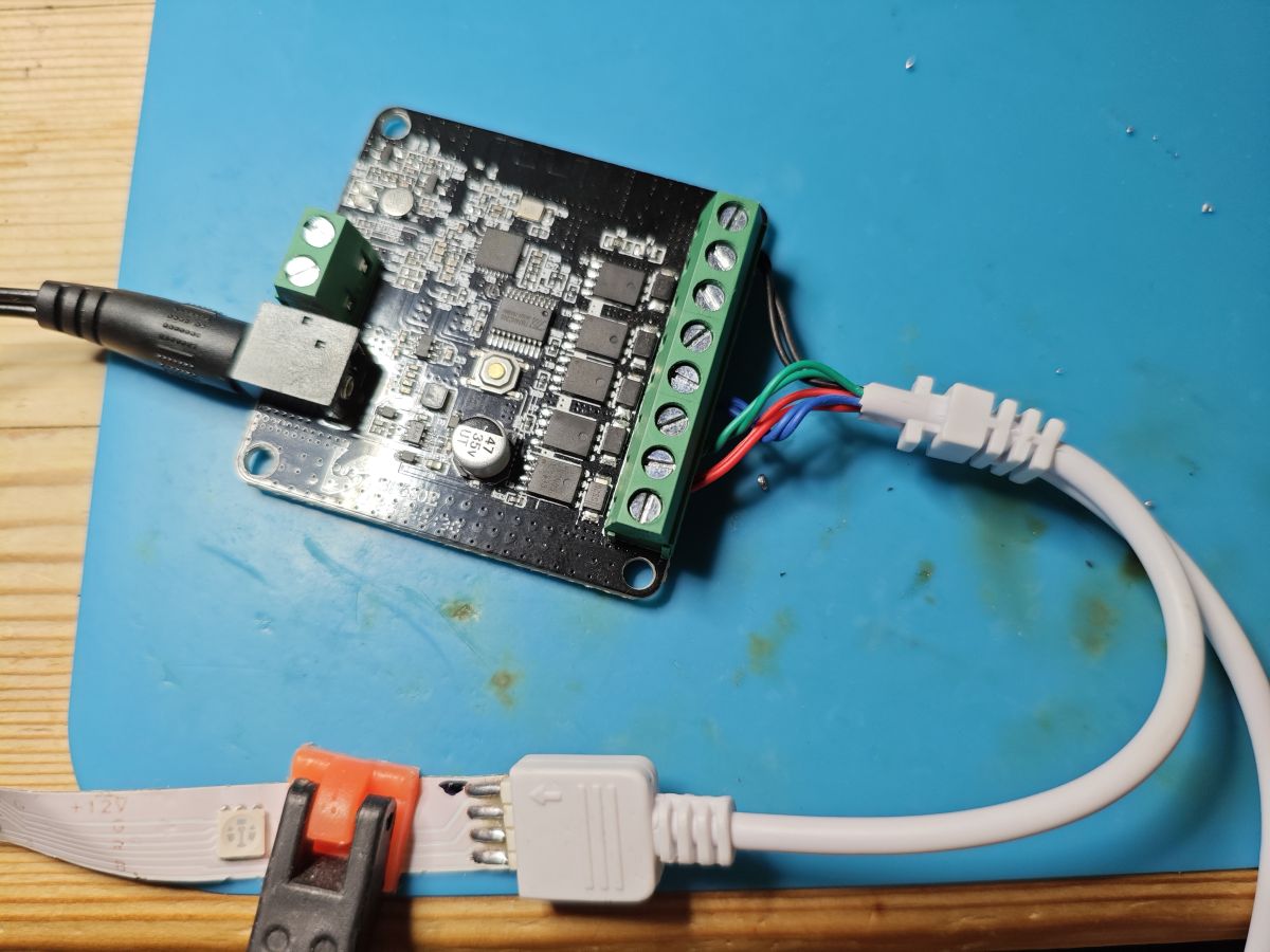

    Hi. So this is an SP530E 5CH PWM+SPI LED controller sold by BTF Lighting, and other generics, as model SP530E. I was going to play with WLED on it at some point, but now OpenESP is in development, that can be tested on it as well.
    Box of the SP530E series IoT LED controller. Side of a box with two QR codes labeled APP and Instructions. Box of SP530E LED controller with compatibility information. SP530E LED controller and user manual on a blue background. Bottom view of the SP530E LED controller board with visible pads and pin labels. SP530E LED controller with visible components on a printed circuit board. View of LED controller SP530E 5CH PWM+SPI on a blue background. LED controller SP530E with connected wires SP530E LED controller on a blue background with connected wires. SP530E LED controller with connected wires, top view
    The app QR is for the same BanlanX app seen in https://www.elektroda.com/rtvforum/topic4064640.html#21151364
    The device uses an ESP32-C3.

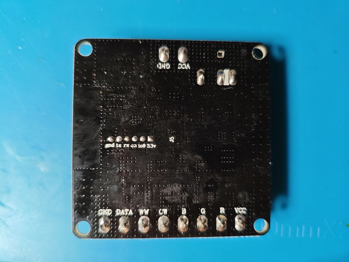

    With the pads on the back soldered up and IO9 pulled low esptool.exe commands can be run for some chip info:
    esptool.exe --port COM22 flash_id
    esptool.exe --port COM22 get_security_info
    After a bit of reading I turned off the security features with
    So the security info is now
    And I'm free to flash unencrypted binaries and they'll boot.

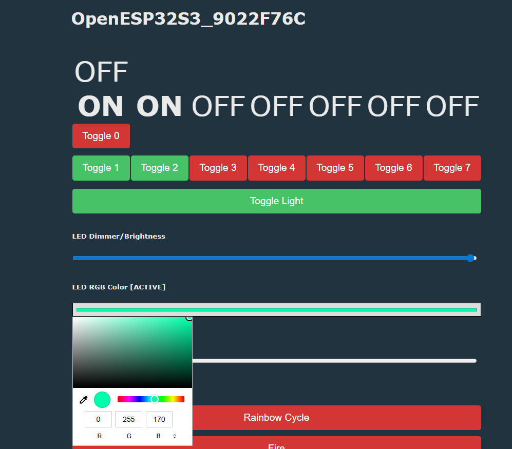

    Which means a bootable OpenESP32C3

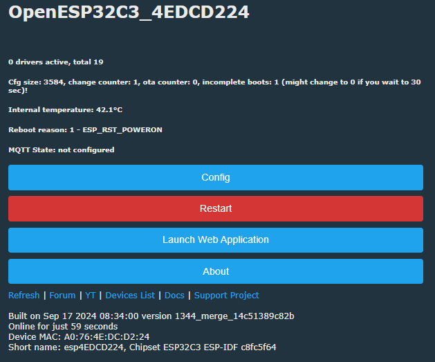

    Screenshot of OpenESP32C3 interface for ESP32-C3 device
    Most of what I've understood about this device is from the WLED Discord and mostly thanks to user triangulumsweetrolls.
    That last comment about pin 19 is because pins 12-19 are not usable on WLED. You need to build a custom firmware to disable USB_CDC. See https://github.com/zalatnaicsongor/wled-compiler
    and regarding the user's custom WLED build:

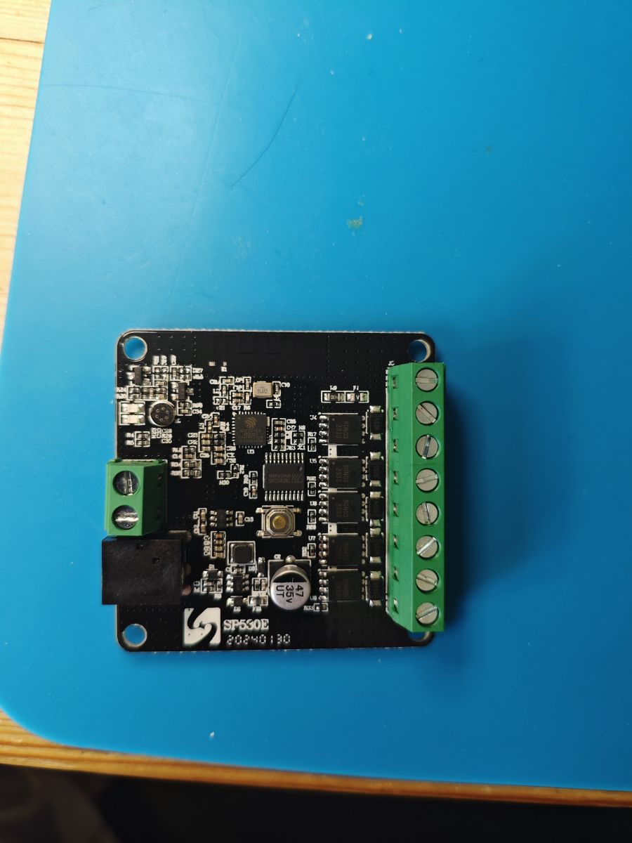

    Back to OpenESP. I've got the basic PCB LEDs on IO0/1 working of course, but no PWM led, at any frequency (assuming command 'pwm frequency xxxxx' is expected to work) and there's no OpenESP support yet for SPI.
    In the custom WLED binary I could only get dimly lit/barely working PWM LEDs but I did achieve working animations on 4m WS2812B strip using unlocked IO19.
    That's it really. It's not been the best device to test on.

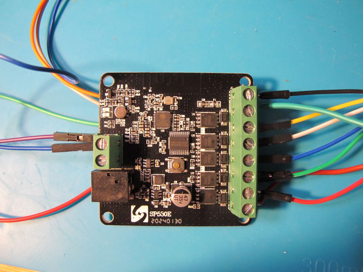

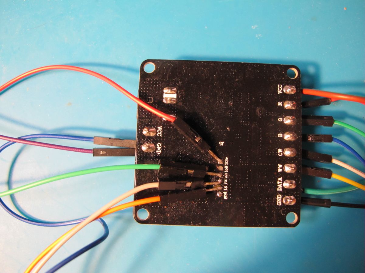

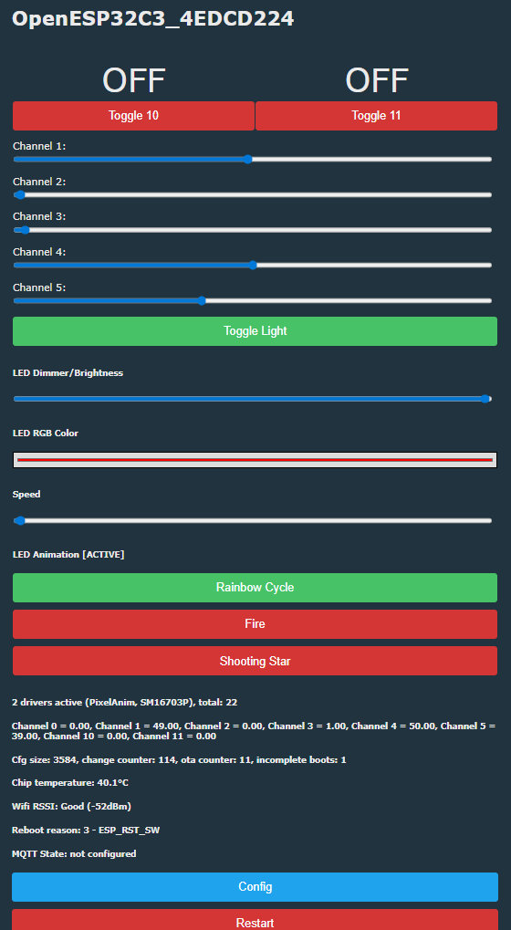

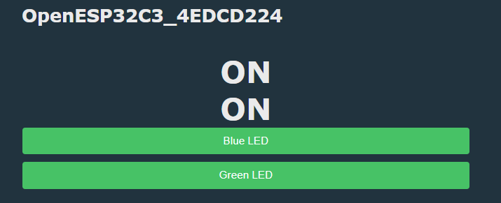

    Screenshot of a control panel interface with OpenESP32C3_4EDCD224 and buttons turned on for blue and green LEDs.
    Close-up of an electronic circuit board with visible components and a lit LED.

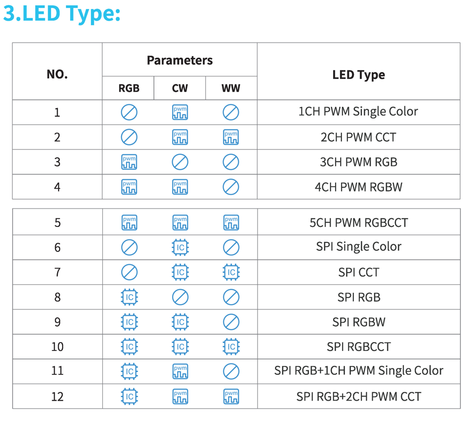

    all valid questions! I never got to try the official app with it in the end. And now that the security efuse bits are burnt again on mine, I'm guessing I can't flash back to test.
    I forgot to attach the manual.
    Table displaying different LED types with RGB, CW, and WW parameters.
    • Exploring SP530E 5CH PWM+SPI LED Controller with OpenESP on ESP32-C3 SP530E-Manual.jpg (5.68 MB) You must be logged in to download this attachment.
    • SP530E-Manual.pdf (5.54 MB) You must be logged in to download this attachment.
  • #5 21231424
    Posts: 5220
    Help: 449
    Rate: 918
    I don't think I see anything that says they can't be controlled independently.

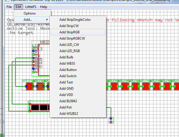

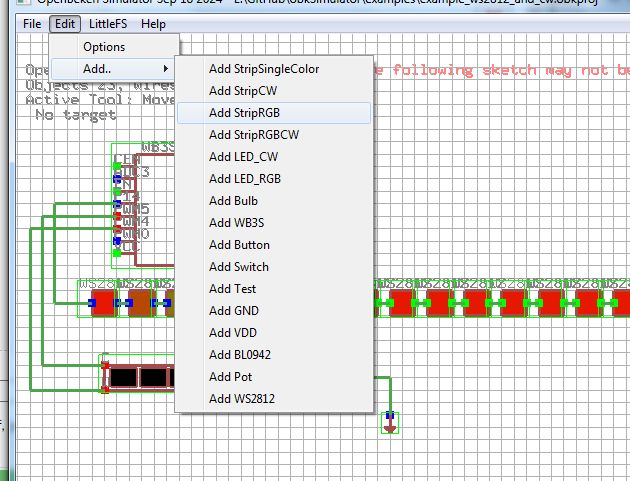

    #8 21231563
    Posts: 14771
    Rate: 12914
    Maybe I could try earlier in Simulator, depending on how big the demand is?
    Screenshot from OpenBeacon simulator showing a circuit on a grid.
    Screenshot of OpenDeck Simulator software showing a menu for adding electronic components.
    PS: I added a switch (bistable) and zoom features to Simulator yesterday.

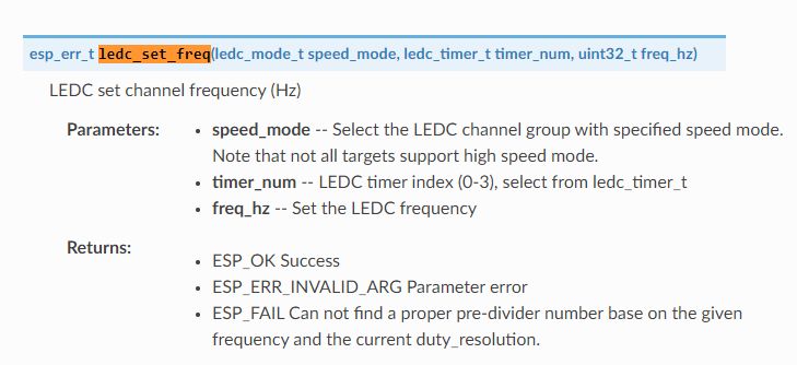

    re the reported 16khz factory PWM for this device specifically, is the command pwmfrequency ### expected to be effective on ESP at this stage?
    LEDC frequency setting still missing in OpenESP
    #10 21231588
    Posts: 14771
    Rate: 12914
    It seems that LEDC is used for PWM:
    https://docs.espressif.com/projects/esp-idf/e...ble/esp32/api-reference/peripherals/ledc.html
    And there is a function for that:
    ledc_set_freq
    but I can't see it used here:
    https://github.com/openshwprojects/OpenBK7231...c888c1f11e6e/src/hal/espidf/hal_pins_espidf.c
    So probably @insmod still has to add it?
    Added after 49 [seconds]:
    Screenshot of ledc_set_freq function documentation with a list of parameters and return values.
  • Bit depth hardcoded to 2 kHz on SP530E

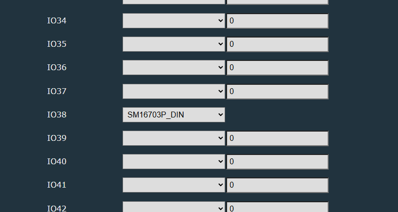

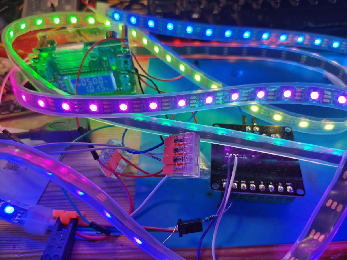

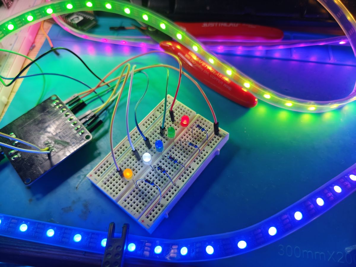

    OpenESP SPI LED support works on SP530E controller
    #16 21635132
    Posts: 5220
    Help: 449
    Rate: 918
    went back to this now there's SPI LED support in OpenESP
    wiped an October 2024 PR and re-flashed with the 4MB OpenESP32C3_1.18.154_4M.factory.bin
    P19 set as SM16703P_DIN
    autoexec
    100ohm on DAT line.
    Rainbow animation running happily on 5V 2M strip
    Colorful SPI LED strip connected to microcontroller with wires on a desk
    current basic template
    16/08 - updated

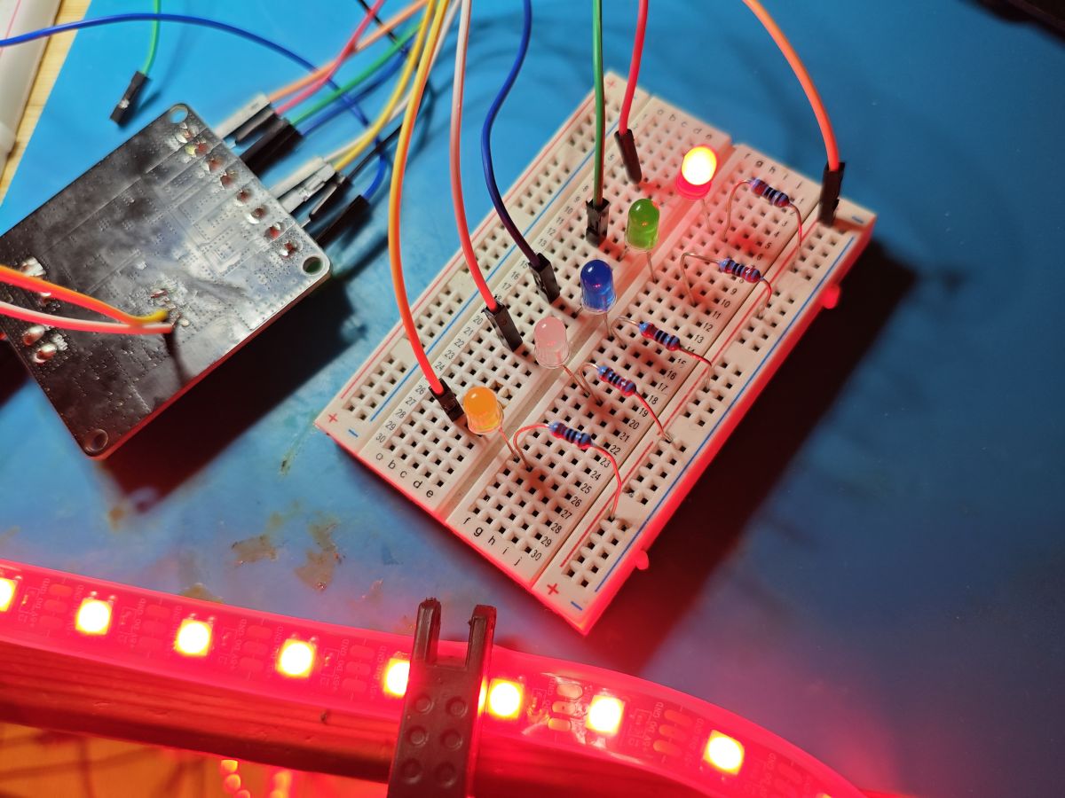

  • #18 21635231
    Posts: 5220
    Help: 449
    Rate: 918
    hmm. not even a glimmer on any channel. 16khz set in PR.
    12v dc in, 12v LED strip
    Electronic module with connected wires and 12V LED strip on blue mat
    going to try higher

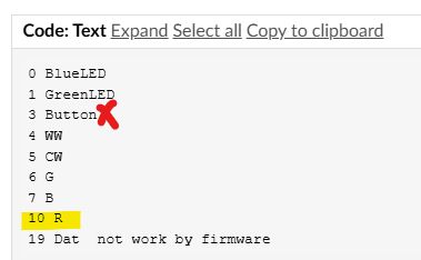

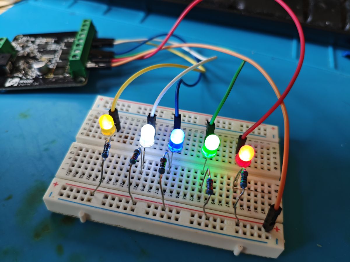

  • Ground-side switching and GPIO10 explain missing red channel
    #25 21636228
    Posts: 5220
    Help: 449
    Rate: 918
    OK OK. So I'd not realised the switching is on ground, not VCC 😬 despite eyeballing the V+ pin alongside RGB channels on a different LED strip controller just before
    RGBCW each measure 5V.
    With 1.27, 7BIT and 16khz GBCW all light up BUT red is odd. LED works, resistor works, cabling works but red channel is never seen. Maybe the 80N03 for this channel is dodgy (or the 74HC245D). I'll try other other builds maybe, but not sure why red would be different to the others. Because R is GPIO10 :)
    I guess this config would always mean a user custom build rather than being able to adjust these things in OBK GUI or CLI
    Five lit LEDs in different colors mounted on a breadboard with connecting wires

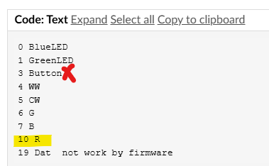

    Added after 1 [hours] 24 [minutes]:
    divadiow wrote:
    Because R is GPIO10
    ffs. was stated here. button was wrong though
    GPIO assignment list with GPIO 10 as R highlighted and GPIO 3 marked with red X

    insmod wrote:
    Do LEDs work at 1khz?
    omg ffs. after all that fiddling, yes
    but why other frequencies reportedly required in WLED posts. hmm
    Added after 45 [minutes]:
    other things to note with this device because there is only 1 colour picker:
    -With SPI and PWM pins assigned, turning on the WS2812B with "Toggle Light" will make the WS2812B white and the RGB PWM LEDs light up.
    -Choosing animation will start animation and turn off PWM LEDs
    -choosing solid colour in picker will light WS2812B and PWM LED to matching colour
    Breadboard with colored LEDs and jumper wires, WS2812B LED strip glowing red
    -Flag 3 enabled ([LED][Debug] Show raw PWM controller on WWW index instead of new LED RGB/CW/etc picker) allows you to run animations and choose PWM colours separately
    WS2812B LED strip connected to breadboard with RGB LEDs and wiring
    LED control interface in OpenESP32C3 system with active animation
    WS2812 setup works but clearConfig causes boot crash

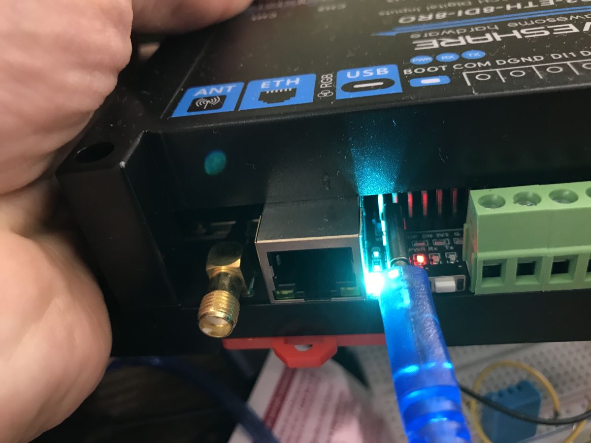

    ESP32-S3-ETH-8DI-8RO has single RGB WS2812 LED, let's try.
    Pin configuration for IO34–IO42 with SM16703P_DIN set on IO38
    startDriver TCA9554 41 42 0
    setChannelType 0 Toggle
    setChannelType 1 Toggle
    setChannelType 2 Toggle
    setChannelType 3 Toggle
    setChannelType 4 Toggle
    setChannelType 5 Toggle
    setChannelType 6 Toggle
    setChannelType 7 Toggle
    startDriver SM16703P
    SM16703P_Init 1GRB
    SM16703P_SetPixel 0 255 0 0
    SM16703P_Start
    startdriver pixelanim
    OpenESP32S3 web interface with toggle buttons and RGB LED color control
    Close-up of ESP32-S3-ETH-8DI-8RO ports with active blue LED and USB cable

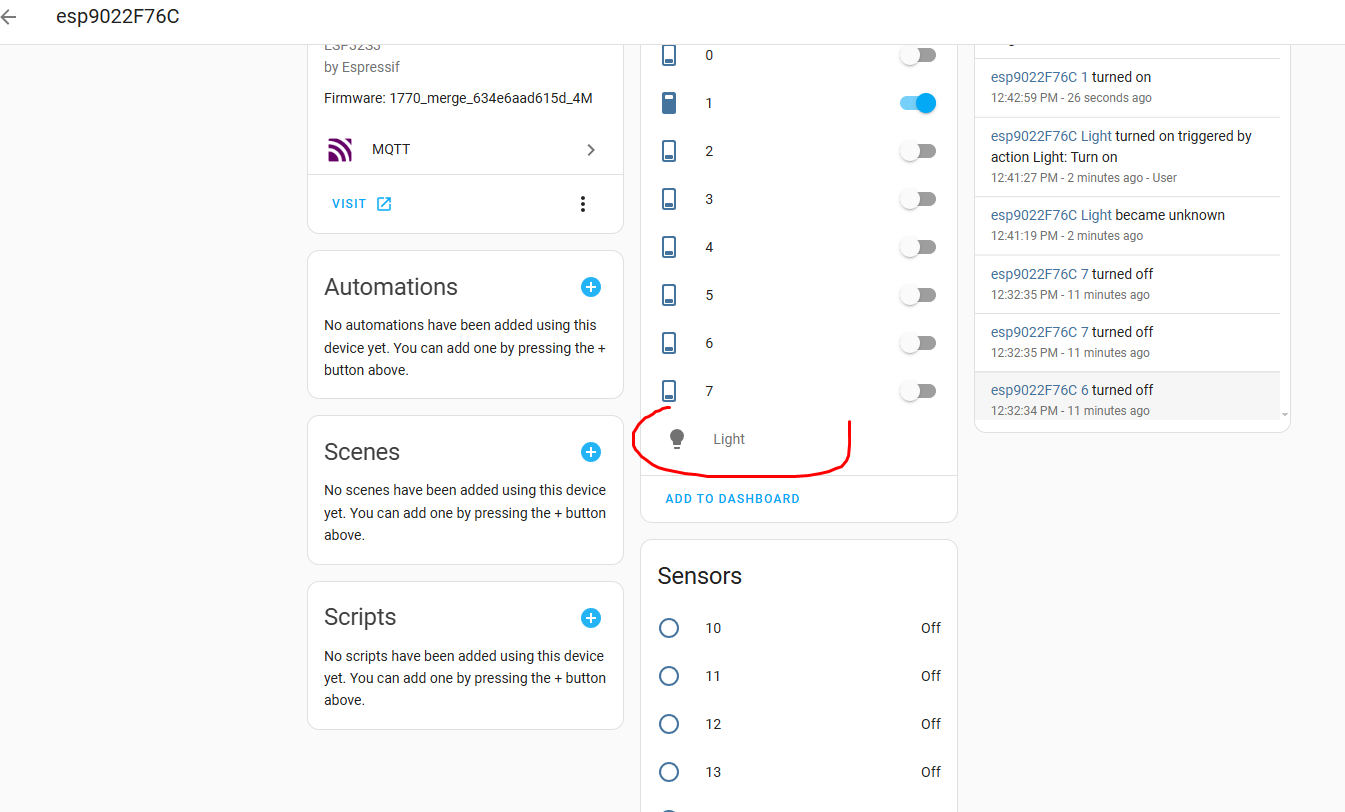

    Added after 7 [minutes]:
    Works from HA
    Home Assistant control panel showing esp9022F76C with Light feature enabled

On SP530E, the 74HC245D level‑shifts MCU outputs, and not all pins reach the driver. GPIO12–19 are restricted in stock WLED builds on C3. Use a custom build that disables USB_CDC, then drive data on GPIO19. The author saw digital animations work after unlocking IO19; without it, the data output idled high. [Elektroda, divadiow, post #21230102]
What GPIO mapping works for PWM and on‑board parts?
Observed map: 0 BlueLED, 1 GreenLED, 3 Button, 4 WW, 5 CW, 6 G, 7 B, 10 R, 19 Data (WS2812). UART is GPIO20/21 (RX/TX). GPIO0/1 also drive board LEDs. The MCU connects to 74HC245D for PWM channels through gate resistors to MOSFETs. [Elektroda, divadiow, post #21230102]
