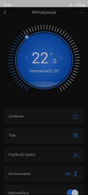

    Unable to pair phone (android 4.4.4) with AUX Halo air conditioning.
  • #2 18859534
    Wiewior81
    Posts: 18
    I don't know if you've already figured it out - I had a similar problem, I'll tell you a few steps that allowed me to add the device by trial and error.
    1. Reset the WiFi module according to the manufacturer's instructions.
    2. Grab your cell phone, put it on search for networks and get as close to the air conditioner indoor unit as possible until you see a new WiFi network with a strange name. I had to bring the phone closer to a distance of literally a few centimeters.
    3. Now try to connect your device to WiFi via the app.
    If it doesn't go:
    4. On another smartphone, make a WiFi router by giving it the same network name (SSID) and password as you have in your home WiFi.
    5. Repeat steps 1-3, but putting this phone with the WiFi router turned on right next to the air conditioner (several cm).
    6. You should be able to connect the device to WiFi shared from your mobile.
    7. As soon as you see the device in the application, turn off the WiFi network shared from the mobile
    8. The device should successfully connect to your home network.
    Let me know if it worked.

  • 2.4 GHz hotspot from Galaxy S21 worked
    #18 19976531
    mkumela
    mkumela wrote:
    Dear,
    I have installed the AUX-09JO device and I do not want to connect to wi-fi. I’ve tried everything from the above posts...
    Help!!!
    Thanks and best regards,
    MK
    I was finally able to add devices. I put out a 2.4GHz network from a Galaxy S21 and it worked from an app installed on some old oppo. I noticed that when adding devices on samsung there was a message in which the SSID of the network was enclosed in two double quotes - ""network_name"". On oppo, the name of the network was between single characters ... And the strangest thing was that it did not connect to the network displayed with the Galaxy S10 ... After adding devices, everything works very well. I lost a bit of nerves with this... Thanks!

  • WPA/WPA2 2.4 GHz settings enabled pairing
    #21 20005242
    otomasz87
    Hello, A year ago I was struggling just like everyone here....
    I tried to connect with the samsung S10e phone through the router at home to no avail, I set up the same network on the other phone and after hard attempts I succeeded.
    Today I tried to start the app and it logged me out and I couldn't log back in. The fun started from the beginning...
    - the option from that year did not bring any effect.
    I did this:
    - in the router on the 2.4G network to which the phones were connected, I set WPA / WPA2 Personal, operating modes n (I do not know if it contributed to the connection of the device)
    - I connected the phones to the same 2.4G network (older and newer phone)
    - I reset the Wi-Fi in the air conditioner by pressing HEALTH 8 times and after a few seconds on the Xcover4 phone (older phone) I gave connect or send the password to the unit (he found the unit without a problem and connected)
    - I logged in to the S10e and the air conditioner added :)
    To sum up, I was unable to connect on the Samsung S10e phone (newer generation wifi only on Samsung Xcover 4 old dead :)

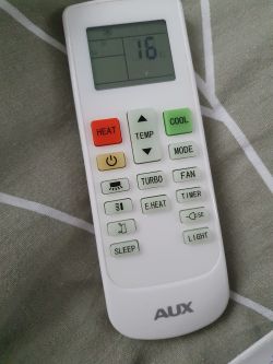

    Does anyone remember how to reset wifi with this remote?
    The cool and + or - key combination does not work. I don't have a health button. Help!
    AUX air conditioner remote on a gray background set to 16 degrees Celsius.
