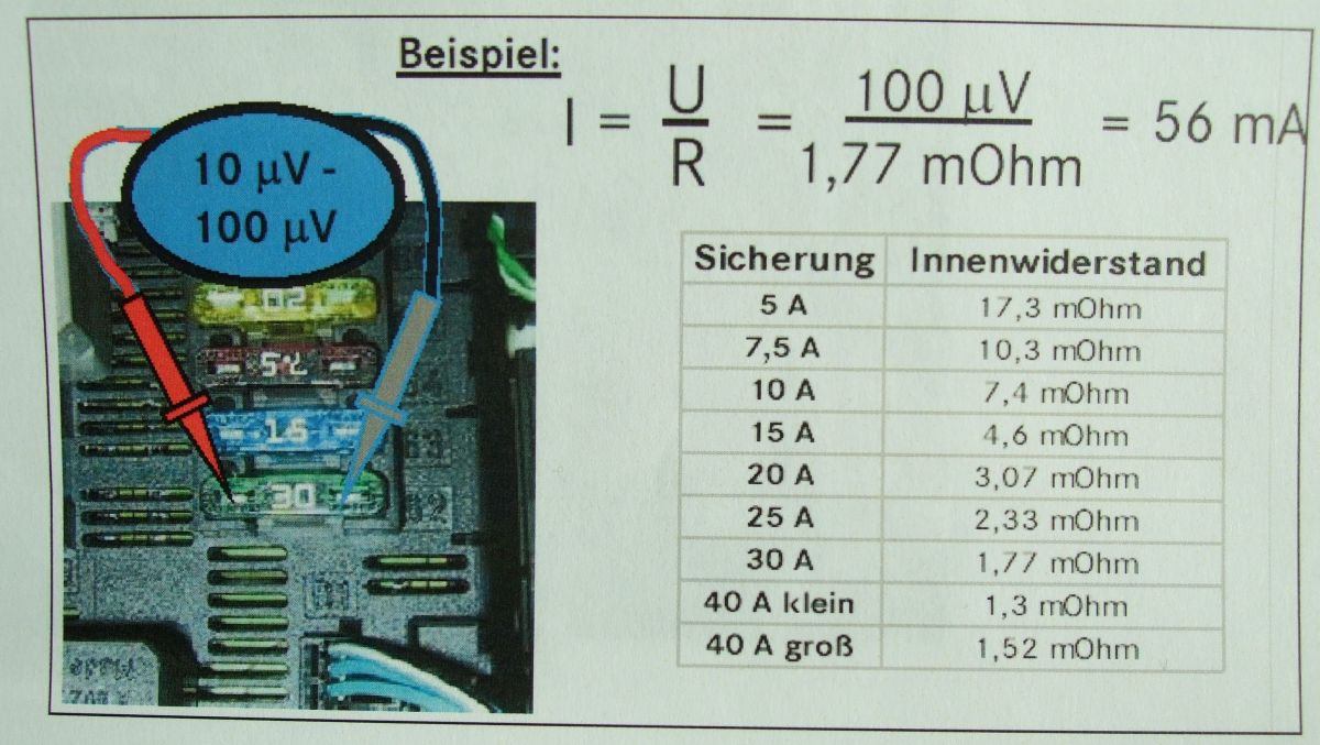

  • Measure fuse current by voltage drop
    #43 19468932
    Gerri
    Mercedes specialist
    Posts: 5699
    Help: 865
    Rate: 3629
    ociz wrote:
    In addition, you should rather avoid removing fuses to check them, the customer can make a fuss even for the fact that the radio settings have been deleted, and you can also do more "damage" in some cars.
    Here, perhaps more as a curiosity, I present a table developed by engineers from Mercedes. It is mainly related to the problem of checking the quiescent current in cars with a CAN network. Each time a fuse is removed in order to fit an ammeter in its place, it leads to several minutes (sometimes) waiting for the system to go into "sleep" mode. The new method is to measure the voltage drop across suspect fuses. Having such a table and the value of the fuse, it is possible to approximately determine the current flowing through it at a given moment.
    How to check a car fuse

  • #44 19472712
    skywalker2
    Posts: 110
    Rate: 58
    A very good way described by engineers from Mercedes. You only need a fairly good quality meter, of course, with equally good cables.

    skywalker2 wrote:
    you need a fairly good quality gauge
    It cannot be considered a scaled measuring tool. So what if the meter will be accurate if fuses from different manufacturers may have discrepancy in resistance. But the measurement will certainly show us the "branch" of the installation in which something is happening without the troublesome removal of fuses and putting the system to sleep each time. Even an estimate of the flowing current will be helpful in the diagnosis. I admit that I have used this method several times and it is really helpful.
